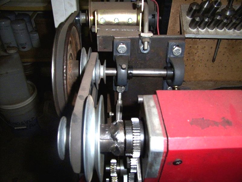

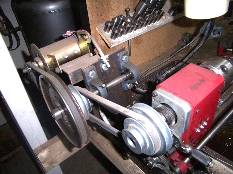

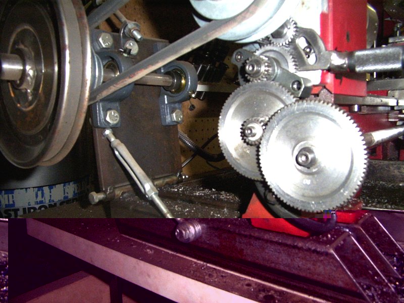

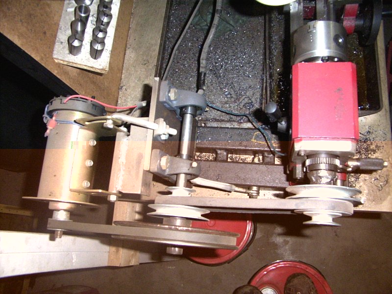

I can see how changing the pulleys to increase the torque will break the plasitic gears more easily ,
a mod i've thought about doing , but not done yet
PS   look here at one version of what you are thinking about :-    http://tool20895.homestead.com/treadmill.html

Sounds like a plan, Rich, but you will only have 4 speeds with two 4-step pulleys unless you can arrange for one pulley to slide along its shaft into a position where (for example) the belt can run from one 5" pulley to the other 5" pulley, and a tensioner which can take up a lot of slack (when running from one 2" to the other 2").  If you could perhaps remount the motor so you could move it closer to or further from the spindle to take up the slack, you would get 12 ratios (2" to 2", 3" to 3", 4" to 4" and 5" to 5" all being effectively 1:1, so you wouldn't actually need 5" to 5").
Without the gears in the headstock changing the direction of rotation, the spindle will run in reverse when the switch says forward and vice versa. Some of these little DC permanent magnet motors only run at half speed in reverse (which with your pulleys would have the spindle going forwards) so it might be beneficial to transpose the wires to the motor.

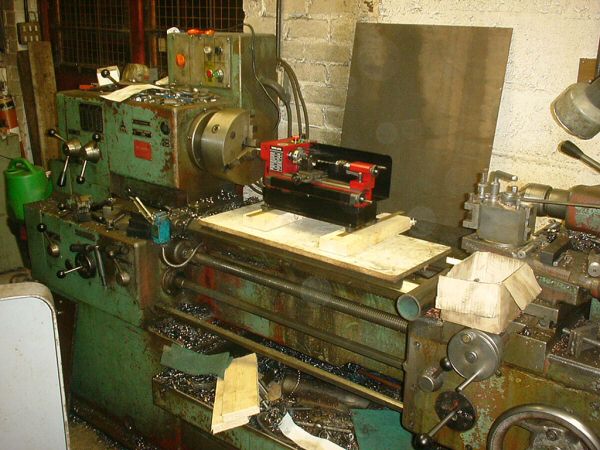

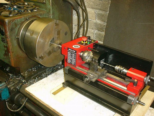

I have been reading many posts over the last few years about the Mini Lathe, and have come to the conclusion that many people think that because it is a 7" lathe, it will turn a 7" billet perfectly OK, and so they overload them, major problems occur, then they start to think about beefing them up even more, and even bigger problems raise their ugly heads.
I did some major work on a mini lathe, and I will tell you now, even though it had taper bearings and steel gears, for the spindle diameter (the critical part), I wouldn't use it for anything more than say 3" diameter, and even then, would be very careful on depth of cuts, purely because the lathe wasn't designed to take it.
If the gears break, then it is a sure sign that you have overloaded it to beyond the designed tolerances. People seem to think they are better than the original machine designers by fitting stronger third party parts. There is a reason for nylon gears, as a safety valve to prevent further damage.
I'm not saying you can't machine a 7" part at all, as long as the bit you are trying to machine on it isn't any larger than say 3".
When will people start to realise, if you want to start machining larger pieces, then you need to go for a larger lathe. It is just false economy to try to beef one up that isn't designed to do the job in the first place, all you will end up doing is struggling, causing yourself heartache and emptying your pockets of cash.
Small machine, small bits, large machine, large bits (and small bits), no arguments on that score, it has been that way since the beginning. I'm very sorry if you can't afford a larger lathe, but that is a fact of modern day life, if you can't afford to buy something larger, then you will have to stick to making smaller things.
DO NOT OVERLOAD SMALL MACHINES

I fully agree not to overload the original drives or motor and controls.
However if you do need the *extra* bit of power and drive for the odd job there are ways round this.
This setup allows me to use the whole of the 7.5 Hp from the big TOS lathe onto the C0 without any fear of blowing a driver board.  :poke:  :lol:

Laughed my socks off - your lucky to have such a large lathe to work with. A lot of people, myself included, simply don't have the room or finance for such a luxury. But that's when the creativity (hopefully) kicks in.

Here's some pics...
The piece that screws on to the spindle is actually three pieces. The 3-step pulley, a piece of round tube/pipe, left-hand thread nut.
I had to make a replica of the spindle thread first using one of the original nuts as a go/no-go gauge. (Before removing the gauge from the chuck, I marked where jaw #1 was...see why later.) Once I had the piece threaded, I made the nut and threaded it, using the go/no-go gauge as I cut the thread. I milled some slots in the nut to provide a means of tightening. (Similar to the original nuts actually.) This nut was then welded to a piece of thick-wall tubing. The go/no-go gauge was chucked back up thanks to my marks made before and the nut/welded tube was screwed on. A couple light facing and turning cuts to square things up. The center was then bored out to about 1" if I remember correctly. The nut was removed from the go/no-go gauge and the gauge removed from the chuck. A hole for a set screw was drilled and tapped in the side. Now the pulley was chucked up. In the end of the large pulley, it is recessed. (Cheap buggers couldn't leave THAT much aluminum behind!!!) The center was a hair over 1". I turned it down slightly until the welded nut slid on about 1/8". I then took the pulley & welded nut over to my horizontal press (big vise!) and slowly pressed the two together with some red loctite. The set screw was also added for extra holding power.
Nothing special about the frame work holding the jackshaft. Some 2" x 1/8" wall tubing extended back from under the base. (I had made two lift blocks out of this tubing earlier to raise the lathe up off the bench, so this frame work simply replaced the headstock lift block.) The jackshaft bearings are mounted on some 6" x 3/8" plate, hinged at the bottom. A simple tensioner keeps the belt tight.
The motor hangs off the top rear of the jackshaft plate. Another simple tightening bolt here too.
The numbers, as mentioned earlier....the pulleys provide 1:5 from motor to jackshaft, then 1:2, 1:1, 2:1 to the spindle. The motor is 1.5 HP continuous duty @ 95 VDC, 2.5 HP treadmill duty @ 130 VDC, 18.5 Amps 6750 RPM. This gives the motor a range of 0-6750 RPM, the jackshaft is 0-1350 RPM, and the spindle is 0-675 RPM, 0-1350 RPM, 0-2700 RPM. The motor is run with a obsolete industrial control I found on EBay...much better than the original motor and controller!!!!
Andrew

That's a beast  :bugeye: 2.5hp?
You'll have to be careful not to snap the bed in half!
I don't think mine will be quite so industrial.
How did you find it cuts now with the new setup? Have you done much low speed parting?
Well, that's 2.5 "Chinese Treadmill" HP...I don't think it's anywhere near that when converted to "normal" HP!  :clap:
Cuts like a dream. Parting, threading, etc....no problem.
Unfortunately, I don't use it too much as my big 20" x 48" sits beside it. (7.5HP, Canadian made, WWII vintage.)  :D :)
Often small parts still get made/fixed on the little 7x12 though. It's just so handy to get right up close to those small parts when they are being worked on. That's why I'm thinking of fixing her up a bit.
