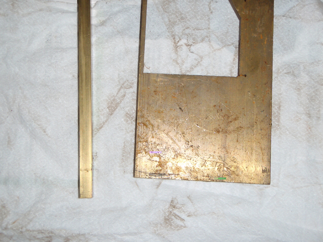

I have mixed feelings about the arm materials:
1) I have 10*10mm brass rod, but that is probably way too small, unless I made 4 mm slot for M4 retaining screws....
2) Second choice is mystery bronze/brass, probably I could make 8*15 mm arms, where I could use M5 retaining screws...
Any toughts? Should I just put some OD25 mm tempering steel rod on the lathe chuck and spin it 750 rpm and advance a piece of both materials on the lathe tool holder towards rotating piece and see which fails first?

I'd say some sort of brass would be good for the arms as you call them. I do suggest you take a good long look at incorporating ball bearings though.
Have a look here to see what i mean: http://littlemachineshop.com/products/product_view.php?ProductID=2419&category=1
Actually, thinking it through, most arms are probably bronze of some sort...
Henning

Pekka, perhaps you could use steel arms with brass tips brazed/silver soldered on the ends.
TAKE II: Maybe I should give it a try?

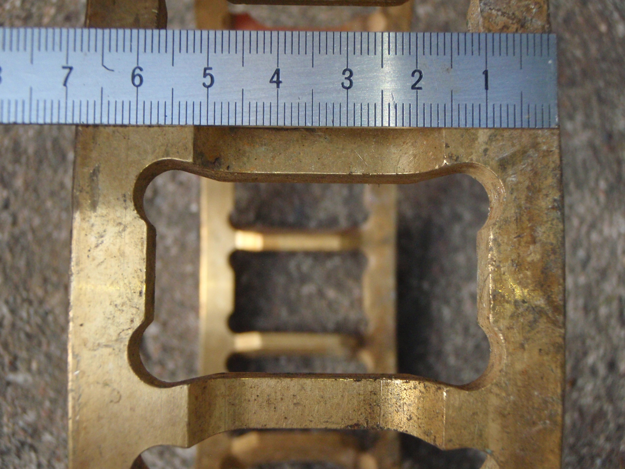

I found out of treasure pile one roller bearing eh? retainer? 23 cm. diar ring that seemed to have right kind of bronze.
I have silver soldered copper pipe with bronze lookking brazing rods and a mysteryflux I got from shop. I have a sievert LPG torch.
Would this kit work?
But I don't have a foggies idea and after searching this site I'm even more confused? I can find stuf like this:
http://www.lucasmilhaupt.com/en-US/brazingfundamentals/
It's great, but very long way to my spesific need: Bronze on steel key stock with siervert torch.
Torch: I have a standard sievert and Rothenberger ROFIRE
http://www.rothenberger.com/en/products/product-groups/soldering-and-welding-equipment/soft-soldering-unit-rofire.html
I have 11 kg LPG gas for Sievert and Multigas 300 Propan / Butan for Rothenberger, but I can get MAPP or Maxigas 400
1) I understand cleaning and fitting the parts together...Do I need to picle the parts? If I do how and what?
2) Do I need a special solder and flux? I have some mystery stuff I have bought 20 - 11 years ago. See picture. This sort of stuf I can get from any plumming shop. I can get also Rothenberger brand fluxes and brazing rods from local Bauhaus, but most of the British brands I see advertised on magazines are not available here. Im I lookking for a silver solder and flux for that temperature or is it more complicated?
http://www.rothenberger.com.au/upload/rothen_rothenberger/promotion/161/public_document/Watermark%20Certificate.pdf
3) How to fix? Mill the slots, clean, piece of solder between the joints, bronze part up up and heated, fluxing, slow cooling?
Do I have a good chance for success this way or should I just trundle away with smallish arms (cut from 8mm thick bronze?)
I know I'm asking a lot, but I know so litle about brazing, I need close to blow-by-blow intructable with this equipment, materials and aplication, othervise I even can't learn from my mistakes.

Silver soldering is easy!
Just clean your parts with a file, no need for any chemical treatments.  If your flux is a powder then mix a little into a paste with water, apply flux to the parts, not too much but make sure the surface is covered with paste where you want the solder to be but avoid putting flux where you do not want the solder.
Place the pieces in position in a little hearth that you make with fire proof bricks. It is important that the heat is all around the work and a little hearth does that. Snip off some pieces of the solder and lay them along the joins.
Heat the work, heat both pieces trying not to play the flame over the solder, in fact it is best to heat from the other side if possible.  If you have a big piece it is best to start heating it away from the join so that when you heat the join not so much heat will flow away.  When the metal is hot enough the solder will melt and flow into the join by osmosis so the joints should be close fitting but they do not need to the clamped or anything like that.
If you think there is not enough solder to fill the join you can add more, do this by dipping the end of the solder stick into your flux paste and melting the end over the join.  This is OK but you will have a much neater job if you can avoid adding solder in this way.
Once the solder flows into the joint stop heating then let it cool naturally in the hearth.

The rods in the long tube look mechanically stronger (50 daN / mm2) than those on the left (38 daN) but it looks like those on the left don't need as much heat.
I'm not sure about the flux in the blue container, because there is no temperature range showing, but the flux in the white container looks like it might be OK.
But if the Rothenberger rods and fluxes are made to match one another, it might be better to rely on those.
As to actually doing it, there are folk on here much more experienced than me, and you would be better taking advice from them. As a novice, I have done some silver soldering (brass to brass and steel to steel), and it all turned out OK. Some was even done with a small butane/propane torch like the one shown on the blue container, which didn't really deliver enough heat, and which took far too long though it did work in the end.

A lot of my brazing stuf is a "souvenir". The rods on the picture are from Paris, went there for a few days with my newly wed wife. Had to find a hardwarestore and found those. White flux was sold to me to braze copper pipes with phosphoros bronze and it is liquid. Paste is probably from Holland, that is even oder...I don't remember seeing temperature rating.
OK, I think I have eneough to give it a try. Just few more questions:
* Do I fabricate the parts ready before brazing or do I just cut arms (shoes) and tips to rough size and finnish after soldering? I'm most likely using a key stock, brazind does very little to properties.
* Does part relative position matter? Using a heart (I have some firebricks and an "insulator" palte) I think I could prepare tha parts as instructed before, stand them up (bronze tips up) with some mild steel wire and heat them up as a lot. Although this probably would heat the tips easier than the arms. If I put the smal tips down, arms are easier to heat, but tips will be touching insulator....
Thank you very much,

First thing first: Thank you fellas, I tried silver soldering and I'm pretty sure I had an success. Remote controlled brazing - wring commands :clap:
First picture: Parts before cleaning. Dish soap, hot watter, steam blast from espressomachine - well I had to make one latte! Then filing, brake cleaner (not the one with war quality chemicals) and some 1/2 hrs od drying out.g
Second picture is about torches. I used the Sievert and the burner that is connected to it. Took only less than 10 secs to bring whole lot to a dull red.
Third is heart. There is small cap back/up to allow good circulation. I had flux prepared on arms and placed there snips of silver solder.
Fourth is about brazed parts. I used M8 nuts and M3 screw and washers to hold parts evenly. I was not sure when solder melted...first flux pubbled and then solder flashed, I held heat a little longer and pressed the brass bar down. Could have used just tad more solder on one joint.
Fifth, sawn off and evened out on the mill. I wonder if there is any good way of cleaning the residue? I used brass wire brush.

get some citric acid powder form your health food store or home brewing store
mix about two tea spoons to  500mm of water  dunk them in for a couple of hours that should do it
don't worry its very safe its only lemon juice you can put your finger in no trouble ( unless you have a cut then it stings )

Thanks. I'll try it right away. I always have some!

 :thumbup: :thumbup: Finns can silver solder!
Slotting the ends of the steel arms, standing them on end, laying the bronze across the slots and doing all three at once like that was a great idea, Pekka  :clap: :clap:
I'm glad it went so well. I'm sure you will have enough solder in the third one, but just to be sure you could fit it at the bottom of the finished rest. In use on the lathe, the job being turned will tend to flex upwards and to the back of the lathe, so the bottom arm won't be under much pressure.
Lemon juice contains about 48 grammes of citric acid per litre, which is about as strong as Stuart's mixture, so if you can't find citric acid you could always use that. But I think alcohol prices in Finland are high, so I expect there will be plenty of home brewing and wine making shops  :beer:
