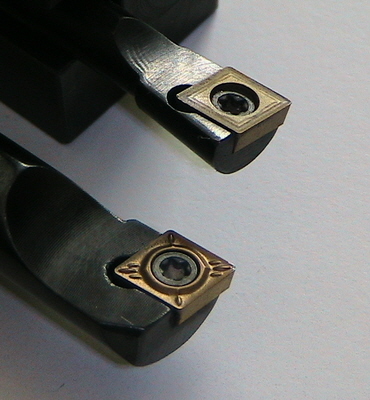

I thought I was making progress again today-
Got the new bar so I could get going on the bore.
I know theres a lot hanging out the tool-post but all went well. No chatter and tested a spring cut when nearly to size and it only took .03mm off the diameter, not bad I thought.
Then I took the final cut. I'd left .18 mm from the final dimension of 25.40. That was supposed to be .1 cut + .03 spring + leave .05 under for Lapping/Honing. then I saw the finish after just the cut. :(
I measured and it was to size !!!! nothing left to take off :scratch:
Picture shown after a light rub with emery paper so looks actually loads worse than it is but still very dissapointing.
The new tool has a slightly different looking tip to my old one. New on the bottom-
If you look closely at the bottom one on the pic you can see where the coating has chipped off, this happened after the first cut as though it were just paint, the tip beneath looked, and still looks fine. I realise these generic tips are not probably the correct grade for cast, or being used anywhere near the right speed & feed, but I'm sure the old ones worked much better when I did the castings for my 10V.
Ho hum, maybe better luck tommorow.
Steve.

lordedmond
Re: Webster-S Build
« Reply #7 on: May 27, 2011, 01:13:20 PM »
that tip look chipped to me
a pic with it facing would tell
Stuart

Hi Stuart,
Yes it looks chipped, I'm trying to get a better close up picture but both my cameras aren't quite up to it.
I think I need to make an adaptor to hold an additional lens in front for real close close-ups  :proj:
I looked under a microscope and it really does just look like the paint! :scratch: has come off, this was after the first cut and it looks exactly the same now after boring from 13-25.4mm with no wear or chipping of the edge beneath.
Must try it on some steel to confirm condition.
I've lapped the bore some and I think I was worrying unduly as its come up ok after adding just .05mm to the diameter.
So I'll get on with the rest and see how it goes.

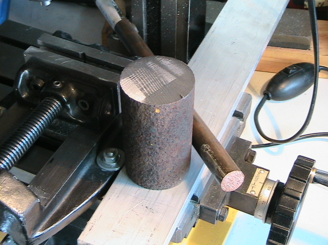

I've started on the head block now using a large block of ally that I bought a few years ago, not sure why :loco:
Hacksawed a chunk off the end and prepared to mill square but had a bit of a mishap.
I decide to check all the alignment of my mill first.
It was a bit out so shimmed the column mount a bit more (Already did it fairly close when I first bought it.)
Things looked fine but a final tighten and the thread for one of the bolts in the cast base stripped
The bolts are really not long enough, M8 with only five threads in the cast, so had to drill and tap the base deeper for a long stud, others are temporarily still using the old bolts without the thick washers supplied as I only had one M8 nut.
So on to the work-
My little X0 coped amazingly well, taking it steady with just 0.5mm cuts at about 400 rpm.
I had to take off about 9mm ! Wish I had room & finances for a power saw.

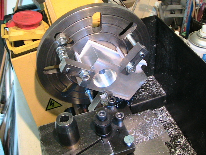

I was held up a bit as the head block wasn't going to fit in my 4 jaw so I had to make some clamps to hold it on the face plate -
They'll come in useful for other stuff too though.
It was a bit scary having this lot spinning round but with the nuts on one clamp bolt and a big 'T' nut bolted behind it balanced quite well, only spun it at about 400 rpm but it still bored out ok :D
Cheers for looking,

Steve,
I bet it was  :bugeye:
