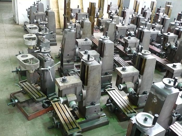

There is also another one that axminster is selling.  This one is different in that the whole column and spindle moves for the Y axis and the table only moves in the X.  It gets rid of the tilting problem, but looks like it causes an even weaker link on the dovetails.   Check out the parts diagram in the manual.  http://www.axminster.co.uk/downloads/600858_manual.pdf

That model was commissioned by JET in the US before being released to other sellers.
It's not a new model at all and has been kicking about in the background for quite a while.
Here's a stack of them from when I was over in China in 09
Not a good design as the slightest play acts on the column like a pendulum. Also not an easy machine to operate in the Z with the handle so high up and at the back. The Chinese factories will build whatever you want but sometimes they are given ideas that look good on paper but haven't really been thought out.

ok, now for the fun question, so if I could get that column would there be anything other than building an adapter plate to attach it to an X2 base? would it help with the flex in the X2?  Mad Modders want to know.
It did not work out well in our experiment, as well as in the factories experiment. LMS may have a solution for the original X2 owners in a few months time.
