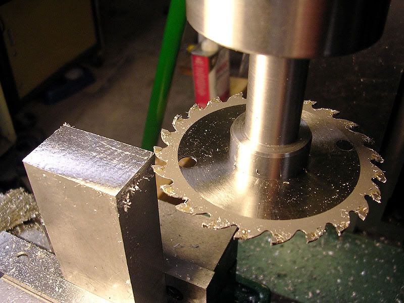

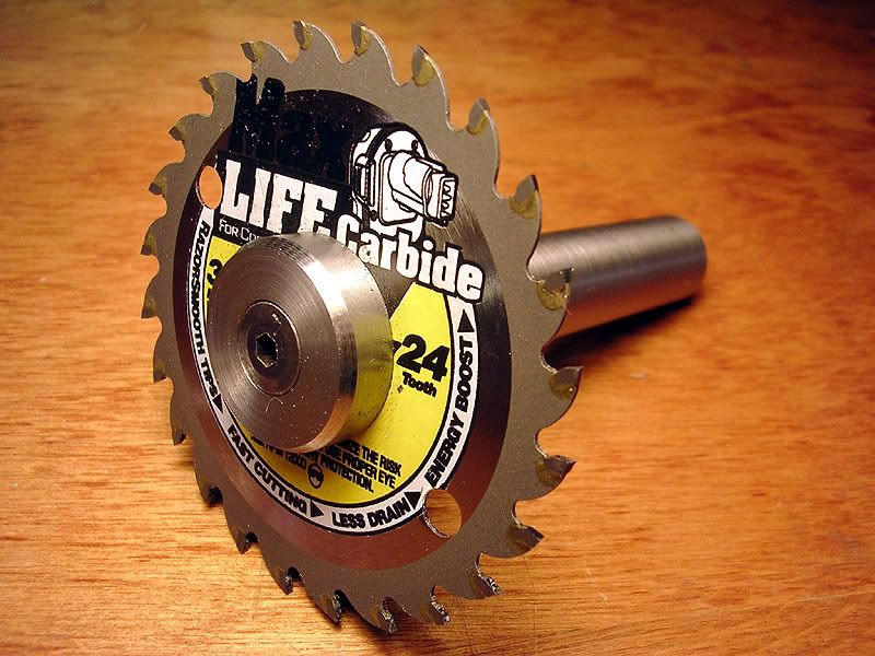

Offline DICKEYBIRD
  • Posts: 229
  • Collierville, TN ya'll
Re: Slitting saws
« Reply #8 on: May 07, 2011, 09:47:35 AM »
Hey Chuck, these are about as cheap & cheerful as one can find and they work great!  I got mine from my local Home Cheepo for a cordless trim saw.  It cuts aluminum and mild steel really nice.  The 3/4" straight shank arbor was made from scraps.
Milton in Tennesee
