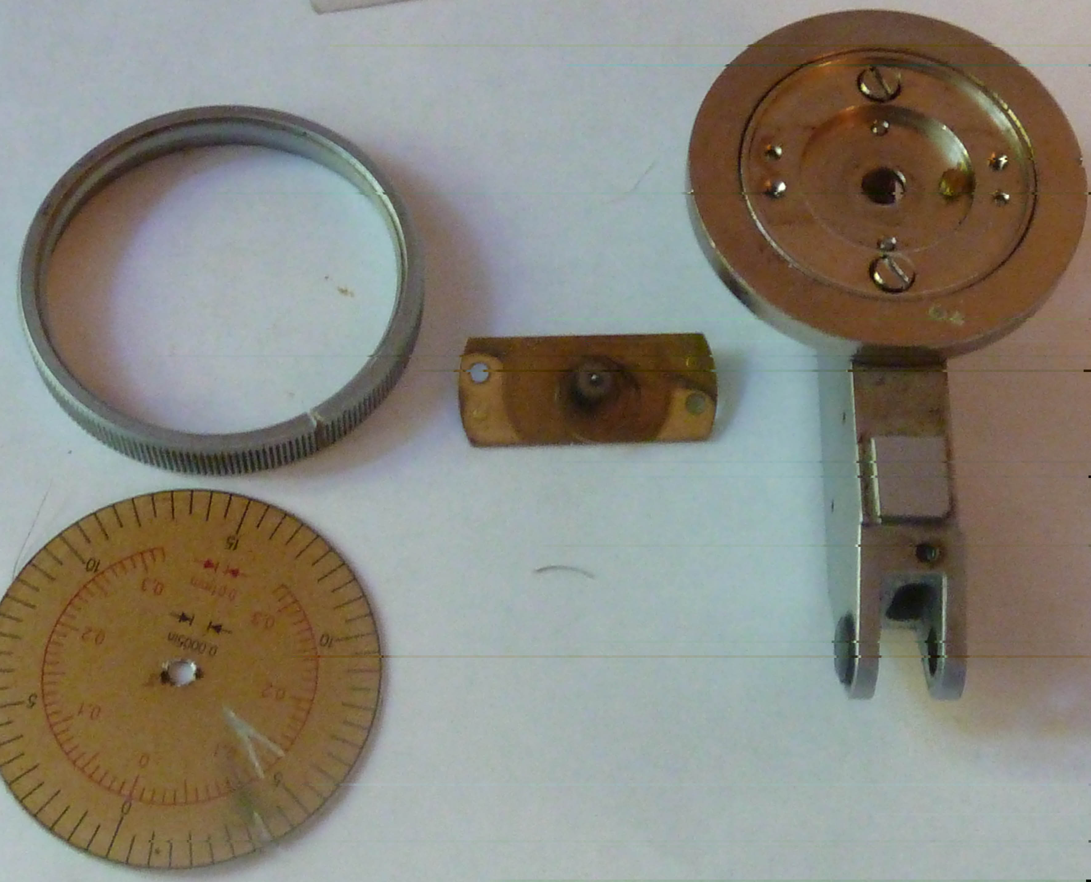

My favourite dti seems to have developed a mind of its own.Can anyone help with its disassembly ? Its my favourite because the dial face shows both metric and imperial - a shame more gauges don't.
Tuesday I noticed the hand going round whilst on my lathe. I even video'd it for entertainment.
Having removed the brass mechanism I find the problem is weirdly with the spindle from the pointer to the interior gear. If I rotate it it springs back to a random position. However I can't remove or examine the spindle without removing the dial face.
Any help with disassembly much appreciated.
I suspect the culprit is possibly a magnetised piece of swarf.
Many Thanks

On the Brown and Sharpe brands, there is a fragile watch spring just under the dial face. This keeps pressure on the pinion, so there is no backlash in the mechanism. Have you held the pinion and tried to move the needle?
  • Posts: 1179
Re: dti repair ???
« Reply #7 on: May 05, 2011, 06:00:58 PM »
Is it possible that the little gear is spinning on the needle shaft, or the needle is loose on the shaft?
However, I've got a horrible feeling the tiny clock spring, which removes the backlash in the mechanism, has either broken, and is just holding its position by friction, or (hopefully) has come un-hooked. The spring normally has to be wound up a few turns to act as a pre-load on the internal gears.
It looks from the video, like the circular dial part is held to the body by a couple of screws inside the body. Removing those might allow the dial part to be removed and give you a better understanding of how the bezel & dial comes apart.
If there is no obvious way to remove the bezel & dial (which almost certainly comes off from the front, after removing the needle), then it might require a thin steel shim to be inserted between the bezel and dial body to push back any spring clips that might be under there.

As the final word on this - for the curious. I cut through the case ring with a dremel to find that it had been pressed onto the backplate. If I'd known I could have used a puller but it would have been pointless. Underneath the scale is a small brass plate removed with two screws. The top of the brass plate acts as the bearing for the needle spindle. The spindle is attached to a very fine hairspring - which in my case had broken. This biased the needle to eliminate the backlash of the gearing, however with one end free it was acting like a free-wheel system, overriding the centring spring in the other part of the mechanism and causing the random pointer positions.
Note the broken piece of spring under the brass plate.
