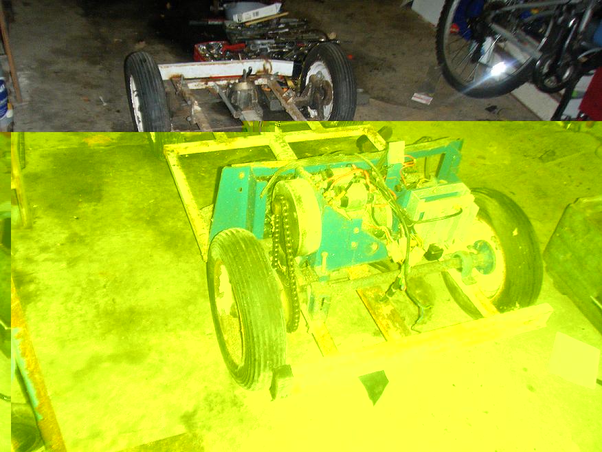

 I am making a mini landrover (series 3) for my 5 year old (or is that 5 year young) son
 I have a rolling 2 wheel drive chassis from a 1970's batricar that I want to convert to 4 wheel drive :bugeye:
by modifying the front steering hubs.(see pic)
At the moment there are stub axles running in bearings but i want to make a couple of castings for the bearings to run in
but with small cv joints instead of the stub axle assembly also with some kind of swivel to the top and bottom of the castings
for steering
Ive read some books on the basics of casting and think it would be a brilliant thing to be able to do in the future
but at the moment I only need 2 casting to be done so it probably not worth the expense,
I live in Potters bar south herts
is there anyone on here thats near to Potters bar who does casting who could possibly do some casting for me ( in exchange of some beer tokens :beer:)
also that I can learn from and get advice from (regarding setting up my own casting furnace)
Many thanks

it is mainly aluminium / alloys im thinking of using in the front steering assemblys as it shouldnt
be under too much stress as the finished car wont go faster than 4mph
you are a bit far away but i would like to ask a few questions
how easy is it to get a propane burner to reach high enough temperatures to melt aluminium alloys
is your furnace home made, if so it it easy to build
does the furnace make a lot of noise (my neighbours have a baby!!)
many thanks
malcs

Hi again Malcs,
Propane burners will easily melt aluminum. I use waste motor oil myself but it requires a blower which can be noisy. The naturally aspirated propane blowers are reasonably quiet so you probably could melt without waking the neighbors baby. Here's a link to a great casting site that should have enough information to get you going.  http://www.backyardmetalcasting.com/  Everything from burner and furnace design to making flasks for pouring.
Dan

Here's yet another link showing how to make a furnace from Portland cement, cat litter and Perlite. It does work; I took the photos on the lost foam casting page.
http://mikesworkshop.weebly.com/foundry.html

Hi Malcs,
thank you for  suggestions
I now have a copy of
'' foundrywork for the amateur'' which is making good reading at the moment,
I have also read about adding perlite to cement to make a heat resistant barrier in a metal drum / cylinder and noticed our
local ''wilkinsons'' do perlite for adding to flower pots (etc) at quite a cheap price.
Is it possible to make a furnace out of an old propane cylinder (47kg size) as i noticed one dumped in a ditch by the roadside a few days ago while cycling home from work
im not sure about the cat litter though!!
