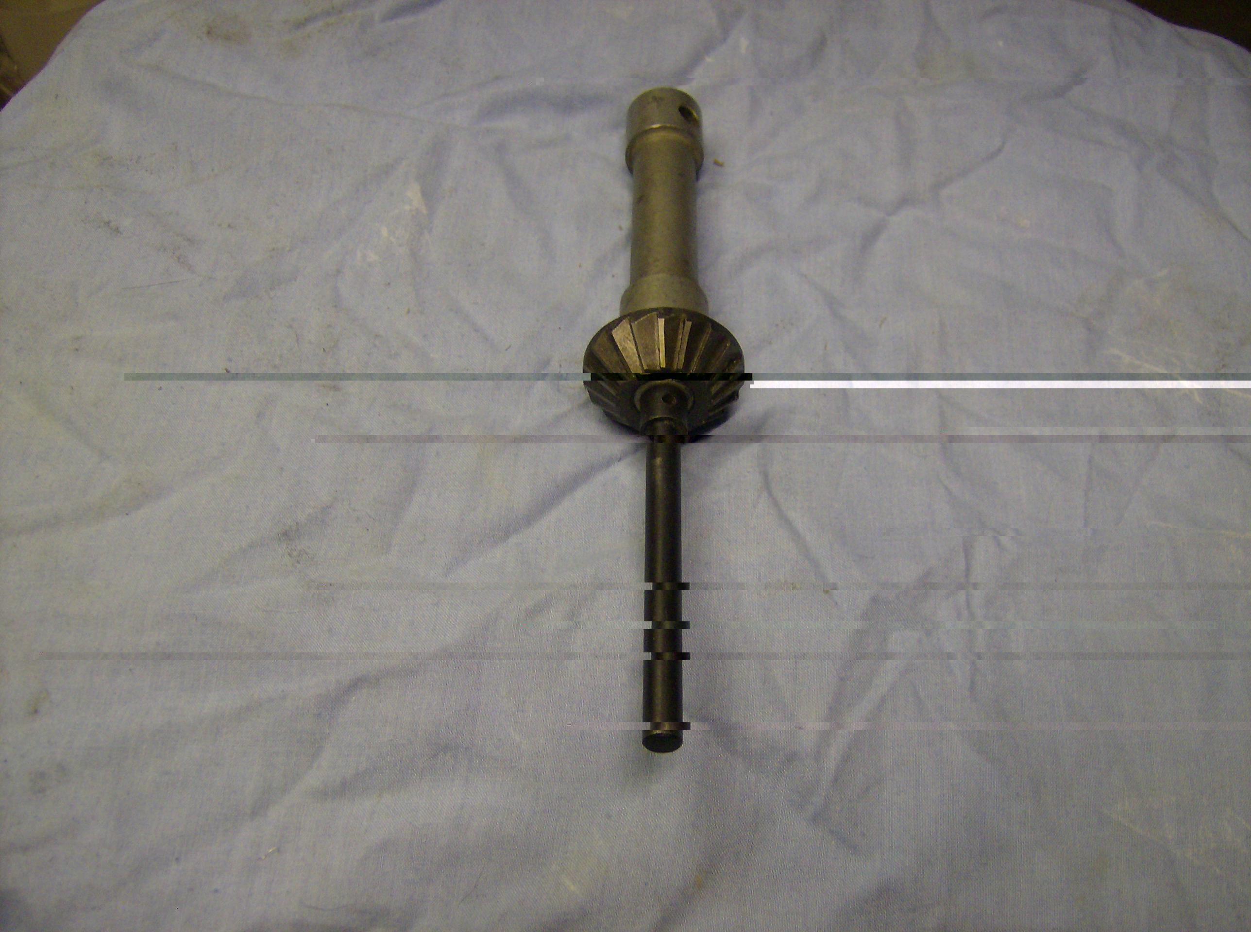

« Reply #17 on: March 26, 2011, 01:33:56 PM »
HI sos for not geting back sooner but me intrnet went off right as regards to threding for a valve seat replasment with this low reving engine anything will do i have even cut into water jacets to reper them 1 set up in the mill by yousing the valve gide to set it up on center with the ade of a boring hed tack out just the amawnt need to form a new valve seat + thred i youse fine mm thred  mace up new valve seat  the way i scruw the new seat in depens on the overall od but the way i normaley do it is by leving a large ring at the top in to wich i drill in too for c spaner lick the type you youse to remove your grinding discks from your angelgrinder i have scruwd them in with nothing on the threds and i have scruwd them in with locktite plumers tape red jonting compawnd all with no problems i can if you wish lend you my set of valve seat cuting tool if you is preperd to pay for the postige to you and back to me   regards bob

 - Bob aka krv3000 for kindly donating a valve cutting tool to the job (at least, I hope I understood correctly & that it was now donated.... if not, I owe you a new body, you'll see why in a minute). Another :thumbup: due.
So, on with the show. First up, I cut a test bore in some aluminium. The aim, to hit the exact dimension + 1 thou, of the seat insert:
It was a bugger to get in there, but once in & seated, it revolved easily. Mission accomplished  :D

And the fantastic valve grinding tool (with modified handle and home-made brass valve guide):

HI well dun yep the tool is yours to keep   regards bob
Re: SABB valve job
« Reply #28 on: April 28, 2011, 10:34:27 AM »
Bob - phew! And thanks; again, I couldn't have done it without that tool.  :thumbup:
