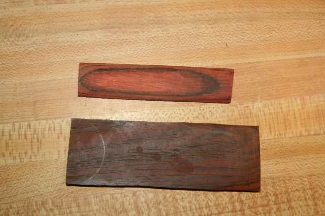

Not into knives as such, but really well done. Trawled all the way through to find a mention of the wood, only to see you're not sure either ...
'Cos I think it may be Cocobolo.
Long ago in my model boating days, one geezer made lace bobbins as well as boats. He had a fair number of exotic bits of Bogs' 'brown stuff'.
Remember Cocobolo looked like that, nice finish .. and another I think he called Snakewood. Don't think it actually comes from snakes, but thats got attractive grain too ..
Nice post .. Ta !!
Dave BC

Sorry Dave.
I have no idea what wood it is and it doesn't say in the limited bumf!
Happy you liked part of it  :thumbup:
Ralph.

What makes me think the handle material is Fibron is the bullseye pattern. This happens because when the factory makes the sheets of material it is built like plywood, out of layers of thinner material and they alternate colors alot of times to give the wood some contrast. Because the layers are so consistent in thickness it causes the bullseyes when you grind it. This material is also resin impregnated which helps it buff to a high shine. It is probably one of the most common woods on factory knives these days.
I added a pic of a piece of fibron and a piece of cocobolo, the large one is cocobolo you can see the pattern I mentioned on the fibron. Another indicator would be smell, when you grind cocobolo it smells like cinamon, it is like Tim mentioned a problem for people that are repeatedly exposed, some people develop severe allergies over time.
