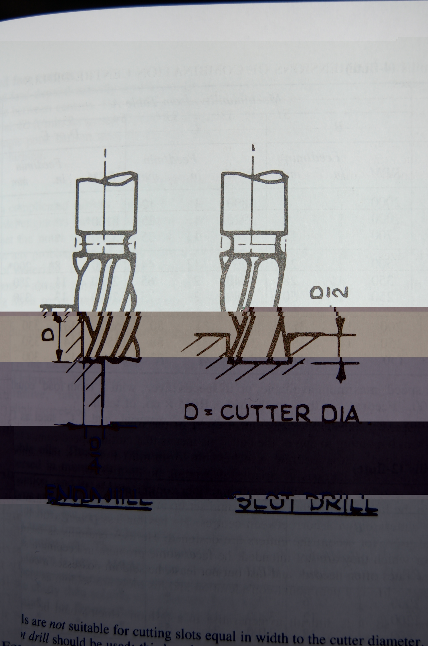

« Reply #9 on: March 13, 2011, 08:33:15 AM »
 I tried to cut a slot 1mm deep with the spindle at 500rpm,  it started OK but very soon it got really hot  and when it spat out a couple of red sparks I called it a day on that little exercise.... :scratch:  I thought this would be a basic milling operation?
With the end munted I tried a little cut along the side of 1/4" plate,  thats more like it!  A nice easy cut and a good finish.
End mills 4 flute work best for profiling as you found out   and      Slot drills for slots 2 flute there are 3 flute cutters that seem to do both quite well, I have a few throwaway FC3
In steel, either cold or hot rolled I use 1/2" cutter at 500 rpm as a guide then a 1/4" at 1000 rpm  1/8" 2000, cutters need to cut so don't baby it if the cutter is just rubbing it'll dull quick.
this picture is from a model engineering book so  takes into account of the rigidity of smaller machines so a 12mm cutter could cut 12mm deep and 3mm wide sounds a lot but I've tried it and with a little bit of backing of from the max it works.
Edit.. my machine has a 40 taper I think yours is an R8 ? either way just try upping it till one of you complains  :dremel:
http://bbs.homeshopmachinist.net/showthread.php?t=46150 post 5 is by Teenut he's talking about big machines here but it'll give you an idea.
Lee

Semi skilled has it right in the dia.
was you trying to cut full width cut of the end mill , think about it the edge of the end mill facing the direction on the cut would be just pushing
for speed I use for metric guide no for steel 25   therefore 25 *320 \cutter dis in mm    = give me 666 rpm . ye gods that the mark of satan  :doh: that mud have been the trouble  :D
 as a rule I use about a 1/3 cutter did for the depth and a 1/4 for the width
above all DO NOT let the cutter rub get the travel speed up to get a good chip load as Kvom said chips should be at the hottest light straw at the most
As you have found out end mills cut best on the sides  :D
a little bodge with a dull cutter with no t/c available is just to tip the corners ( leading edge ) to about 45 deg by a few thou keeps it cutting but will not make a sharp corner any more

G.Day John,join the Q with your new Milling Machine.
One of the problems is human nature,that is you are told not to do something but not informed as to why?
Books on machining will tell you "do not use 4 cutter end mills to cut slots" Why?
Well to try to explain here would take up too much space but try to imanagin what is happening when using a 4 cutter mill.
The mill is revolving in one direction at a certain revolution.
The material being cut is traveling in a certain direction at a certain velocity and depth.
Now take a look at the tooth that is in the leading position.
It is causing the work to go over to the opposite side and will make the cutter go the other way causing the two cutters that are now cutting  the sides to cut larger than their dimention.
This causes the slot that you are cutting to be larger than the dia. of the chosen cutter also ragged sides will be made.
Always use a good Suds Coolant/Lubrication fluid,and enough of it.
Also i bet that the time that the mill cutter brakes is when you come to the end and about to free it self from the cutting.
This is the most dangerous time of the whole operation as the cutting teeth are asked to cut large chunks of metal and if you have not tightened your gibs then the slack is also taken up causing more metal to be offered up to the cutter.
Most of us mill at too low a speed causing the cutter to take on too much at every revolution,think about it.
I would not use a new milling cutter on Ferous metals but would keep it for use on Brass or Ally first,then when the edge has worn off then use on Steel etc.
