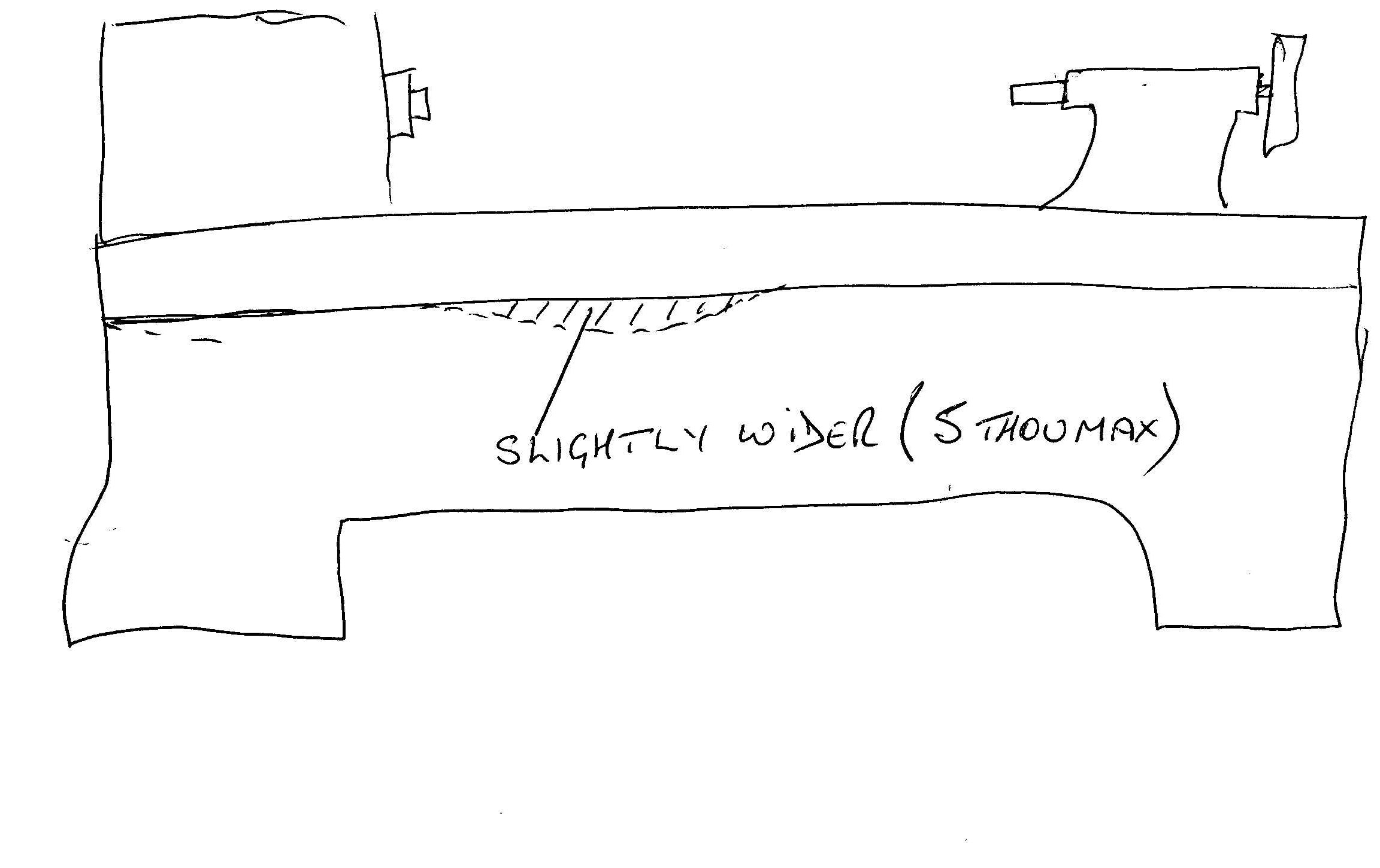

The poorly lathe.
I had visions of having to do major surgery on it, but as it turned out, with the correct measuring instruments, it showed it was only a minor scratch, and could easily be fixed with a bit of sticky tape (well, an hour on the mill).
http://i202.photobucket.com/albums/aa102/bogstandard_photos/poorlylathe.jpgA welcome visitor
There is a slight bulge under both sides of the bed in the same position on both sides. Almost certainly caused by original bad machining. So the jibs had to be adjusted to go over this 'hump', and invariable, anywhere else on the bed, the saddle would be wobbling about because the jibs just wouldn't be tight. Once these 'humps' have been hacked off, the jibs should be able to be adjusted to a much more stable setting.
So once my shop has been sorted a little more, this bit on minor work will be carried out, and hopefully the lathe will be brought back to full health.
