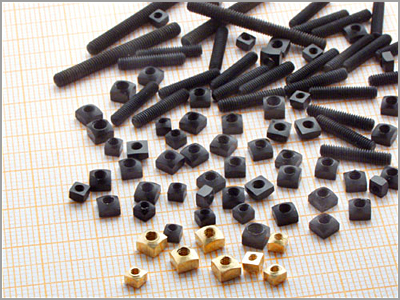

Here's a quick example of what your after, just do a google for coachbolts and square nuts.
http://www.ibuonline.com/productdetail/Carriage-Bolt-with-Square-Nut/4cb43ca68906a88337d1280c
For smaller square nuts using threads of 8-10 or 12 BA, please send me a private message, as I have made a machine that can do this, I can send pics if it if required, it's easy to make. The square brass required to make these nuts, is an over the counter store bought item as well.
mark

« Reply #14 on: February 08, 2011, 11:18:20 PM »
Not quite the type of nut he would need, the ones you put up, are plain flat nuts.
The old style nuts or coach bolt nuts, have an angled shape to the top of the nut, not just straight across flat. This made you use one side for the top only, that way the flat side was to the join.
You can see the difference in the nuts, even as small as what he's after.

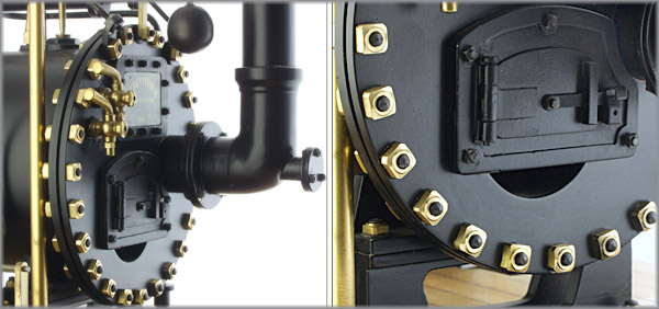

« Reply #19 on: February 23, 2011, 03:36:37 PM »
Everybody thanks for the help
Don them as descibed above - used 3 pieces double ended as Jason sugested
Worked a treat - didnot even take very long.
http://i608.photobucket.com/albums/tt161/geroli/WB61.jpgSquare Bolts
Thanks again
Gerhard
