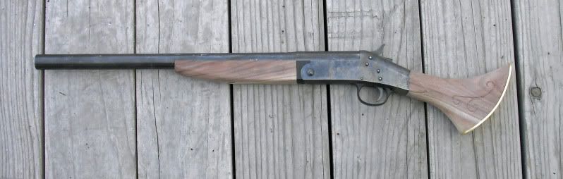

I forgot to add a picture of how it's coming together. I shortened the barrel to 18 1/4" so that's legal. The overall length will be nearly 27". I need to get some belts for my sander. I think I'll need it for the portion that touches the action. I'll probably do the majority of the rest of the shaping with rasps and files. That should keep me busy :ddb: :ddb: :ddb: This sure is a fun project!!! I love how it's turning out!!!!!
Stay tuned for more.....

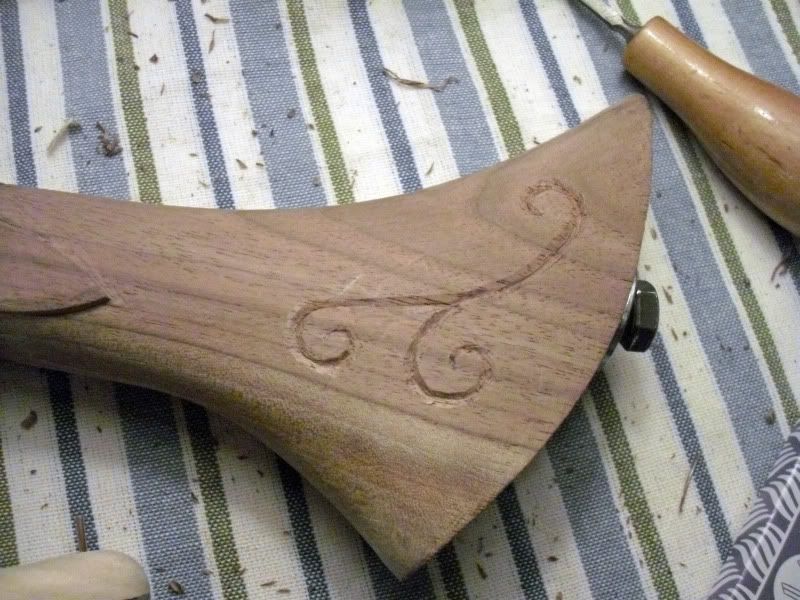

I started carving the stock a little. I think I need some practice. I'll smooth it up some and use a wood burner to darken it a little. But I like it.
I drew the pattern free hand on both sides. They aren't perfect. But to quote a pinstriper that I knew. "You can't see both sides at the same time anyways"
Wes :wave:

Tonight I finished up the bolt that holds the stock on. Now I can start mounting the brass Butt plate\o/ It's coming along.....
Wesley P

I got the brass Butt plate bent and drilled and mounted. I roughed it to shape with my belt sander then filed it to final size. I used a couple of hammers and a block of wood to bend the butt plate. A little more carving and I can start laying down my finish. I also chucked the barrel up in the lathe and trimmed the hack saw marks off the end of the barrel.
Wesley P

Carving is done. I used a wood burner on the carvings.
Here is the fore grip.
I decided it needed a lightning bolt.
About all that is left is final sanding and start to apply the sealer. Then on to the next one\o/
Wes :wave:

« Reply #37 on: March 25, 2011, 09:12:38 PM »
Just a couple pictures.
Later, Wes :wave

The last coat of sealer was just applied. I removed the rust from the receiver and the barrel tonight. I'll re-blue the barrel and put it back together for the last time in a day or so\o/
Then on to the next one\o/ And I'll post some pictures. It sure is shiny :)
Wes
