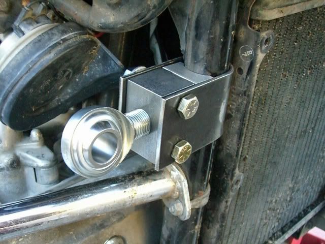

I bought a 1984 GL1200 a few months ago and have had a blast with it. I was chating with my wife one evening and mentioned that I thought a sidecar would be fun to try. She got all excited about the idea. Shortly after, I started designing and building one. Here are a few pictures. I'll post more soon.
The springs are salvaged off of an old Snowmobile.
One of the frame mounts I built.
Here is the axle I'm working on.
I bored out a Goldwing wheel to accept Timken bearings.
I laminated the floor out of 3/16" plywood.

It's looking good so far Wes!  :clap: Good job!
One question... that Goldwing wheel on the lathe. 17in? How big is that chuck???

It's a `16" chuck. I had to do that part at work;o) We have 4 20" X 80" lathes there.  I'll try and get a picture of the mill I run also. It has a 25" X 60" table. It weighs 24000 pounds.
