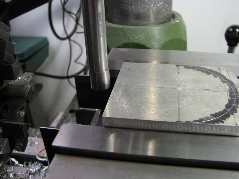

 Normally I would have made everything from steel but being as this bender would have limited use I decided to go with aluminum for the plate and clamp strap. The first pictures are the plate layed out and being squared up.
The next step was to pick up the edges with the edge finder so I could put all the mounting holes in, three for the clamping bar, one for the clamp strap and the large center hole (.500) for the pivot post.
 With those finished I put the radius into the long edges with a .375 ball mill

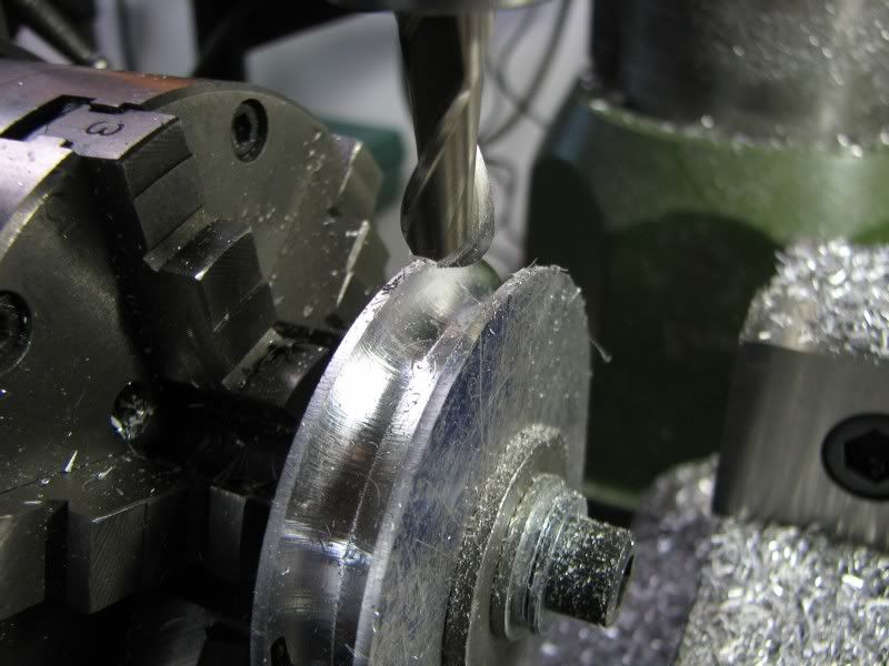

 To radius the end of the plate I was going to set my horiz/vert rotary table up but the more I thought about it I decided against it. The rotary table is 8'' diameter and I would have had to space the plate out far enough to get the spindle down to the work. I decided instead to use my dividing head, which was already set up. I made an arbor to mount the plate on an adjusted it true with my set true chuck.
 I then set the head at -0- as a reference point and with the plate lightly tightened I rotated it until it indicated -0-.

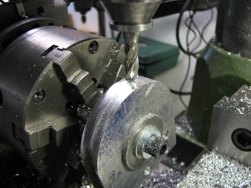

 The next step was to pick up one edge so I could establish my center. With that done I put in a .312 end mill and moved off center about .152. The reason for this is because if you stay on center the end mill cuts a scallop and won't clean up to the proper dimension required. In the one picture you can see how it scallops the cut. In my case I only needed the outside edges cleaned up because the center was going to be cut out anyway.
 I then moved back to center and put in the .375 ball mill. My first cut was about .08 deep but my little dividing head didn't care for that. Although the ball mill was sharp the cutting edges are relatively flat and you get more banging than with an end mill. I reduced the cut and finished it up with about 4 passes.
