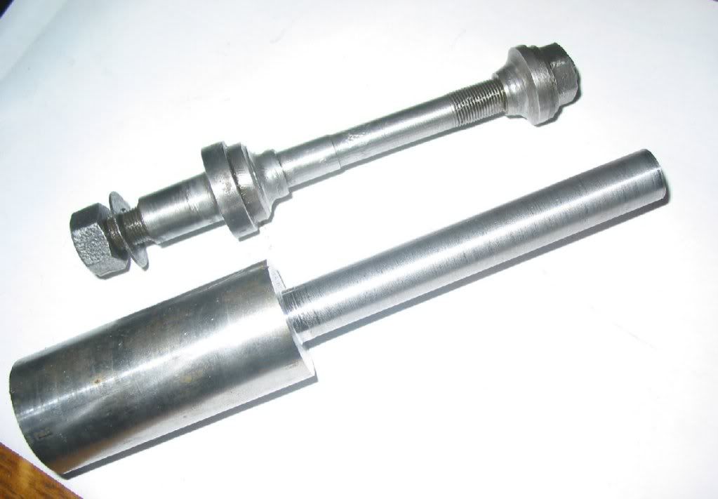

  Engine will be aluminum castings. Sand cores for water jacket. There nothing to this project that would give too much trouble to a determined hobby machinist ..As we all know, metalsworking is easy assuming you have the tools and know how to use'em,, the trouble is keeping the interest going long enough to finish a big project..I have enough tools . If I fall on my face it will be cause I dont care enough to finish.
 Here see the setup I used to bore out the aluminum casting I made for corebox to make the sandcore which will be the waterjacket in the cylinder..The inside diameter of this casting is the outside diameter of the water jacket for this 3hp engine..Big ain'it?

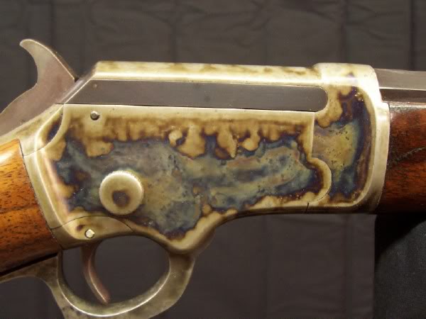

    I have started building winchester 92 though its anybodys guess when I may finish it.. Hers sideview picture of a Marlin 1892 that I built..I made every piece of the rifle except bought the tubular magazine and one spring and started with a large dia rifled barrel blank that I milled to a tapered octagon..I made every other spring and bolt and carved stock and cast the buttplate..Its a purty gun to go shoot in the backyard...... I have schematics of takedown rifles but honestly I dont want one myself and I dont understand the appeal.

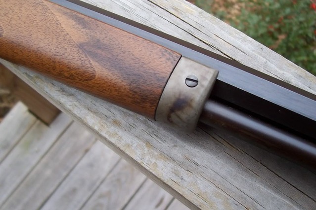

Heres another picture..Some folks would be surprised to learn how long it takes to machine that little chunk of steel at front of the fore end..To make it and the little dovetail retainer inside it and make the screws and polish and colorcaseharden takes me all of about 3 days...and altogether there is lots of little parts to be made on a gun build..Heaps of fun.
