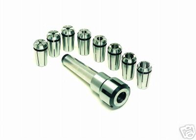

Hello all,
Please can you lads advise on the type of collets i have just received
Got them from Chester Tooling  :palm:
and i need a 6mm collet as i got the imperial type so i phoned them up and asked if they were ER type
and the response i got back was NO only Chester collets will fit !
Can this be true or am i being conned?
Thanks again

« Reply #1 on: February 07, 2011, 06:59:55 AM »
Chester are correct. These sets were a predecessor to the ER system.
If you go to here, and check the measurements of your collets, I think they are the same type, and most probably a lot cheaper.
http://www.arceurotrade.co.uk/Catalogue/Collets/Collets---Other
I used the Chester set for many years, and never had a tool slip.
Bogs

Re: what's my collets
« Reply #3 on: February 07, 2011, 08:34:43 AM »
Each true ER collet will collapse by up to 1mm when tightened. For example, a 7mm one will grip diameters down to 6mm; in fact, they are often marked 7 - 6, 6 -5, etc. So, I can use a 7mm ER collet to grip 1/4" (6.35mm) items. That's the beauty of an ER set; they give continuous coverage of all diameters within the range of the set.
John, are the "non-standard" Chester ones similarly accommodating? If they are, then James could use his 1/4" collet to grip 6mm tools or materials.

« Reply #4 on: February 07, 2011, 08:41:48 AM »
Hi Andy,
Thanks But i have already tried that 1/4" collet- 6mm shank Didn't work  :bang:
Looks like i may have to shell out for a set of metric collets (the wife won't be pleased)
James

« Reply #7 on: February 07, 2011, 11:37:12 AM »
I had a set of these co-called "Chinese" colletts for while - in both Imperial and Metric sizes to match my tooling. They worked just fine with the MT2 collet chuck I started out with. I assumed (correctly I think) that they should be only used for their 'nominal' diameter (in a similar way to say a 5C collet). I think Euro Arc Trade had these on offer for a while & may still have.
They served me very well for this purpose as my main use was to hold smaller sizes of end and slot mills. I never had one come adrift or get "pulled" out whilst macheining -albeit taking modest cuts.
However, I moved on to standardise on ER32 collets.
I already had a 5C Spin Indexer (with the 5C/ER32 adaptor) which I used with a few 5C collets originally.  So I then also purchased the ER32 adaptor for my 5C '4 & 6 sided' blocks - which I find very useful for all sorts of things. I now have two ER32 chucks (on Myford/EW 'noses' - so they fit all my lathes and "associated" fittings). A full set of ER32 colletts covers most of my needs & I easily can get replacements if I screw one up. If I need the 'odd' 5C special collet for the Spin indexer or blocks - then I buy them as required.
This all seems to work pretty well for me so far and I see no need to change. However the 'Chinese' collet system worked just as well but was not as flexibile with regards all the set-ups I can now use the ER32/5C system with.
