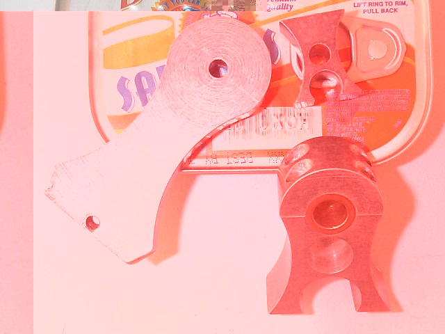

After about 40 hrs, we are about 65% of the way there. The peice on the left is the orginal, and the one on the right is the one I been tumbling. Though the looks aren't that noticable, the feel is. The tumbled one is silky smooth. I think The way I went about the deburring stage has added to the time in restoring the finish.
http://i706.photobucket.com/albums/ww62/mrazink/001-52.jpgTumbler Trials & Tribulations
http://i706.photobucket.com/albums/ww62/mrazink/002-43.jpgTumbler Trials & Tribulations
Matt

« Reply #105 on: February 13, 2011, 12:47:26 PM »
Looking good
Debur stage, pre-polish stage and final polish. I see a lot of reference to pre-polish as media with a cutting compound (ie. walnut with rouge) and the final polish as media with a lubricant or rather a compound with no cutting action.
Rotary is a slow and go but its starting to be a looker. Now that's being done with compound and red rouge?  rio burnishing compound ?

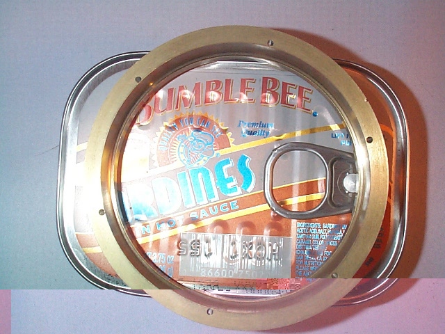

Tried what will be a flywheel rim made from brass in a 2 hour tumble steel shot to debur the edges. Fresh turned brass can be sharp, can now run the fingers over the edges with no cuts at all. Really starting to like this process just for the debur. Even running a piece of sandpaper over sharp edges can look out of proportion, too roundly for the scale and I do remember the time the sharp edge ran right thru the paper into my finger.
Dry shot, tumbler, couple hours, working so far
Robert
Edit  edges pixalated  my chepo camera

24 hours in walnut shell with a tube of Simichrome added. Just a hojboj of pieces. As stated earlier if the pieces have tool marks you'll end up with polished tool marks.
The crankshaft shows the non tumbled (left) vs the tumbled (right) supports. If I were to try and polish with a wheel the edges would loose there crispness.  When the next batch of abrasive media gets here I'll see how it tackles what I cannot escape, toolmarks.
Robert
