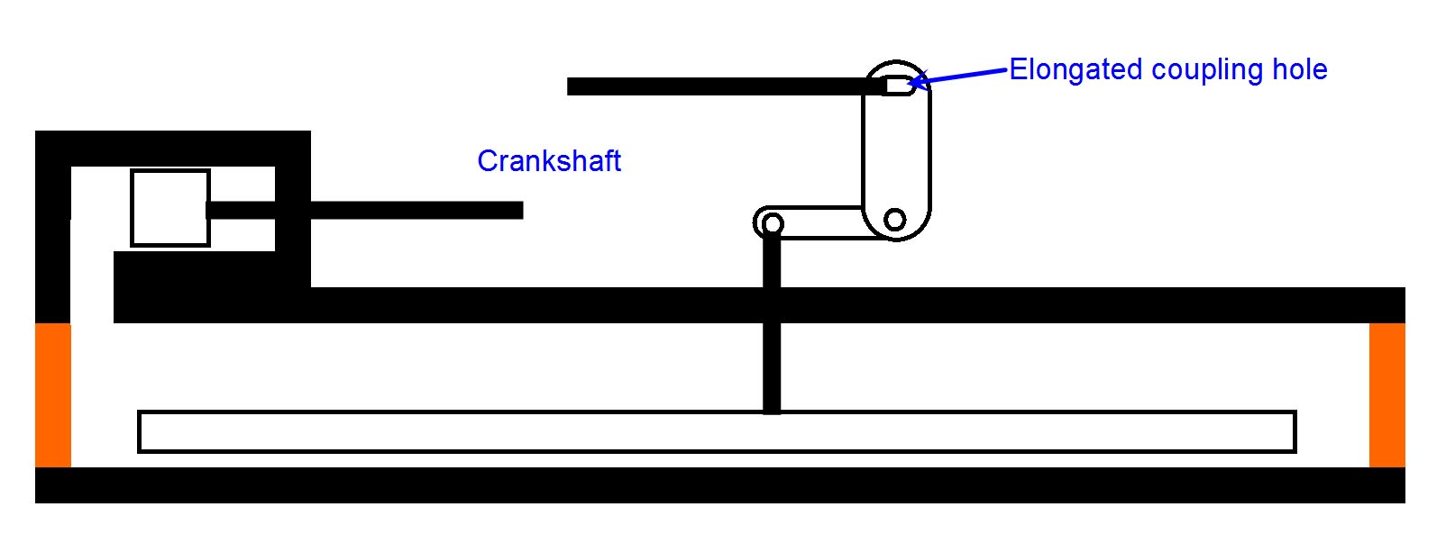

I decided to make a vertical shaft coffee cup stirlings for my kids for next christmas (I like to plan in advance  :lol:).
This would involve the conventional displacer but with the power piston at right angles to it. The displacer would be driven by a bellcrank from the vertical shaft, and its weight could be counterbalanced by extending the bellcrank and weighting it.
It then occurred to me that if the top arm of the bellcrank to crankshaft joint were made to have a lot of play this would result in the displacer staying in the hot or colder position for longer intervals, increasing the power of the machine.  The displacer piston would stay in position over the slop period because the air pressure encourages it to do so.
Any thoughts on this concept and its snags ?

As a further thought, has anyone tried sticking aluminium foil to either side of the displacer piston ?
This should increase the speed of heating and cooling of the gas by near doubling the surface contact area. The foil would be reheated/cooled as it comes close to or in contact with the hot or cold plates. Possibly foil from a pie case or similar would be about the correct thickness (and a good excuse to eat pies to find the correct tray :clap:)
As a further bounus could probably be made to look cool  ::)

This is my current state of LTD thinking. I think I've got a bit more figured out now.
First a nice simple optimum ratio equation:-
optimum temperature differential = 273 / (power cylinder volume/displacer volume)
In Jan's design (latest LTD coffee cup) with a ratio of 51-1 the temperature change for optimum work is 273 / 51  or only 5.4C.
So why do Jan and others use such a high ratio, and optimise for such a low temperature differential ?. The answer is that during the time that the displacer is in a heating or cooling position, the maximum change of temperature that can be made to the working fluid is limited. These limitations are caused by the low thermal conductivity of the working fluid, and the small surface area available to heat/cool the fluid.
So despite a fairly large temperature differential, I'm guessing 35C, only 5.4C makes it to the gas in the time of 1 revolution, so anything which improves this will help a great deal.

@ John, Billtodd
I think the 'economiser' idea is spot on. A hollow displacer filled with fine aluminium wool (if there is such a thing), with two diametrically opposed holes in the top and bottom surface would improve things dramatically.  The constructor would then have the choice of leaving the expansion ratio's the same with the engine working at a far lower differential temperature, or decreasing the ratio and extracting more power from the device at the current teperature differential.
Currently the gap around the displacer works out to 314 mm2, so the two holes would need a diameters of 20 mm. Smaller may be OK because the 1mm cylinder gap exposes a large volume of gas to the boundary layer effect. On the other hand for a heat exchanger to work well would involve high boundary layer contact.
The only downsides to this I can see is that resistance to airflow will be slightly higher, and some additional driven mass will be added to the displacer.
