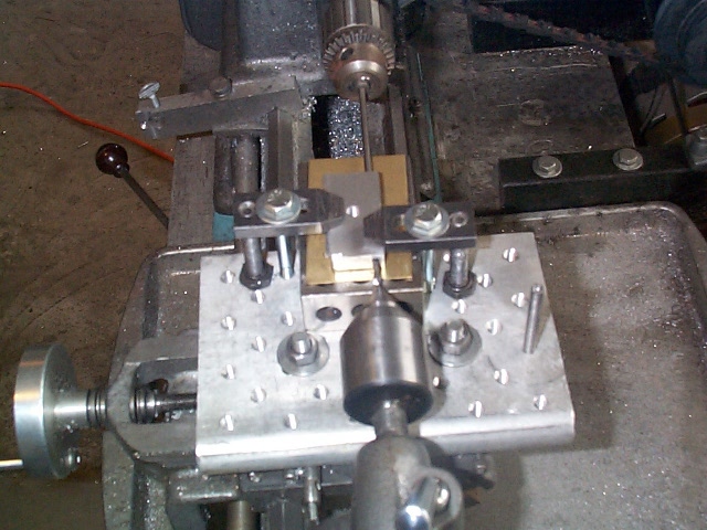

One more thing is can you guys help me find pictures of different setups.

Offline foozer
  • Posts: 194
  • Camano Island WA
Re: drill a 1/2 hole in 1" material
« Reply #9 on: January 23, 2011, 05:05:53 PM »
andrew,
thanks for the input.  all you guys have helped me come up with something i think will work.
Is not exactly what your looking for but might be close, at least a visual. I needed to drill a 0.125 X 2 inch deep hole so used this setup to see if I could drill it straight and not break the bit. Something similar should work for you. I'm running with stone axes and flint knives, your mileage may vary.
Robert
Offline krymis
  • Posts: 37
« Reply #10 on: January 23, 2011, 08:20:40 PM »
that is exactly what i need.  i was hoping to get pictures like this.  more if anyone has some.
