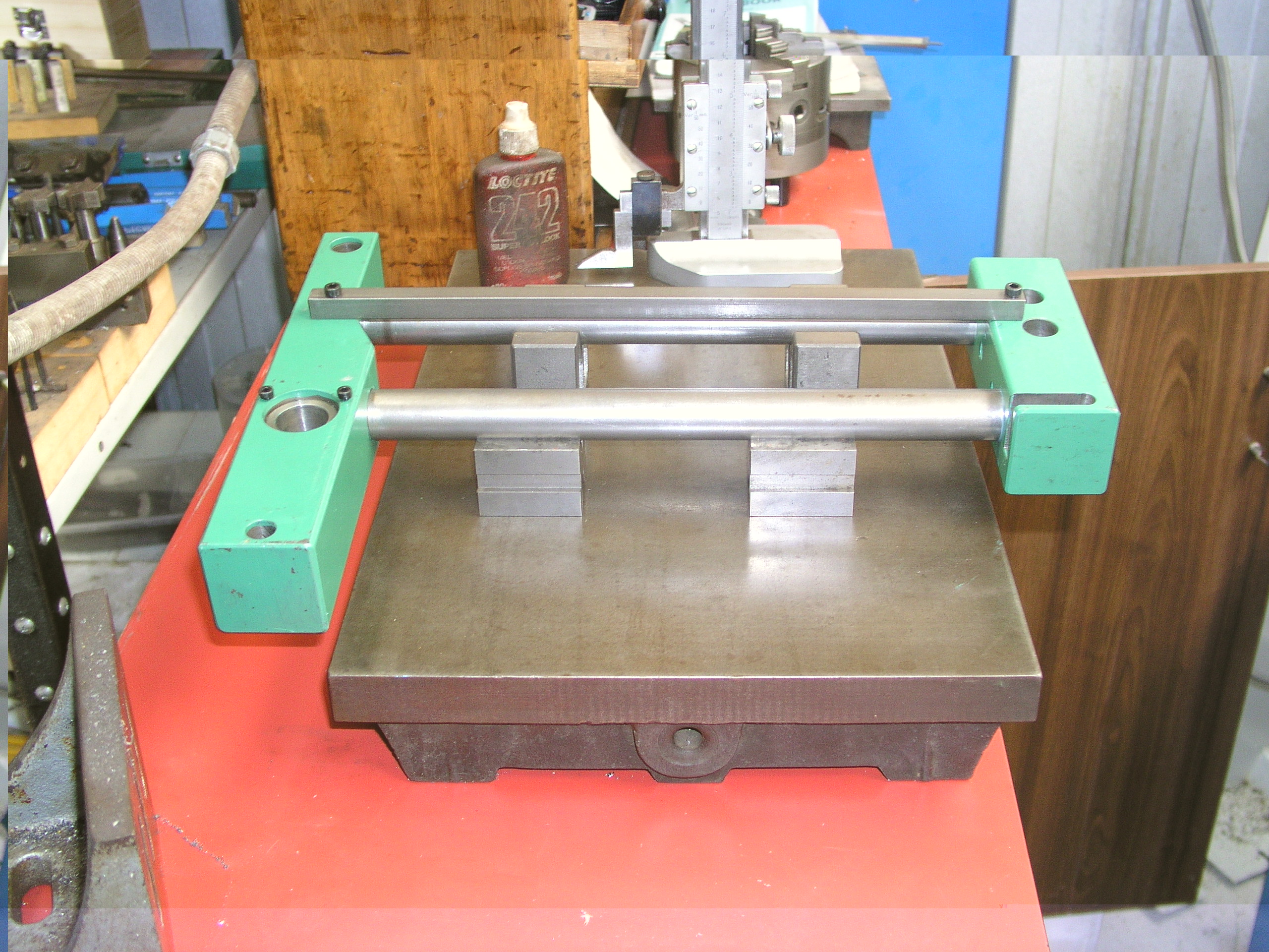

G.Day Each,
I have not given up the Bonnelle TCG its just that i have purchased a new lathe,see Chinese Lathe C06230A in the 'Tools'
I started the machining of the various parts as took my want on the South Bend and the Drill/Mill.
After setting up the new lathe i started to make items on it due to wanting to play with the new toy.
The new toy was perfect.
I did mention before that the drawings are in 1st angle projection,this still throws me and i still have to go back to basics every time i use the drawings.
No fault of the Draftsman,just my own history in usind 3rd angle projection during my days in Coventry UK.
The first items to be machined were the Two Main Ends.
These are made from Cast Iron Bar as purchased.
The only problem i encountered was that i could not get Cast Iron Bar in 2'' but only in 50mm and that was 50mm minimum.
The largest end is given as 2'' whilst the other smaller end is 1.5''.
Now as i could only get 50mm i decided to make the smaller end in 50mm also.
No problems,but i do have to make allowences in the dimentions of other details that are in contact with the small end.
You will also have to find out where the detail you are making fits so that you machine it to the required fit,this can be hair pulling sometimes.
I have found a few small mistakes in the drawings as you will.
If as i did you machine the main ends first,get your main shafts ready and machine the main holes to be a good fit to these.
Remember you have only one chance to get the final cut right,over size hole dia means that you scrap and start again with another piece of cast iiron bar.
Will continue witha few photos later on.
GerryB

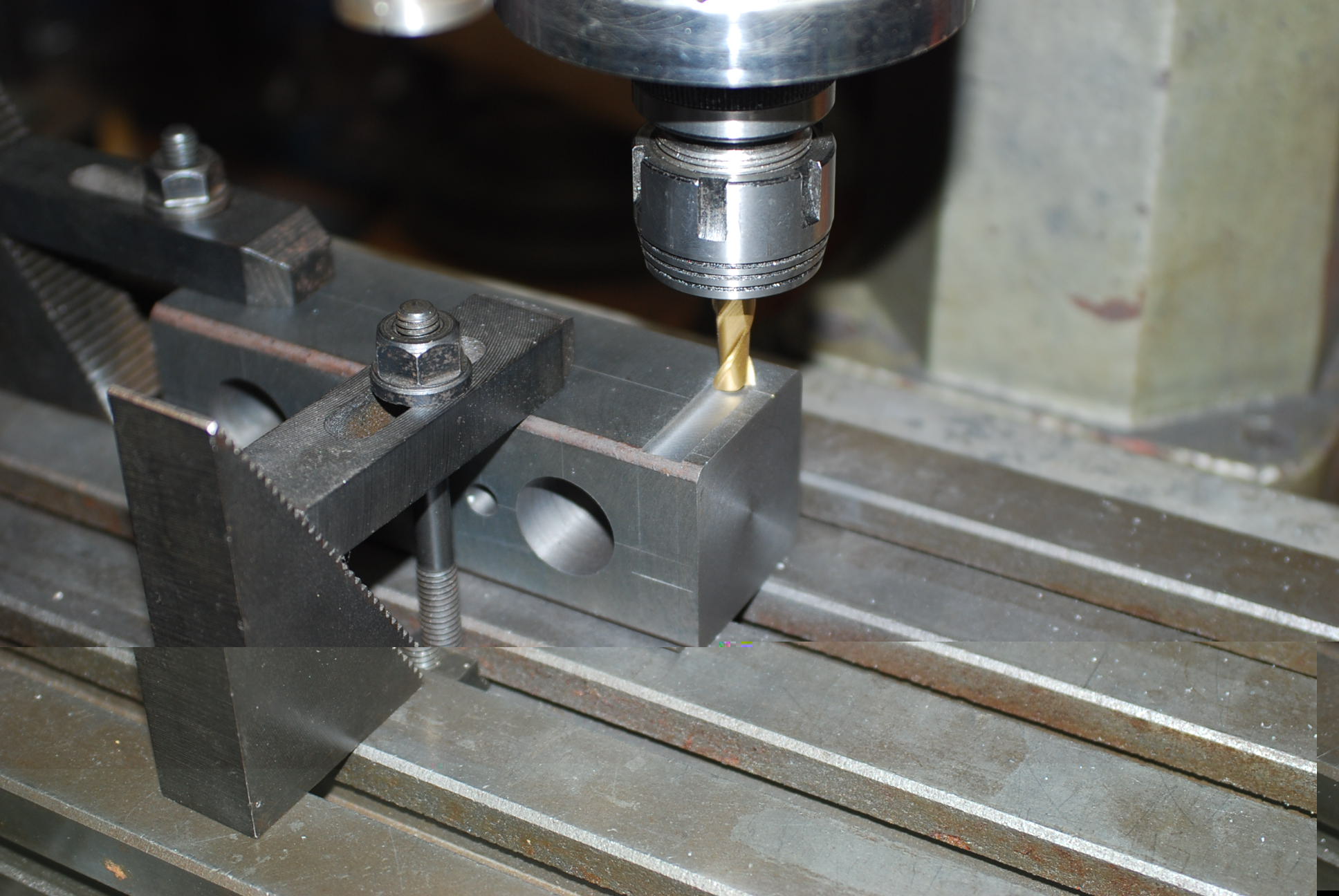

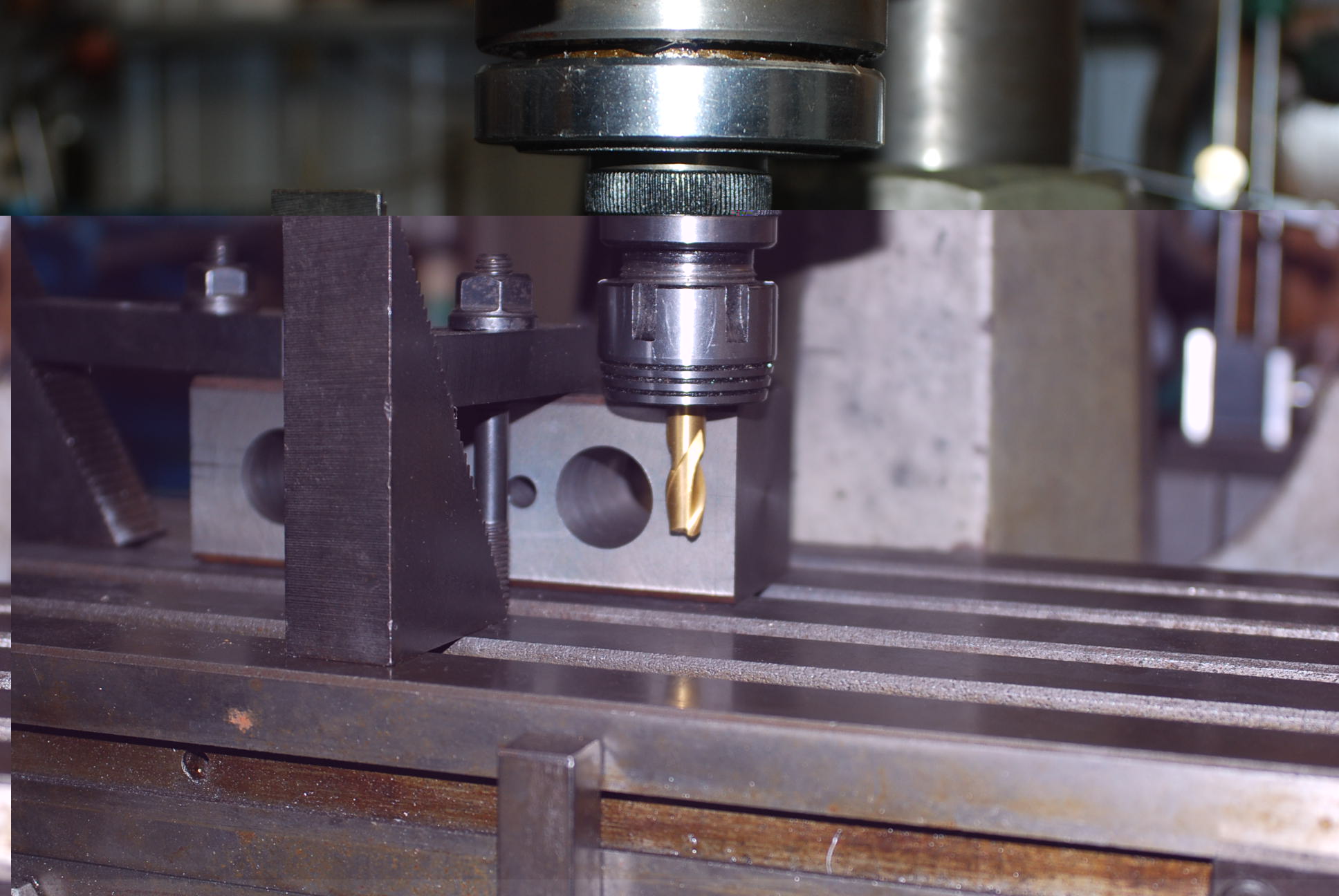

Most of the machining of the two Base ends is straight forward.
Note that the two holes marked 'C' in the first drawing are incorrect that is you should not be able to see them until viewing the bottom drawing which is correct.
It is these small faults that can throw you off.
Also note that the holes are marked as 8mm,no problem untill you try to fit detail 'B4/1.
Any one requiring a Det 1/B4.
The 8mm threaded holes "C" are used to secure the two Base end together so that when you machine out the two holes that hold the main shafts they will be inline with each other.
Be carefull here when setting up for boring,i suggest that you mount the work on the cross slide and not remove or alter settings untill both holes have  been opened up to take the shafts.

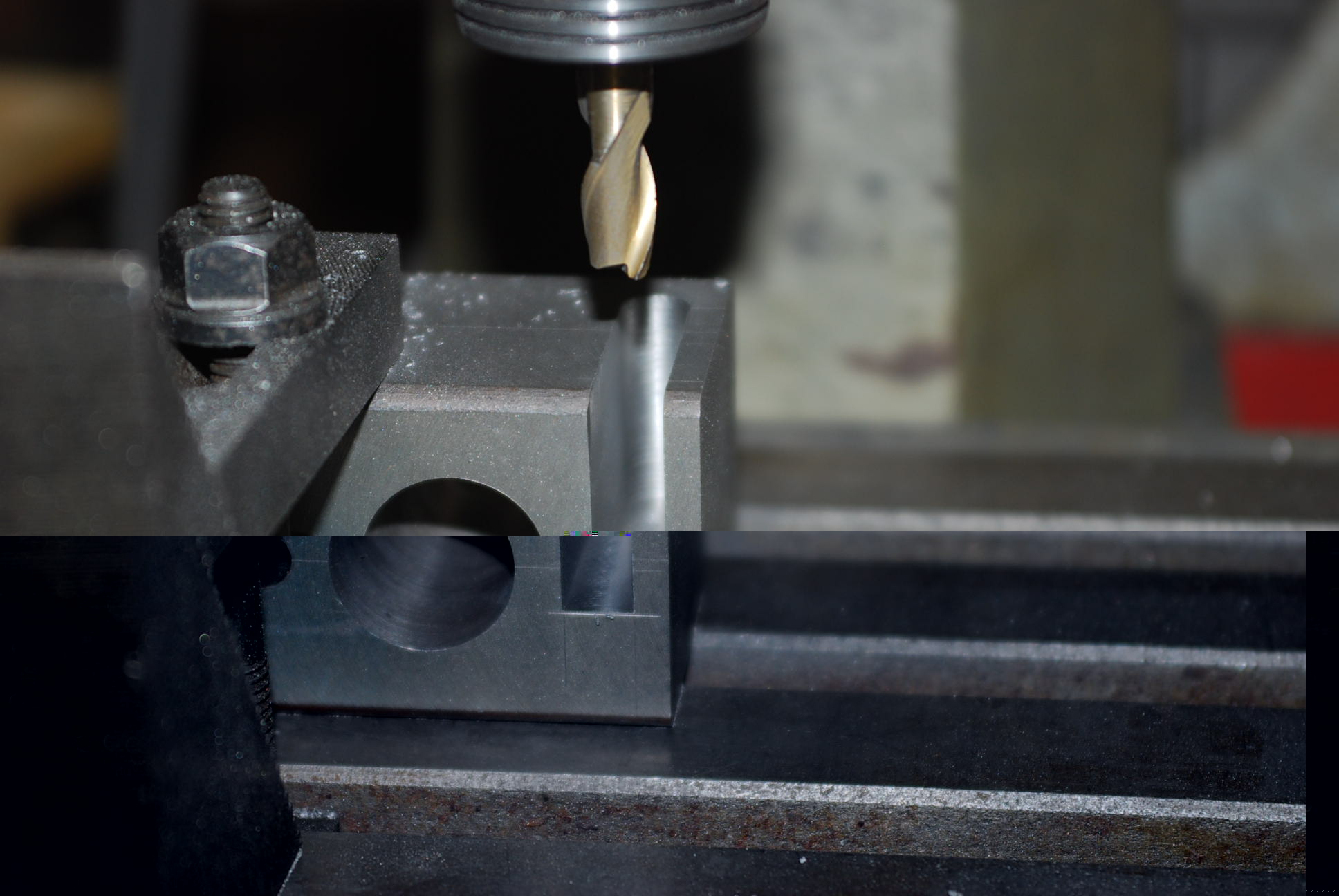

If you set up in the 4 jaw.which is ok but you may be boring a cone shaped hole depending on the accuracy of your lathe.
The pictures enclose show the slot being milled in the small end to accept the 1''x3/8" bar in B5.
Here again depending on wether or not you are able to get 3/8'x1'' stock you may have to alter the set up to accept the nearest size  you have.
I use a 3/8''Slot Drill to mill out the recess.
Do not on any account use a 3/8'' milling cutter or you will make a hash of  the job.
In many engineering books that i have read little is said if anything about the use of different types of milling cutters other than use Slot Drill to cut slots and milling cutters for other milliing operations.,and plenty of photographs of profesional set ups.
I love to read instructions and information on setting up but despair when no information is forthcoming as to why or what will happen it you do or use something different.
I will try to explain what happens when milling slots later on,so here are a couple of photos to be getting on with.
GerryB

Now what happens when we use a Slot Drill.
Slot Drills are what they say they are,cutters for cutting slots and will also drill,but be careful here they are not like your common drills.
Where as a milling cutter will not drill out any thing above 10 to 15 thou the slot drill has no qualms about depth,but remember it is not a drill.
It comes into its own when cutting a slot that ends within the bounds of the material therefor does not come out at the edges.
Here you allow the cutter to cut to the depth you set for the first cut and away you go.
When you get to the end you cut a little deeper and cutting a deeper slot return to the start.
The depth of cut will  depend on many factors that you will have to adhere to ,material,size of slot,quality of the cutter,milling machine,finish required,
cutting liquids( not cast iron) removal of swarf,etc,etc.
Lets take a look at diagram No.4.
Here we are set up as per the other but using a two bladed cutter,or slot drill.
When i first came across the slot drill i thought that it was a cutter intended for routing wood and the like.i mean who would foolishly try cutting steel with a cutter with only two blades when milling cutters have at least 4.
I was to learn!
As you can see the two cutters are 180 deg.apart meaning that when one cutter is engaged the other is free.
This is simply a double fly cutter.
Due to the fact that only one cutter is engaged at a time any displacement of the whole cutter does not cause any other cutter to engage in the side of the work.
So cutter 'A' starts its cut and in so doing causes the cutter to go the the left a few thou but cutter 'B' is free and does not come into operation until cutter 'A' has finished its cut so no problems.
By the time cutter 'A' arrives at the right side it is cutting less therefore less force is acting on the whole cutter now allowing it to resume its original center.
This cutting action gives the required close dimensions required in the slot.
But! please remember if you are cutting a slot out to the sides of the material,slow down.tighten up the Gibbs and keep swarf out of the way.

Well,i dismantled the Wheel Head Assy and mounted the main block C4 in the Miller.
Fitted a 1/16" Slot Drill and proceeded to mill out a slot to 50 tho in depth.
Set up on the Post and tried to tighten,no good.
Re set on the Miller and increased the depth to .1" still no go.
Set up once more and milled out the other side to ,1",now we are getting somewhere,its starting to bight so will cut out both to .150" and hope that will solve the problem.
Picture shows first cut to .050"

G.Day Guy's
Well i relieved the slot i was cutting in the Main motor mounting block by another .1" making the depth no to .15".
Testing this out on the shaft i was relieved to find that it now started to grip but i am still not quite satisfied with it and will probably make a further cut.
Now the drawing of the part G7/1 calls for the holes to be tapped 2BA,this is no problem except that i cannot get 2BA Allan Cap bolts out here so i made mine 5mm.
No sweat until i came to assemble the unit to G5+G6.
G6  gives the position of the holes to mount the block,problems,the holes are very close to the inside edge of G5/1.
So i had to relieve the side of the 2.25 inside dia of G5/1 to allow the heads of the 5mm cap bolts to fit.
Now looking in my box of various cap screws i came across a 2BA bolt,tried to fit this in the hole in G5 and still would not go so even if i had tapped for 2BA i would still have to relieve for the heads.

First we go to the main Base Assy.
After  deciding that i had drilled all the necessary holes etc in the main Cast Iron Base's i decided that it was time to secure the rear fixed Bar to the ends.
Now the distance between the ends is 12".
My Surface Plate is a 12''x18'',great!
Only the 12" is actually 12.01 so i had to set it up with 'V' Blocks,see photo.
Clean and coat holes and shaft ends with Locktight.
Gerry
