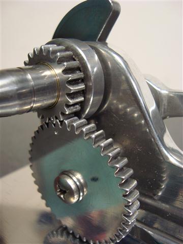

Chris,
Why don't you try using a slitting saw first then follow up with your cutter?
Offline Bogstandard
  • Bogs Group
  • Posts: 1107
Re: Webster IC Engine build log.
« Reply #76 on: February 13, 2011, 12:18:43 AM »
That looks like your blank is loose
Bogs
Location - Crewe, Cheshire
Skype - bandit175

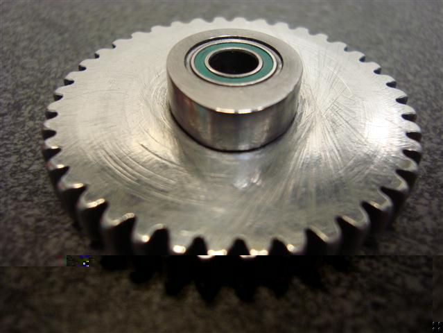

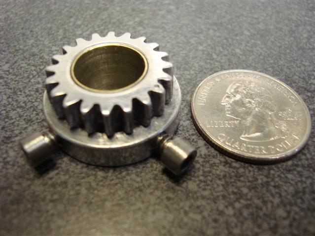

« Reply #80 on: February 16, 2011, 05:07:54 PM »
Hi Doug, thanks for your replies to my thread. I do appreciate your comments and your approach with a dremel was definately unique and clearly produced some nice gears! Since I`ve gone the route of gear cutting, I`d love to stick to the original plans and try and make the gears - part of the challange now I`ve started it.
Bogs, you were dead right, something had moved. I tried another few teeth on the dead blank and found the same. The full cut on the machine was just too much for such a small machine and it was vibrating loose. I do realise that my tool should be sharp enough to take the cut - or maybe not with just a single point? Anyway, I went with DeereGuys advice and went around first with a slitting saw, obviously of smaller width the cutter tip and to just a few thou short of the full cut.
This removed a good bulk of the metal and as soon as I swapped over to the gear cutter, I could tell cutting the first tooth that cutting was much smoother! The cutter did pick up a bit of a burr (I think perhaps I need to make sure my next cutter is a bit sharper)
I also used a much bigger washer to protect the little spigot but it also supported my teeth more even though it meant cutting into it. I don`t think I needed it actually but still, it seemed to work.
...and then cleaned up and put on some 8mm silver steel for a proud picture  :ddb: I`m chuffed :D  So just like the plans call for, a 48 tooth 32dp gear. I just need to make a 24 tooth gear that will mesh with it...I guess that is the real proof of the pudding!

« Reply #81 on: February 16, 2011, 07:44:03 PM »
Nice job.
Perseverance paid off this time, and now you should have no more fear of it.
You now know that you can make a cutter and cut a gear with it. It is just a matter now of fine tuning to get even more impressive results.
Bogs

« Reply #82 on: February 16, 2011, 09:50:22 PM »
EXCELLENT job!!!  That thing is perfect!!!  My shop grows a new machine or major tool each week, so maybe I will come across a mill in the near future that wont break the bank so I can start cutting them like that!
Do you have an indexing head or just a rotary table?
very sweet job, sir.

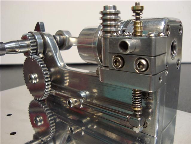

« Reply #92 on: February 25, 2011, 07:53:17 PM »
Slow slow slow going....
I cheated, I purchased the second gear a 24 tooth 32DP off ebay for no more than £3! It is nice to see that my 32DP 48 tooth gear meshes with it so it was a success!!
I`ve tapped the cylinder which was tought and it fits nicely into the cylinder support. I`ve not got any nice cap head screws to fit so the screws in the photo are just temporary. I`ve also bolted the supports to the base piece and I`ve drilled them to fit the bearings. I`ve gone with bearings intead of bushes.

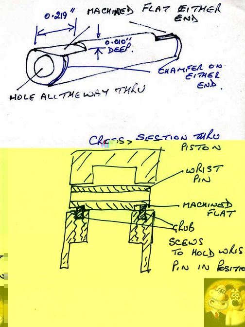

Could anyone help me with reading the plans!!
http://home.comcast.net/~webster_engines/Plans.zip
Page 7 of 21
The wrist pin! I really don`t understand any of it - I literally can`t see how it should look and can`t read the plans at all. I expected the wrist pin to be simply a pin, maybe a slight taper that pushes through the piston to attach it to the con-rod. I`m sorry, feel a bit of an idot but I just can`t make it out!!
I`ll update with some pictures too soon! Not done much as I`ve had a busy month at work and home but I`ve now done the con rod!
Any help much appreciated!

Chris.
Looks like there milled flats down .010 thou deep x .219 in from both ends, with a .094 bore through the pin x .188 od. It has a .015 flat 45* chamfer each end.
Anthony.

« Reply #95 on: March 16, 2011, 10:08:30 PM »
Does this C-o-C explain it any better?

John, yes, thanks a lot. If only all the parts were written in c-o-c, it would make much more sense to me!!  :ddb:
Thanks again for your time and effort in posting.
dbvandy - yes, I did wonder if it was needed. If you are not using the grub screws how is yours staying in position - friction fit?
Chris
My pin floats.  it is about .020 smaller than the cylinder so it does ride along the cylinder wall, but it is brass, so it does not matter.  I did the exact same setup with the otto and it works great.
With the Webster I followed the spec for Viton o-rings and oversized the groove...  the o-ring slides up and down the piston about .040.  This just did not look right to me, so on the Otto, I cut the groove just a little larger than the thickness of the o-ring so that when it compresses, it fills the hole.
