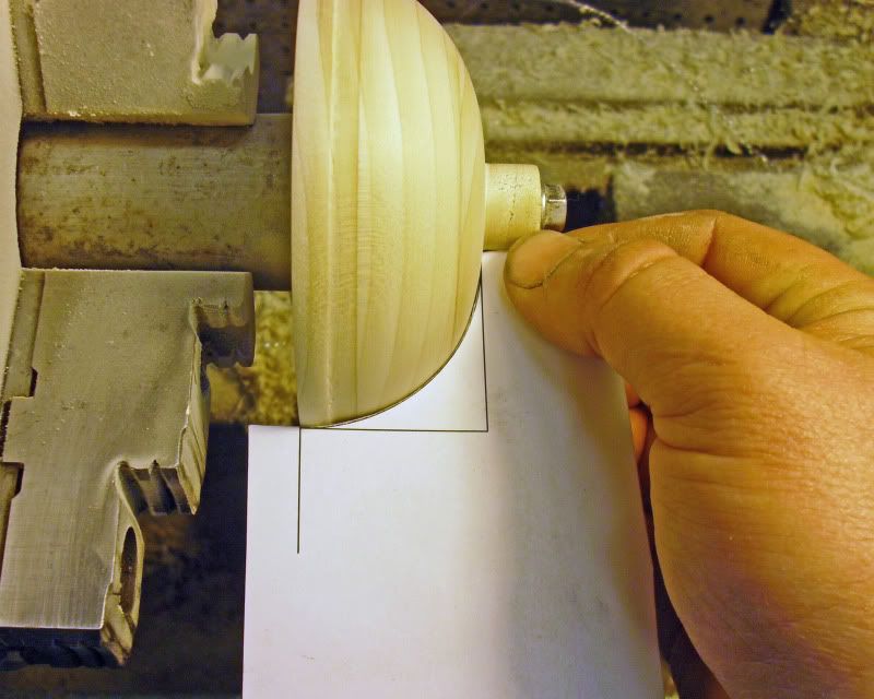

I'm thinking of making a bronze bell for my Penny Farthing that will kind of fit the antique theme that I have going. This little project will let me do a couple things that I have wanted to do. Mainly cast a bell. For some reason I have always wanted to do that? This way I will have a use for it. I will get some more experience in pattern making.  And hopefully have a useful device when done.

So, I'm thinking about casting the bell with the ornate side down and poring through a sprew in the center. Kind of like an upside down umbrella. That should work, Right?

After doing a little research, I noticed that most bells are cast right side up. I'm thinking so that the liquid metal doesn't "wash" away the sand? Thoughts?

I have some Poplar that I'm going to use. I'm thinking of gluing up 2 or 3 layers. I think this way the grains will be going different directions and will help minimize pattern warpage. I really like poplar because the hard and soft grains are about the same.
I'm thinking that I'll make the wall thickness about 3/16" I don't really have anything to go on as far as how thickness will affect the tone of the bell. So It might be a little hit and miss?

I suspect the thicker the bell, the shorter (& quieter?) the ring. Unless you plan to carry a small hammer with you to hit it with of course! I've seen them tune church bells by shaving off metal around the lip, I imagine your tuning method would be similar.

For something that small, thinner is better.  Thicker will be sort of flat, unless you really whack it.

I think they cast bells on the thick side ,,, then machine the inside to get the correct note .

Well I managed to get a little done today. I cut out some wood circles and glued them togather.
After a while the glue dried and I was able to start turning. I roughed out one side and turned a little stub to hold onto.
I then drilled the pattern a little short of the depth I am aiming for.
I then hogged a little of the wood out of the center.
I stopped here. I need to make a couple templates to machine the wood to. I'm thinking about making it slightly thick. That will pore better. I will then machine some of the thickness out of the inside to tune it. That's my plan anyway. Thanks for the input.

Got some shop time today. I need my lathe back, so I finished the bell pattern.  I drew up a template. It worked better than I thought. Here I roughed out the inside and a little/lot sanding later. It fit pretty nice.
Same with the outside. I made a little arbor that the pattern is bolted to with a central bolt. I got the thickness down to a little over 1/8" it seams kind of thick? But I was getting some chatter. We'll see if it rings after I cast a couple.
Also It will have a thinner wall thickness once I get the outside carved.
