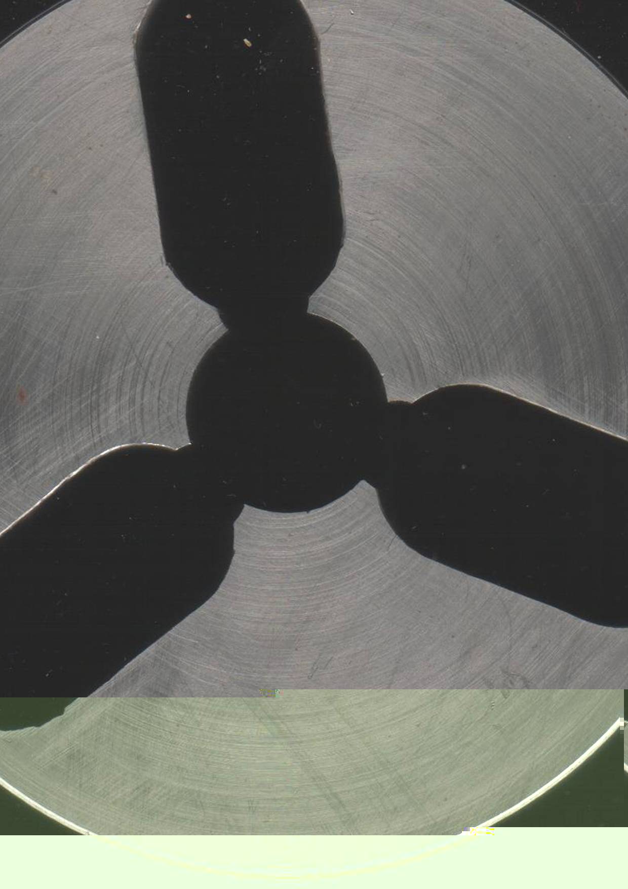

There are a couple of things that need to be done before hitting the jaws with a grinder, so if you are going to try this yourself, follow along.
The first thing you need to do is to expand your jaws until they are just inside the thru hole in the chuck. This is so that when you actually grind the jaws, they will have the largest radius on the end as you can get, they should really be flat on the end, but because we are using a rotary mounted point, we have to settle on an arc.
The next job is to make a clamping ring that just fits over the outside of the jaws. If you are to be grinding the chuck you are using, you will have to fudge things up so that you make the ring in the chuck first. What you want to aim for is a ring that is faced and bored from one side only, that will give you the optimum ring.
I found a bit of brass that was an offcut from a previous boring job, and was ideal for what was needed. You could even use a bit of thick wall pipe if it could be bored as suggested and end up with the jaw faces in the correct position.
The ring is fitted with the faced side to the chuck jaws, and the jaws are opened up until things go solid. No need to go overboard with the tightening, nipped up is just fine. You don't want to distort anything that then might get ground into the jaw faces, and when the ring is removed, they won't have straight faces, but tapered front to back.
As far as I know, Ralph has already made the ring to fit the other chuck, so it will be ready just to screw onto the spindle nose.

I was told when grinding chuck jaws you had to load up in the direction they are closing because of any differences in the scroll.
Using a ring on the outside of the jaws is forcing the jaws open but you are grinding the part the is the closing element.
We were told to put the ring inside on the bottom of the jaw teeth, doesn't matter if the ring doesn't run true the jaws will do. This way you still have clearance to get all the way thru to clean the jaws up.

I was taught to nip on a ring/ disc, held behind the working area of the jaws, inside the chuck bore.
Never thought to do it any differently.......
Re: Fixing Ralph's Chucks
« Reply #17 on: January 10, 2011, 03:44:07 AM »
John, You need to get thru with the grinding wheel so you can't grip on the holding part of the jaws or you get a step so the only part you can grip in is the bottom of the teeth of the jaws, often these are relieved back a bit which makes it easier to slip a ring in.

I was thinking the same as any backlash in the scroll is taken up in the correct way it would normally work gripping on the inside of the jaws. You could grip something right at the back and relieve it afterwards but as Bogs said, you don't need to go mad with the tightness so I guess gripping with the teeth should be ok.
Anyway, this way worked well and as bogs said, it only corrects it for the position you grip in, the rest is down to the accuracy of the scroll and Jaw teeth. Just over a thou run out is as good as it'll get I would have thought.

I have successfully reground a few chucks - mainly to rectify wear at the front of the jaws. I turn a tube with a 1.5mm to 2mm wall thickness, the OD of which easily fits into the bore of the chuck. Then I machine 3 slots in the tube wide enough for the chuck jaws to protrude through the slots. This preloads the jaws in the correct direction.
Cheers. Phil. (My 1st post - hope the photo appears.)

Many thanks for that Phil, a new technique has been learned.
A very good first post, keep it up.

I forgot to add that some clearance between the OD of the tube and the bore of the chuck is very important. If the fit is too close the tube won't be able to float to balance out the preload on all three jaws. If the slots are all the same width it isn't really a problem. I think that the OD on the three I have made is about 1mm smaller than the bore of the chuck.
Apologies for the size of the photo - I'll upload a smaller one next time.

Hi Phil,
Welcome,
Re photos, it seems size does matter!!!  :thumbup:
Your tubes work in just the same way as the disk in reply#2, two ways of doing the same thing but from different directions.
