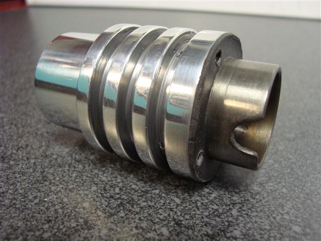

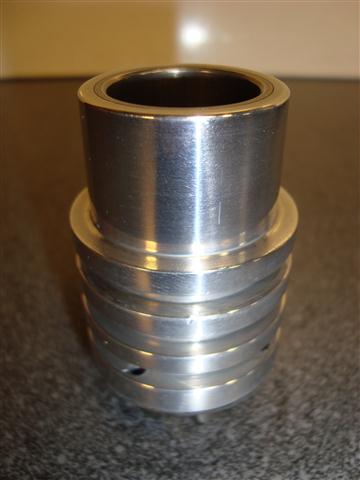

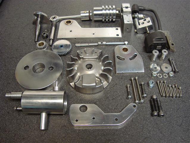

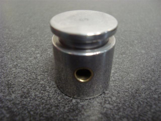

« Reply #43 on: February 14, 2011, 02:31:21 AM »
Chris,
I have just completed my webster build and I used 7/8 id x 1 od DOM for the sleeve and 1 id x 1.5 od 6061 aluminum for the cooling fins.  I also used 6061 t6 for the piston with a 7/8 viton o-ring.  It has about 10 hours on it and is going strong... I have even had it up to 4000 RPM for 10 minutes at a time, but it gets pretty hot.  Here are some pics to help you out...
Doug
