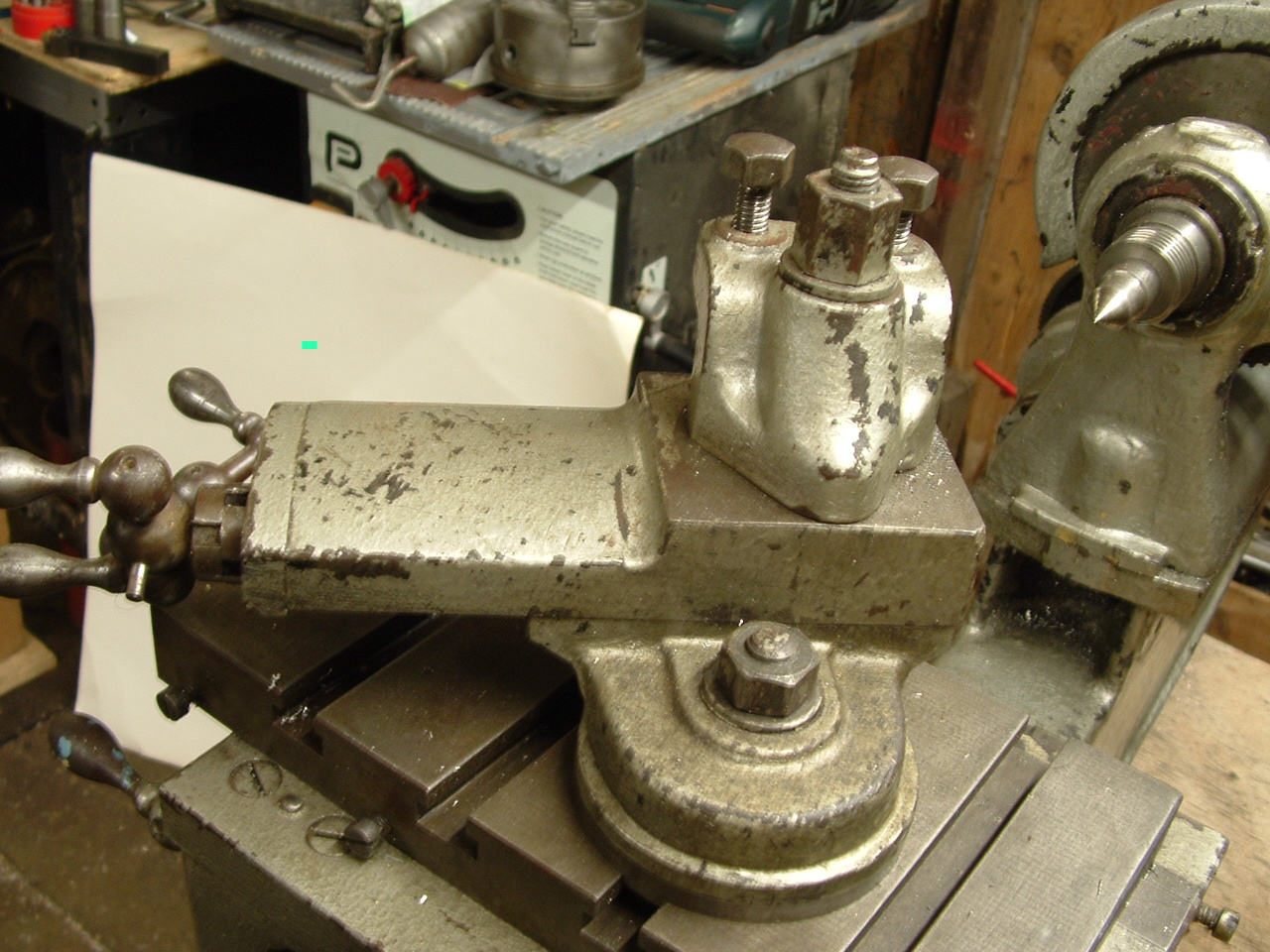

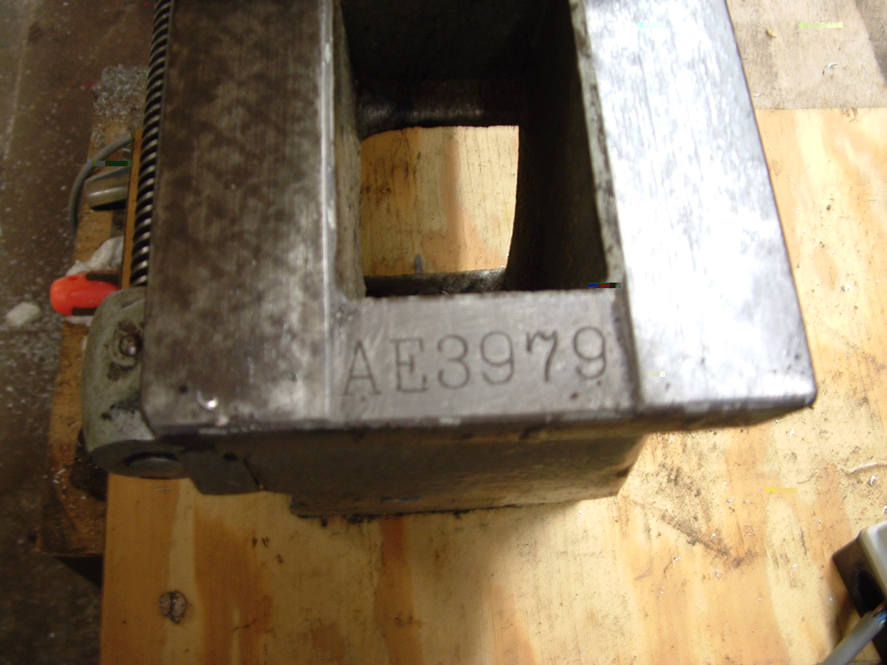

« Reply #9 on: December 26, 2010, 06:04:44 PM »
A few more views.
« Last Edit: December 27, 2010, 07:02:09 AM by DavidA »

That's a big serial number, if the AE3xxx is generic (is it about a 6" swing?) , that's a thousand lathes, so someone, even all these years later, should know of it. So, is this not English?  (I'm thinking Colonial, perhaps Austrailian, Indian etc.).
Is it about 9" between centres? if so, maybe the AE39xx is generic and only hundred or so were planned (which would seem to lack ambition).
The AE could, I suppose be the manufacturers initials.
Intriguing :)
« Last Edit: December 27, 2010, 08:23:57 AM by BillTodd »
Re: Unknown lathe
« Reply #11 on: December 27, 2010, 11:48:44 AM »
Bill.
I'll go out and check later,  but it's a lot more than 9" between centres.  more like 24".
I wondered if the AE was A Engineering.  don't know what the A stands for.  Atlas perhaps ?

Now we can see it a little closer up, it gives a lot more clues.
This is no cheapo lathe being made, it shows some classic signs of being built to fairly high standards.
Serial number.
Hand scraped bedway.
Dovetailed slides with good ajustment points.
Fully articulated tailstock.
T-slotted cross slide.
Adjustment on cross slide and compound handles to take out backlash.
Dowel pinned apron.
Adjustable bearings in the headstock.
Tumbler reverse for leadscrew.
Ball oilers on each lubrication point.
This all points to a quality engineering lathe designed for accuracy, versatility and longevity. Not the usual run of the mill 'last for a few years and throw it away' jobbies being produced at the time.
Bogs
Location - Crewe, Cheshire
Skype - bandit175
