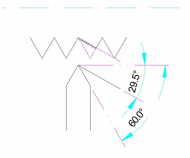

John, I'm feeling a bit stupid, because I don't understand that  :scratch: . I can see that it gives finer control over the depth of cut. But I should have thought that increasing the depth of cut using a topslide set at just over 30 deg to the lathe axis (rather than just over 60 deg) would result in a thread with its LH flank correct but the RH flank wrong - a lopsided 90 degree thread. If it's not too much trouble, would you explain a bit further so I can grasp how it works?

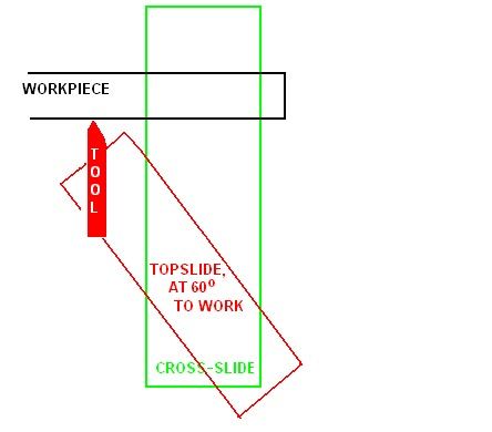

Nor can I understand it, given the good description at 3:40 into the video, which relates one of the normal methods very nicely. With the compound slide set as shown the resulting thread form will be like the pic below. The purple is what you would be hoping for, but the saw-toothing on a right flank and reduced peak on a left is what you will get.
It's not a question of a fine thread or otherwise, it's a geometry issue, just at a different scales.
You can leave the compound parallel to the spindle axis and apply half the infeed to that and the resulting tool path is near enough the same as with the rotated compound method (arcTan0.5=26.6deg from the cross slide), but that is not the description here.

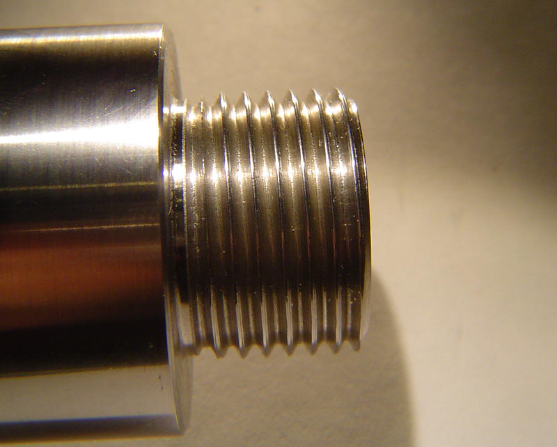

I should have stated on the vid that the last cut was made on the cross slide (only about 5 thou )
I have looked at the thread through a magnifying glass and it is as good as the thread on the nut.
Hope this helps

You seemed to have set the compound at 29 deg from the spindle axis as I tried to show in my sketch, not 29 deg from the cross slide axis as shown in your scans. Maybe I've got the wrong end of the stick because your threads look fine.
Richard

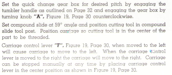

This scan is taken from the boxford hand book
the angle is 29 deg

Maybe I was making things worse, I'm not worried about whether it's 29 or 29.5 or 27.5 deg, but where the degrees are measured from.
From what you are saying, when your compound slide is parallel to the cross slide, the degree scale must read Zero. On my lathe the compound reads Zero when it is parallel to the spindle axis. There's the difference/confusion.
Richard

Re: Metric Thread On Imperial Lathe
« Reply #20 on: December 19, 2010, 12:12:32 PM »
That means the boxford hand book is wrong :( :( :( :( :(

I agree with Richard. It all depends on how the scale is marked up on the lathe. In the video, the compound is angled 30° off parallel to the spindle axis, where it should be 30° off perpendicular. My lathe is the same I have to set the scale to 60° (or actually 60.5) for a metric thread. The way it's set in the vid will give a 91° angle thread rather than a 60.
Yes, On my Hardinge it is 59°

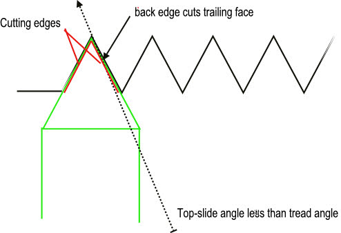

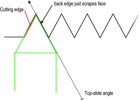

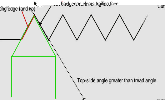

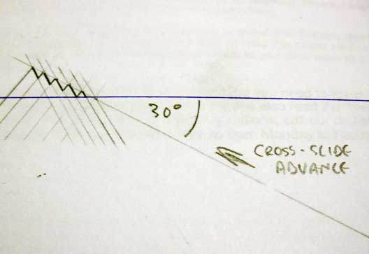

I think the difference (and thus confusion) is down to how the trailing side of the thread form is to be cut.
If the top-slide angle is less-than the the thread angle ( i.e 29.5° for a 30° thread) then the trailing edge is cut by the back edge of the tool.
If the angle is greater than the thread angle then the trailing edge is cut by the tip of the tool, (as the back edge clears the face) and is thus defined by the angle of the slide.
If the slide is set to exactly the thread angle, then the cutter just scrapes the edge.
« Last Edit: December 19, 2010, 01:17:15 PM by BillTodd »
Regards
Well it's not really 'wrong', just rather ambiguous. It says '...set at an angle of 29 deg...' which a legalese pedant would argue is not quite the same as saying 'set the compound slide so that the scale reads 29deg.'
It is very poorly worded, but at least we've got to the bottom of it.
Richard
Bill,
your first drawing is essentially the same a mine. I showed the saw toothing as a result of each successive cut taken - rather coarse I accept, but it was intended to accentuate the effect. I agree with your other two drawings, I was just too lazy to bother....
Richard
For every fool-proof solution, there is a fool greater than the proof
Yes it is, Richard. Sorry I missed that first time through :)

Actually now I think of it what you produce using a 30°-off-parallel angle for the compound is a saw-tooth pattern on the right flank of the thread because the angle you're advancing at is shallower than the angle of the cutter. My CAD skillz are lacking so I'll knock-up a quick pencil-sketch.
« Reply #29 on: December 19, 2010, 01:58:55 PM »
Ned I don't agree, if the tool is not loaded both sides what is cutting the right flank of the thread? I see feeding directly in exactly the same as plunge cutting except that you are continuing the plunge cut along the length of the thread, a 'running plunge cut' for want of a better term.
Anyway, here is my crummy sketch depicting the result of feeding in at 60° off perpendicular.

Here's a 1" 12tpi thread I cut the other day (@ ~400rpm with a full depth insert in BMS )
You can see the striations caused by the each pass. However, although it is cut at 31° (59° on my top slide), there are no obvious steps on the trailing edge (right-hand side).
[edit] Actually, now that I can see the tips clearly, it looks like I've over done the in-feed (or picked up the wrong insert??) . As it happens I'm going to have to slice off and re-cut the thing as a dual start thread (i.e. 6tpi) as soon as I get the appropriate change gears for the lathe.
« Last Edit: December 19, 2010, 03:02:33 PM by BillTodd »

as you say, it looks fine. A 1 degree error is a near miss, but we were initially talking about a 31deg error and that would make a significant difference.
The saw toothing may be less obvious depending on the tip radius of the tool, but the reduced height of the thread profile would still be the same as each successive cut removes a little more of the crest with the trailing edge of the tool.

Thanks for taking the trouble John, I'm very curious to know how this comes about. One aspect I had not included in the sketch I did before was the shape of a real thread which has a clipped top and a radiused root, both of which reduce the effect, but I still can not see how your result comes about.
Here is a notional 60 deg thread with no flat top and no radius:
This is a single groove made with a 60 deg tool fed in at 30 deg from the spindle:
and this is two adjacent grooves on a 1.5mm pitch, showing the clipping at the top of the form:
That makes no allowance for the flat top or root radius and is the form I was using previously. Not strictly accurate I know, but it domonstrates the point of discussion.
This is a true thread form with a flat to a depth of H/8 and a root radius at the full quoted depth of 0.92 (both figures taken from a Zeus book):
This shows the top again clipped, but by a reduced amount of 0.33 because part of the top is already removed by the flat and the root radius also reduces the amount removed.
Can anyone shed light on why this appears not to be reflected in the thread actually cut.
Richard

I’ve been puzzling over the remark which Bogs made before his data got lost, and have come up with these approaches to “going in at an angle”.
Method 1. The diagram below shows how I normally set up for threading, with the topslide set at 60º to the work and at 30º to the cross-slide (actually 60.5º or 29.5º, but I’ve rounded them off). Depth of cut is applied using the topslide.
Method 2. The diagram below shows the set up for threading when applying depth of cut with the cross-slide, but also shifting the topslide (and thus the tool) towards the headstock a little between each pass to produce the angular feed effect. The rule of thumb seems to be that the topslide is shifted left half the amount by which the toplide has been fed in.
Method 3. The final diagram below shows the situation which seems to have caused controversy.  The topslide is at 30º to the work and at 60º to the cross-slide. This set-up could be used to simplify the “cross-slide parallel to the work” method. Trigonometry shows that advancing the topslide when it is set at this angle will advance the tool into the work by half the amount indicated by the topslide dial. So in this case the cross-slide and topslide can be advanced by the same amount as shown by their dials to produce the same result as Method 2 with its parallel topslide. This avoids the bother of remembering by how much the cross-slide has just been advanced and then advancing the topslide dial by half that amount. Each dial is advanced by the same amount in Method 3.
Am I on the right track. or have I got myself completely lost?

« Reply #47 on: December 20, 2010, 08:50:01 PM »
Hi Andy,
What an interesting idea, and  yet another method.  :D
Going back to the original post, the following You-Tube was pointed out on the ME site today. Alright, it is yet another video on threading and perhaps it is a touch long, there are five videos for the one thread, but I always like to watch others working. Oh, and it does seem a bit like an advert for tips and oil.
Method 3.
<....> The topslide is at 30º to the work and at 60º to the cross-slide. <....>Trigonometry shows that advancing the topslide when it is set at this angle will advance the tool into the work by half the amount indicated by the topslide dial. So in this case the cross-slide and topslide can be advanced by the same amount as shown by their dials to produce the same result as Method 2 with its parallel topslide. This avoids the bother of remembering by how much the cross-slide has just been advanced and then advancing the topslide dial by half that amount. Each dial is advanced by the same amount in Method 3.
Andy,
Your trig is correct, but the scheme is that all feed is made with the topslide, other than a very fine final cleaning cut taken as a plunge striaght in. The cross slide is withdrawn after each cut and then returned to the same place on the dial each time (conveniently zero) before the next cut is taken, the feed being made with the top slide.
It is well established practice to use a compound slide at a fine angle, often 6deg as the trig works out to a convenient 1:10, for taking very fine cuts or when using a tool post grinder.
As a very near approximation to 127 you could use a ratio of 80/63 = 1.26984 which really is very close, only 16 parts in 127000 error. That may be the near miss you were referring to, it is fairly commonly used within the standard set of Myford gears I believe, 'though your gear set may well be different.
Richard

I think i can finally put this thread  :D :D :D  to bed
I had a visit from Rob Wilson today naturally the subject of screw cutting came up .
Rob in less than a minute showed me a very simple way of checking the compound slide angle.
The tool was simply placed on the compuund slide at 90 degrees to the lathe bed (as it would be to make a cut)
the compound slide should be at the same angle as the trailing egje of the tool.
this picture has the compound set at 30 deg as you can see the tool trailing edge is not the same as the compound :( :( :(
this picture has the compound set at 60 deg the tool angle and the compound are the same :) :) :) :)
The video will be edited
I have one more chuck to make i will be using the 60 deg mark
Regards
Offline Ned Ludd
  • Posts: 207
« Reply #59 on: December 21, 2010, 08:16:41 PM »
Hi John,
When you next cut a thread, will you let us know if you think it cuts better than before, then you can put the issue to bed. If after four pages you don't find it to be better, it would have been better to have kept my mouth shut or at least let my keyboard rest.   :D
Ned
Leafy suburbs of NW London
« Reply #61 on: December 21, 2010, 11:28:35 PM »
John thanks for the follow-up. It's always good to get a fresh set of eyes on a job.
Your video is one of the better ones and very clear and easy to follow, lots of people will gain confidence from it. I like your bronze casting ones too.
