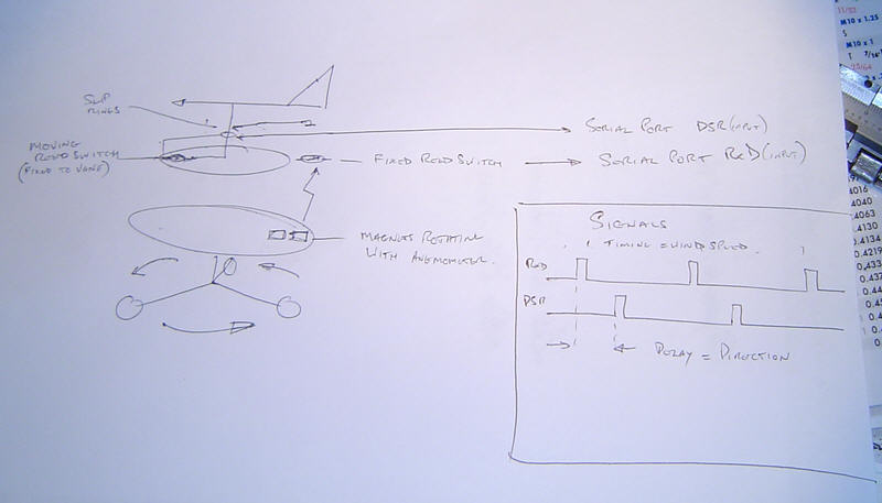

  • Posts: 1179
Re: Concept for anemometer......
« Reply #8 on: December 20, 2010, 01:42:17 PM »
How about....
Two magnets (or a light source) attached to a disk that rotates with the anemometer.
Two reed switches(or optical sensors), one fixed to body operated by one of the magnet, one rotating on a disk moving with the wind vane operated by the other magnet.
The output of the fixed switch (or sensor) can be connected to the Rxd (data receive) of a PC serial port, Each time it is activated it will generate a comport interrupt , which can be counted and integrated to give the wind speed.
The output of the rotating vane switch can be taken to another serial port input (e.g. DSR - data set ready ?). The software has to time the delay between the RXD interrupt and the DSR pulse to determine the wind direction.
BTW this is not a new idea  I saw this scanning system in a anemometer some years ago in an electronics mag.
[edit] it occurs to me that there might be a way to channel the magnetic field (or light) to the centre of the vane thus avoiding the need for slip-rings and a second magnet.
« Last Edit: December 20, 2010, 02:43:56 PM by BillTodd »

  • Posts: 1179
« Reply #19 on: December 23, 2010, 10:05:32 AM »
The principle problem with using a keyboard is the way its input is handled by the operating system. In a multi-tasking system like windows or linux the key inputs will be passed to whatever application has the current focus, so unless you are prepared to dedicate a pc to the task of wind speed monitoring, it's not an idea solution.
Serial inputs (com ports) are useful because the driver usually takes care of unused data without causing too many problems. Parallel ports (printer ports) can also be used but usually require some extra hardware knowledge. Sadly both ports are disappearing from new machines, as they are replaced by USBs.  USBs requires a ridiculous amount of software at both ends to use natively (i.e. as a Human Interface Device), but at least there are cheap USB-serial adapters that turn them into comports.
