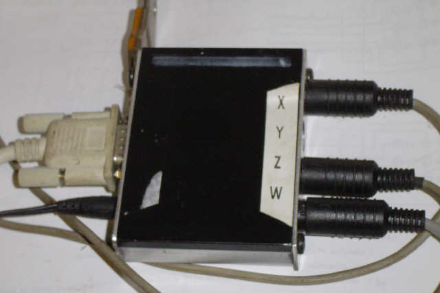

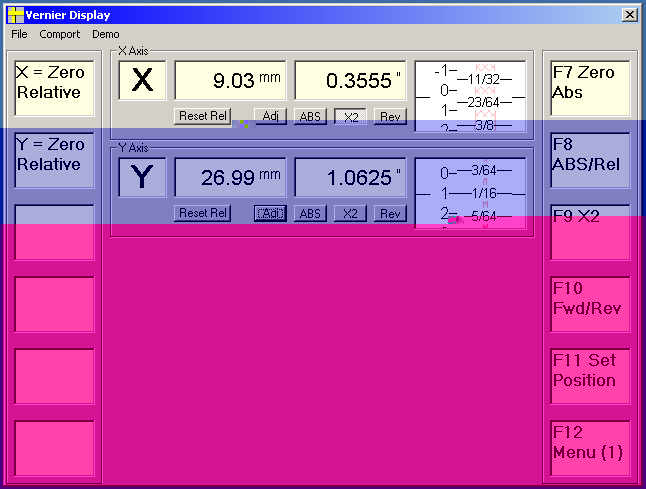

I had two cheap digital verniers on my old SB9 lathe for quite a while and have since  fitted them, and a third, on to my drill-mill. I'd have to agree with John about the importance of keeping swarf and coolant out (and way-oil as well) some kind of cover is essential.
I have hard-wired the reader heads to 2m  long leads that plug into to a home-made an PC interface so I've also removed the display parts from the scales and covered the reader heads in screening foil. The scales are powered from the interface.
 I have a dedicated PC running as a DRO display, running a Visual Basic application giving Metric/Inch and fractional inch read outs simultaneously (which I find really useful)
I've published details on various forums, but if any one is interested I can always post them here.
