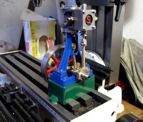

Thank you all very much for your kind thoughts,
i have painted the 10v, with what paint i had to hand,
just the cylinder cover to put on.
Ray.

Re: stuart 10v build
« Reply #83 on: December 12, 2010, 11:31:50 AM »
Very nicely done Ray, a real credit to your machining skills.
It always baffles me why these engines with a large flywheel don't have an outrigger bearing to take the weight of that heavy spinning lump. It seems to me that the bearing closest to the wheel will wear away in no time due to the downwards moment being inflicted onto it by the crankshaft having all that weight hanging out in mid air. Not only would it stop the bearing wearing away, to me, it would look a lot more robust as well.
Maybe a thought for future builds.
Bogs

« Reply #85 on: December 12, 2010, 11:40:51 AM »
Ray
quick question. Im in middle off a 10v build. Have you put a steam incoming port on both sides off the cylinder? As I understand drawings there should only be a port on the right side of the cylinder. Which looking at the video off your engine running looks to be where you've connected the air line. But there also appears to be a fitting on the left side off the cylinder ( side facing us on painted engine photo). Engine looks great BTW. Hope mine turns out anything like as nice.
Mat

« Reply #87 on: December 12, 2010, 02:15:45 PM »
Hi Mat  :wave:, looking at the photo the one on right is the steam chest inlet and the one on the left facing you is the exhaust outlet,
Ray

« Reply #91 on: December 14, 2010, 04:26:56 PM »
Ray
hi Ray
 :doh:  totally forgot the exhaust had to go somewhere andnt got as far as looking at the steam chest drawing yet. Was thinking inlet went into cylinder  :hammer:
Having thought it through now understand how valve works a lot better :D
Mat
