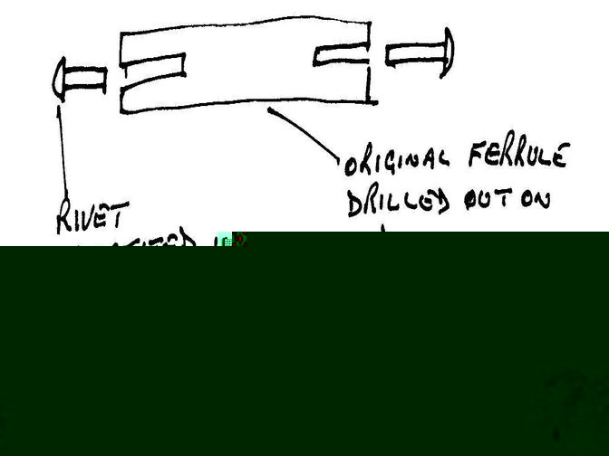

Offline Bogstandard
  • Bogs Group
  • Posts: 1107
Re: Tiny BA fasteners/studding
« Reply #6 on: November 23, 2010, 01:41:37 PM »
Bry,
Why not just buy something like 1/32" copper snap head rivets, or brass escutcheon nails (in fact I still think I have some of them knocking about from my model boat days), and fit them like shown in the C-o-C below. You could even get them plated to match. Once assembled with loctite, they should never move.
Bogs
Location - Crewe, Cheshire
Skype - bandit175
Offline bry1975
  • Posts: 417
    • http://www.satintime.co.uk
« Reply #7 on: November 23, 2010, 01:48:12 PM »
Thanks for the rivet idea Bogs I hadn't thought about that must be my young age (34)  :D
Probably have them DLC'D if it's possible.
