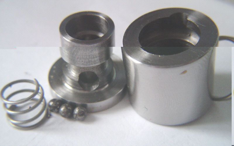

Bringing it back on topic....
I made a keyring sized one from 316 stainless steel
I'd show you inside, but i can't get it apart  :D
« Last Edit: November 19, 2010, 09:29:19 AM by BillTodd »
  • Posts: 2913
Re: Cylinder Puzzle - Finished Weekend Project! (lots of photos + plans)
« Reply #46 on: November 19, 2010, 10:26:28 AM »
Haha ! That is brilliant!
 :bow: :bow: :bow: :bow: :bow:
Why can`t you open it - have you forgot the alignment or is something catching inside? I know I had a slight burr on the top edge of my groove which was originally making my first puzzle a bit tricky. I sanded it off but actually in retrospect quite liked it - made it a bit harder to open!!
I hope you can get it open soon - please post pics when you do!  I originally wrote, what size are your balls? But I think it would be better worded - what diameter ball bearings did you use for that?
  • Posts: 2913
« Reply #47 on: November 19, 2010, 10:27:38 AM »
Just looking at the pics again - are the balls a little small for the groove only you have got quite a big rise on that of the lid?
  • Posts: 1185
« Reply #48 on: November 19, 2010, 10:59:03 AM »
 :lol:
I started to cut the grooves to suit 4mm balls then realised I didn't have enough meat in the plunger part to make them deep enough (I was just making it up as I went along), so I'm using three 3.5mm balls  running in ~4.5mm long grooves, hence the gap. I don't mind the gap, being able to see the hole and notch doesn't make it any easier to get apart.
It will come part (at least it did before I fitted the spring)  ....
[edit] I've just noticed those balls are Kn****d, I might have one more go at the groove to fit 4mm balls
