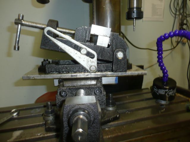

Hello,
I decided to make one of these tangential tools after seeing plans in Model Engineer's Workshop.  I used a vice on a vice to cut the compound angle on the mill. Not a rock steady set up but it works with light cuts.
As the plans in the magazine were for a different size lathe to mine a went through a MAD process (MDF Aided Design) to get the right size.
This is my first attempt at tooling so I am very happy with the results and it produces a great finish.
Saved a few bob and as they say "Works like a bought one"!

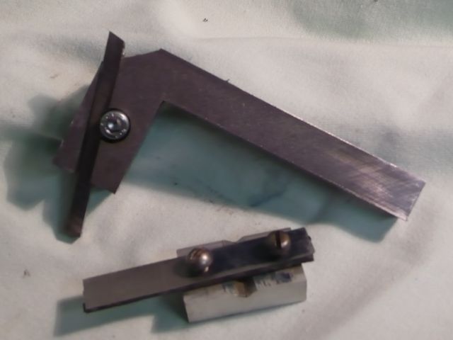

They are certainly not a new idea and I would guess that the "patented" bit is only for the sharpening jig, as the basic idea would not be eligible for protection, due to it being public knowledge.
I have made both the Australian Style jig courtesy of Mr. Rick Kruger's drawings and the simple Vee style at 30 degrees. I find the simple jig to provide a better edge than the other one. I assume it is because of the direction of the striations, from the wheel, are in a better orientation for cutting, much like of a pair of scissors which only work properly with cross striations which grip the thing being cut. The Australian style jig does work marvellously for sharpening thread cutting tools.
There are many different ways of getting a good finish and a Tangential tool is merely one of them. Personally I love the Sumitomo T1200 Cermet tips but I am sure that many other manufacturers produce something nearly as good. The point about a Tangential tool is that it is an incredibly cheap thing to make and maintain. It is the most efficient way to use HSS, as it is only ever sharpened on the end, thus saving all the wastage caused by grinding on three sides.
