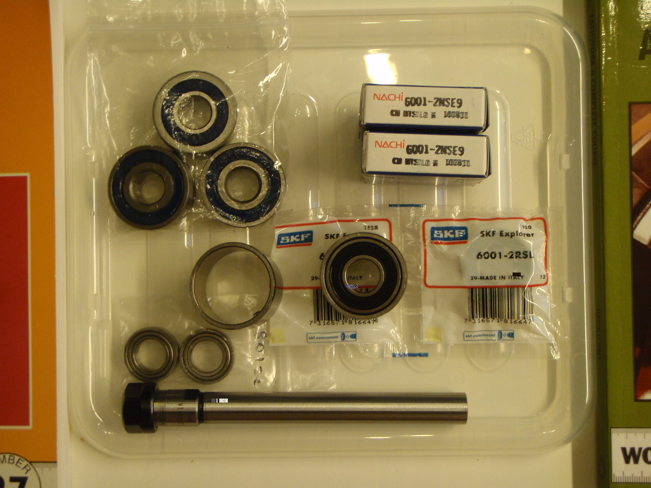

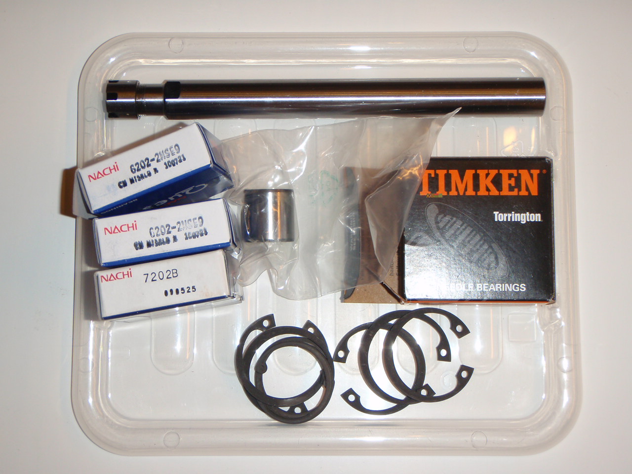

I have read that often people complain "import" collet sraight shanks being too "tight". This would have been ideal for me: I was planning to press 12 mm ID bearing to nominally 12 mm straight shank.
I got two ER11 collet straight-shanks
http://www.ctctools.biz/servlet/the-334/ER11-12MM-STRAIGHT-SHANK/Detail
It looked promissing, but only tail of the shank was tight, collet end was way too loose (miked something like 11,97 - 11,98 mm). BLIZNAK!
THE BUMMER:
I rather avoided making the spidle shaft, now I have to decide:
* Ordering one oversize ER11 collet straight-shank 1/2" for 12 mm bearing ID or chopping one 16mm shank for 15 mm bearing ID. Problem: how to center (ready shanks have about 7 mm hole straight trough? Collet end could be located, but probably would need a steady for the other end.
* Fabricating one with ER 11 cavity and M13*0,75mm thread. Never tried this sort of taper turning excercise. Does not look overly easy.
* Could make spindle shaft for JT2 or B12 taper drill chuck, this I believe could be doable.
* Could make spindle shaft 1/2" 20 tpi (or chuch) drill chuck. Never tried imperial threads. Should be even easier and better chance for immediate success, providing I have gears for this thread and the thread angle is 60 decrees, I don't have 55 decree threading tools.
I talked to one design engineer who is well versed with bearings. He gave me some pointers and chucked me one SKF manual that should be great for self defence: It weights least four kilos. I got the drift:
* I can have it with few parts (but fiddly to adjust) or I can go bomb sure, but higher count of parts and more features to machine. I think I'll play it safe.
* I might be better off without thinking formal fits and geometrical form IT6 etc. Just have to do as good as I can and hope its tight under load where it should be and close to sliding fit at the free bearing end...
* Have to prepared to build it over few times....
