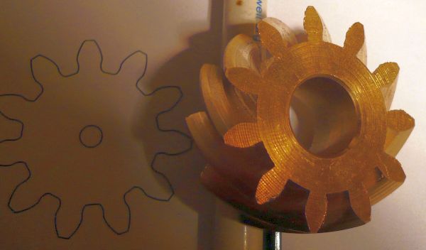

Not a great picture, the white nylon doesn't help but I'll redo it later on brass or similar. Main thing is it shows the operation, the cutter blocks a slot out and then by using all 4 axis at the same time it moves away, raises the cutter and rotates the 4th axis so each pass is at a different angle and part of the involute. You have the choice of selecting how many passes per tooth.
But because specials cutters are not needed it's now very easy to modify gears to fit an application. I cut two 14 tooth gears to text book specs, mounted then on two pins the required distance apart and they ran perfectly, I then made two more identical blanks but cut 13 on one and 15 on the other.
You can swap these in any order and they run fine. Helicals are still a work in progress, they work but the tooth shape is not correct yet.

Is there any faceting of the tooth surface?

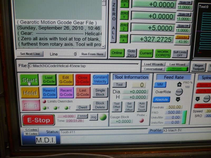

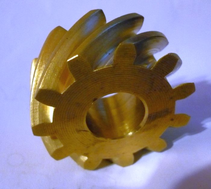

Setup and did a 2.5Mod 11 tooth 45 degree helical today.
Came out perfect, checked it on the gear verniers and it was within two thou of where it should be.
51 minutes with a 3mm end mill running at 500mm/min - proof.
Elapsed time is next to the EStop button
Video here http://www.youtube.com/watch?v=OI8f6Lrwx00
Watch from 2.08 until 3.01 and you will see how it steps over in the Y and the 4th axis follows it to form the involute in a series of discrete steps.
You can choose how many passes it makes to facett the flanks, default is 10 but I'm running lower for testing to trade speed for quality although even at 8 they are coming out very well,
