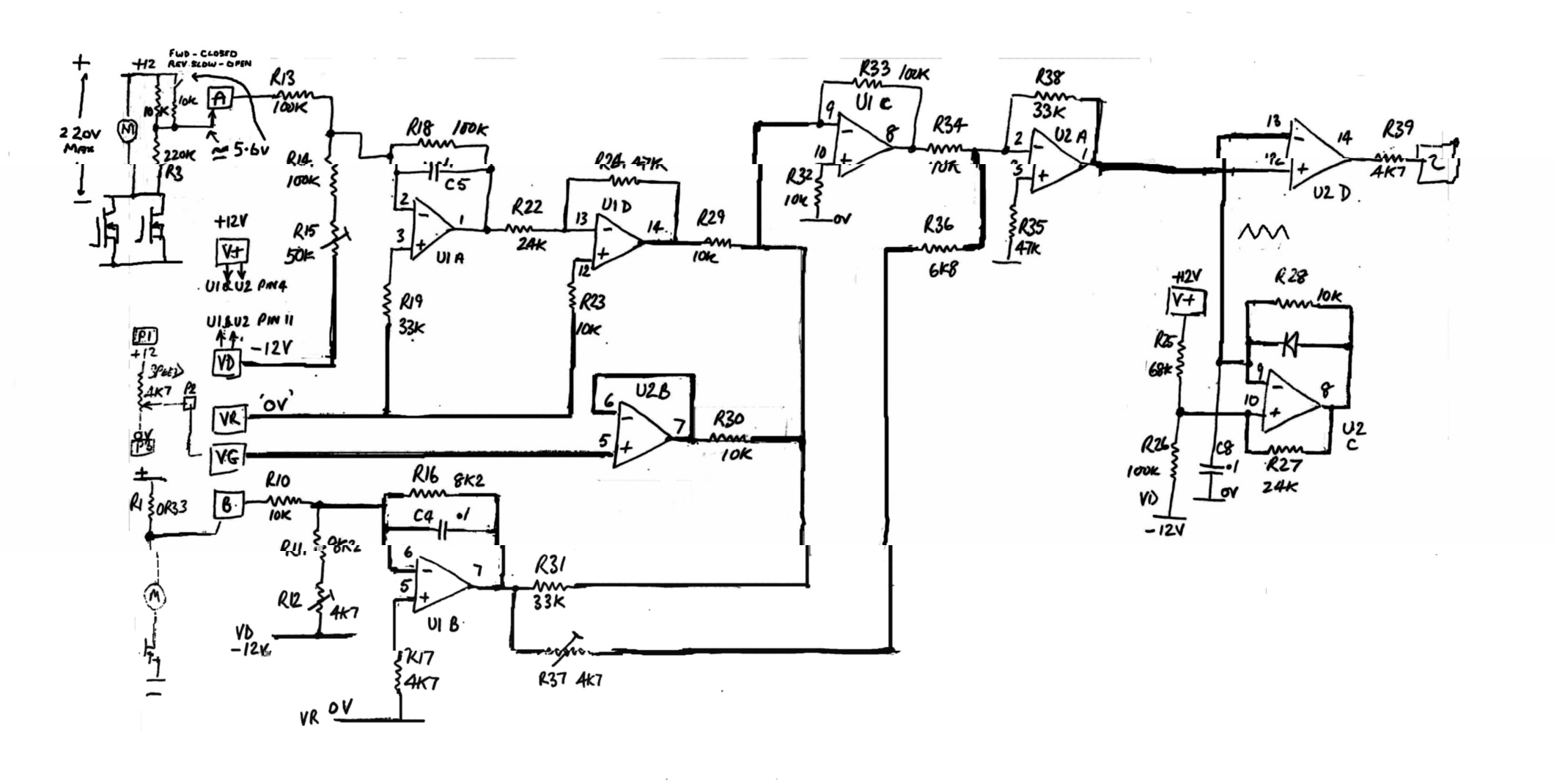

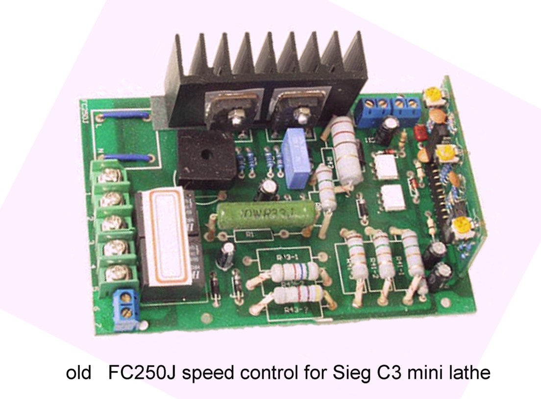

several months ago I reverse engineered the FC250J board in my Clark CL300M lathe
(its a Sieg C3 mini lathe)
the latest version uses a XMT.... series controller  that I think has been used in some mini mills
If your control pcb looks like one of the pictures
I'll send you the info I have

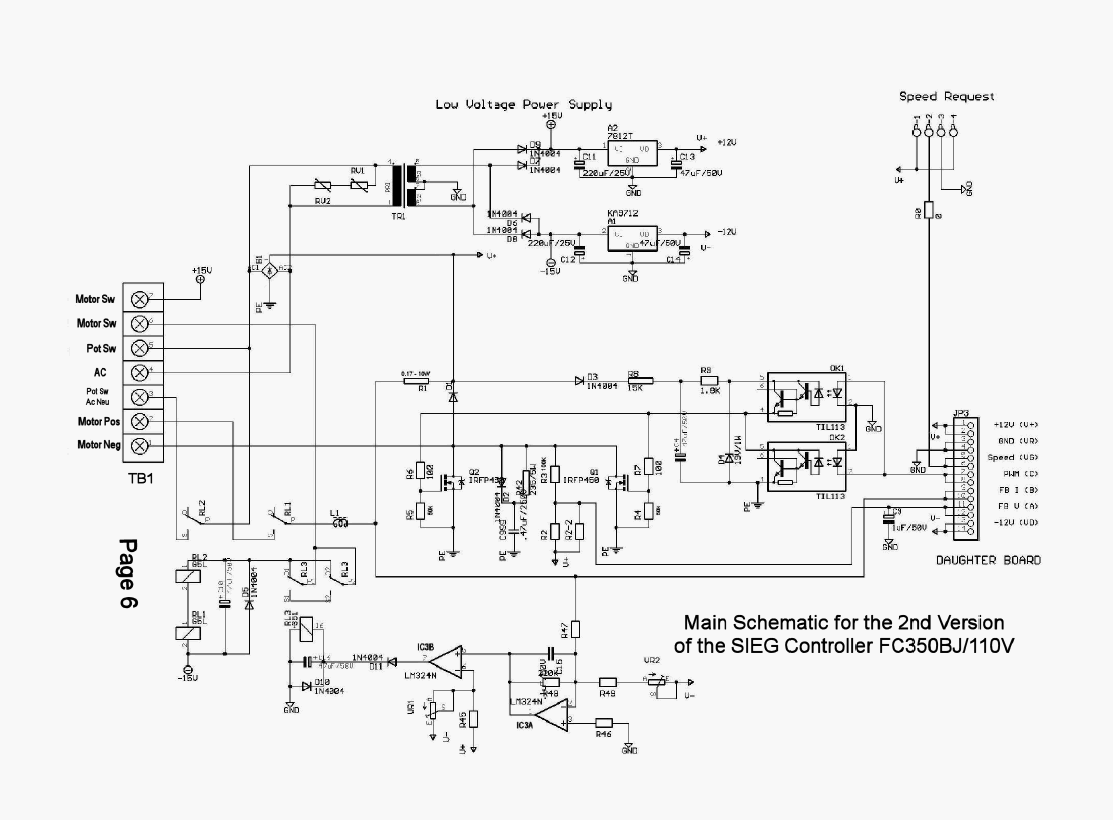

I have had a look at the manual for your lathe

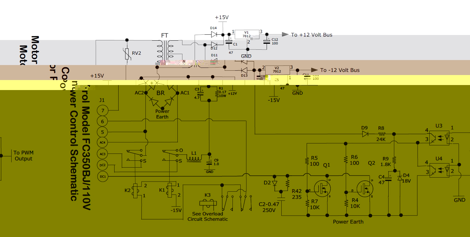

the nearest to the FC250BJ/110v  controller you have I can find on the  web is
 that circuit for a FC350BJ/110v
hope this helps

Thanks  a billion for the info. The photo of the board looks exactly like the board in my lathe. I'll have to take it apart to be sure, but it is very similar.

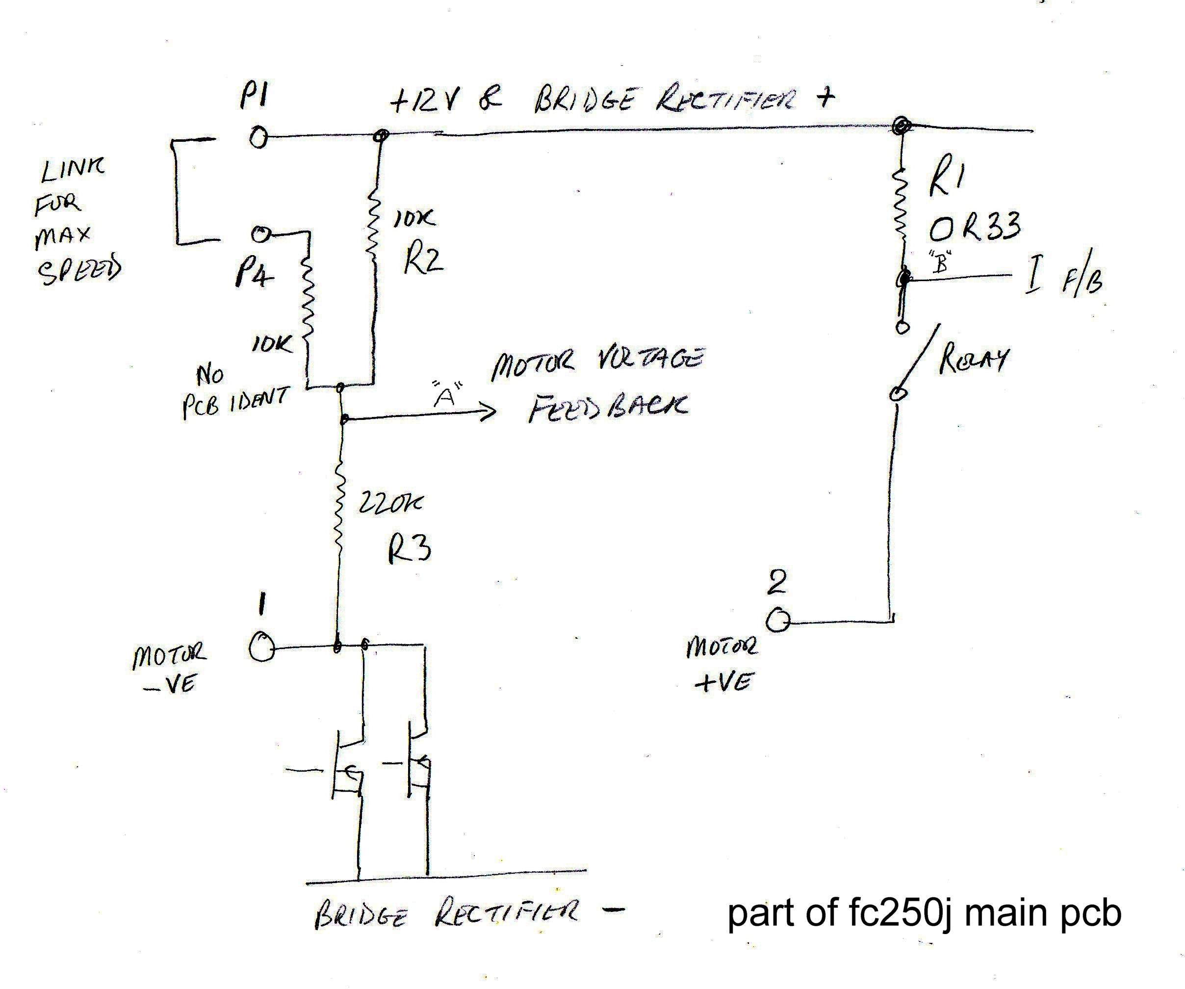

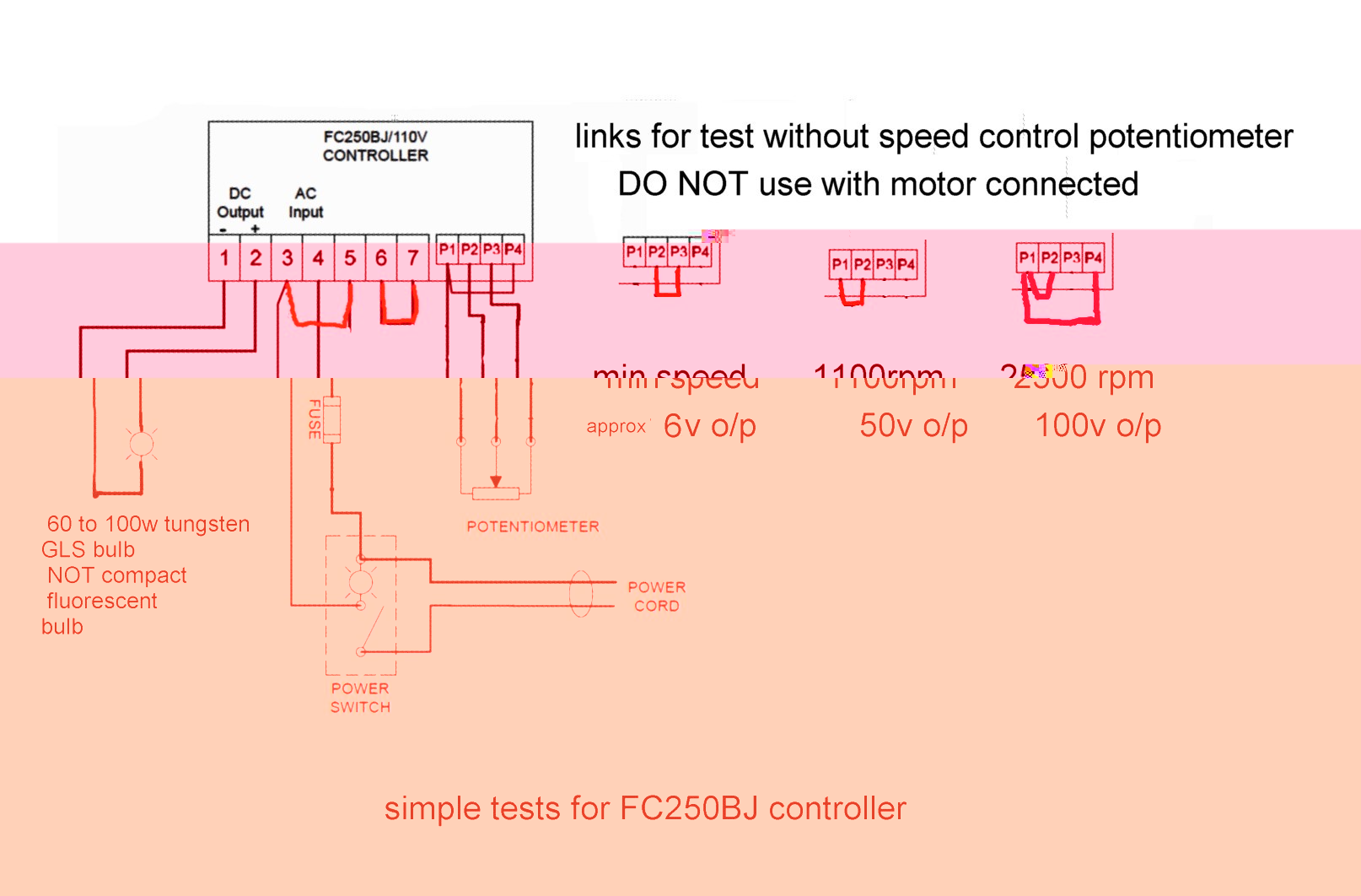

 If you need to test the speed control pcb , try this test circuit
I have used it when working on my controller
ps the motor brushes are not too short are they ?  new ones are about 0.55" (14mm) long

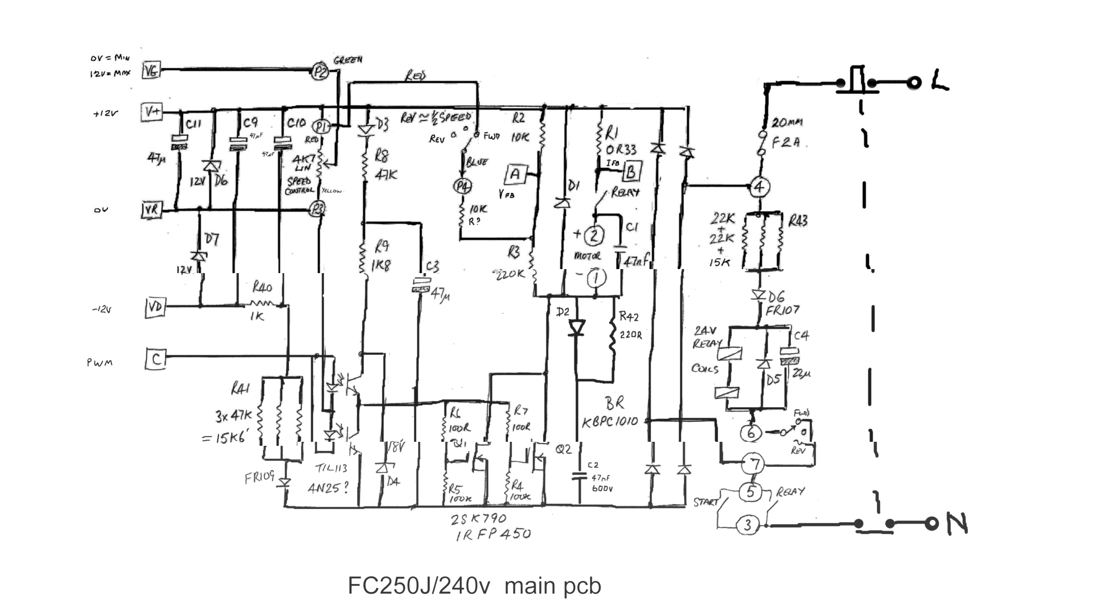

pps not sure of circuit downloaded for FC350BJ   (fc350 3 in earlier previous post)
on my FC250J/240v  pcb terminal P4 is connected to a 10K resistor , not to P1
linking P1 and P4 or not , changes the level of the motor voltage feed back
on my lathe the maximum speed in reverse is half that in forward
see "part fc250 main pcb"

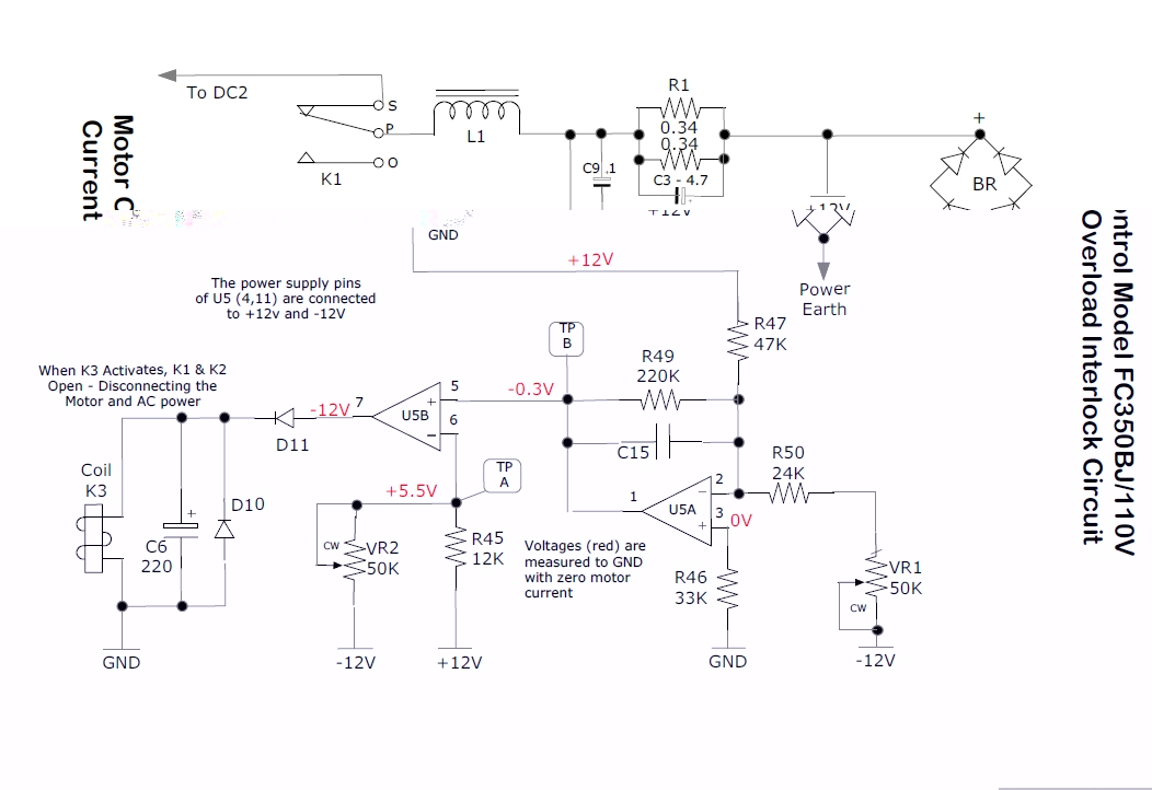

   even more info
the circuit of my FC250J/240v control looks like a cutdown version of
your control without the overload protection circuit
« Last Edit: September 26, 2010, 01:52:54 PM by John Swift »

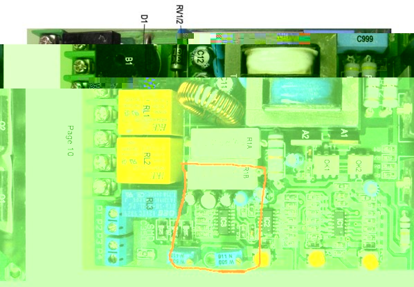

I took out the PCB today, and it looks like the damage is more than I first thought. There is a row of pots along one side of the board, and between VR1 and VR2, I noticed a sooty deposit around the SMT resistors, and one small electrolytic cap has a blown pressure relief on top. I'm thinking now that I should try to replace this board, and tackle the repair when I have more time. You have some great information though, thanks again

if you have not had much practice with SMT boards , get an old computer board to practice on first
my board and others I've helped on the model-engineer.co.uk forum   , have had faulty capacitors
(thread :-  speed control pcb for clarke cl300 lathe)
some measure ok for capacitance but the ESR is high ( several ohms instead of half an ohm at most)
with luck the deposit is from the capacitor ( is it C9 a  1uF 250v electrolytic  by any chance ? )
if its one of the one's I suspect , it's been heated by R1B in the photo (0.34 ohms  5w)
hot capacitors have a short life  - i've changed a few in  switch mode power supplies inside of  TV set top boxes and LCD monitors
the electrolytic capacitors are easy to replace
the SMT components under the protective laquer are more difficult
   good luck
« Last Edit: September 27, 2010, 06:24:09 AM by John Swift »

I just saw your pic, and the cap that blew is the one to the right edge of the red box (C12). The board you show there is practically identical to my board, and the sooty deposit was over the SMT resistors in the box. If I can't find a replacement, I may just go in and change all the IC's and hope for the best. I do work with a lot of electronics stuff and feel capable of repairing this board, but most of the work I do is thru hole.
Thanks again for all the info

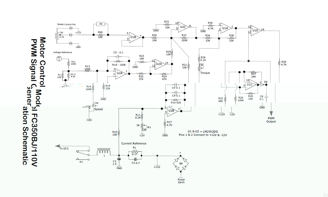

  I think I have identified your board
the capacitor is on the output of the +12v regulator
I've captured the web address from my screen
for some reason I failed to copy it to this reply
(the info is from John Gerling at Gerling laboratories)
the only problem in changing the LM2902 / LM324 quad op amps
will be if the pcb laquer has glued them to the board
« Last Edit: September 27, 2010, 02:19:02 PM by John Swift »

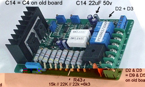

just looking at the two versions of the FC350BJ controller i've downloaded
it looks like in one version the capacitors on the input and output of the regulators
have been exchanged.
is it the one of the circuit diagrams thats wrong or one version of the pcb ??
looks like one pcb !
usually the capacitor on the input side the capacitor is the larger of the two
see the pictures
« Last Edit: September 28, 2010, 05:08:29 PM by John Swift »

the only danger with a small reservoir capacitor and a large capacitor on the output
is when the stored energy discharges the wrong way through the regulator
the protection diodes shown in the diagram are also helpfull
with multiple power rails if there is a loss of input to one regulator
(hot swopping of power supplies and amplifier modules is all ways good fun !! )
