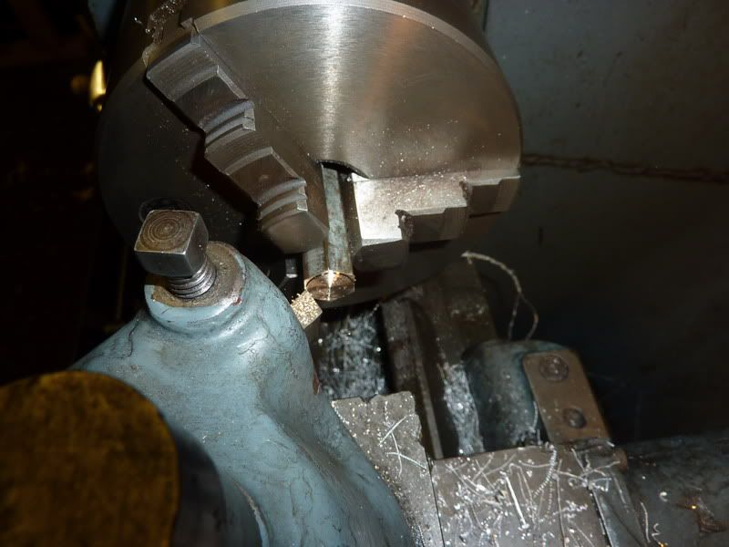

Right, despite even more moaning for her, here is a quick update - with some machining!
I thought I'd make a start on finishing the wheels off, which were just blanks at the moment.

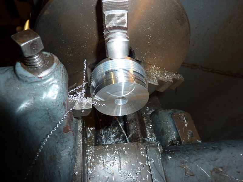

To turn wheels, there's a sort of accepted method in the loco world and it makes sense. You face and bore / drill the blank in the outside jaws, then turn up an arbor to finish the tread / flange. Once the arbor is turned, you don't take it back out of the lathe so it stays true to the lathe axis, however, as you'll see, in this case I did because I made the bloomin' bits the wrong way around!  :doh:
Anyway, here goes -  it needs to be a fairly large dia to give the wheel some support from behind, another quick way I suppose you could do it is use some rod near to the right size, skim down then with a nut clamp the wheel up against the jaws of the chuck, but here is my method:
Found some suitable material and turned and faced one end for a nice datum:

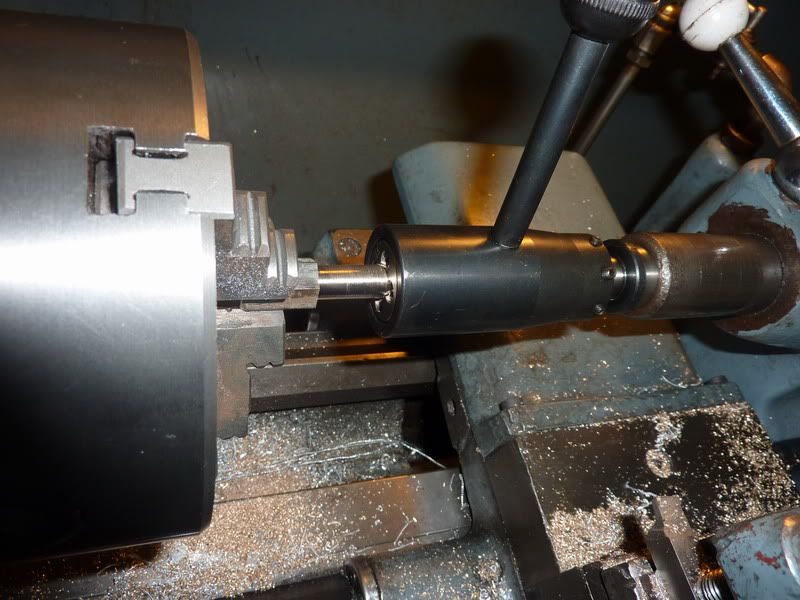

Turned it around so I could grip the datum and turned a larger, new datum on other end which will be gripped in the chuck until all wheels are complete:

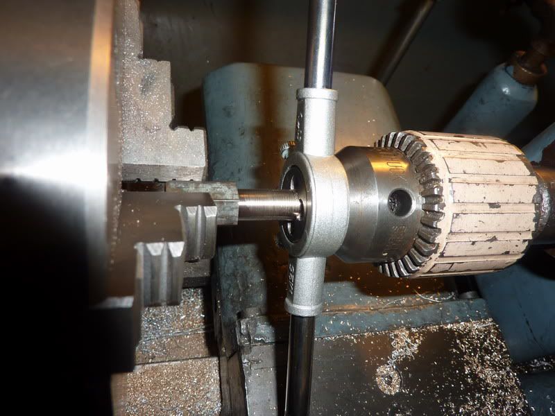

Opened the hole up then tapped it:
at this point I should have started bolting wheels on and turning them but I realised I'd made this part first instead of the bolt!  :doh: So I scribed a line at one of the jaws and made a note of which jaw to ensure it was back in the chuck where it was before - this can't gaurantee zero runout still but I could hardly detect any.

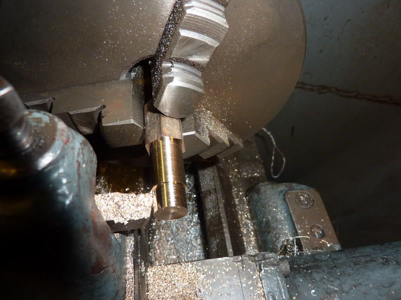

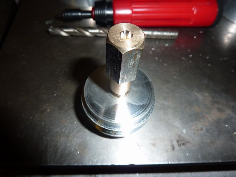

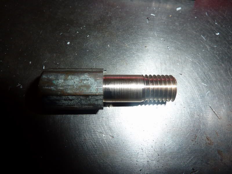

Started making the bolt, face a bit of hex to length:
Turning down to size:
I hate finishing cuts, I took half a thou off but it was still not enough - that's when I get in patient then overshoot on the next cut! This one was ok luckily, maybe a tinsy bit looser than I would of liked but still ok:
Putting a shortish thread on the bolt, only thing I needed to do was make sure the plain shank was shorter than the thickness of the blanks so it will clamp up:
Then I realised I had been given a tailstock die holder for xmas and hardly used it - much easier  / better result with this! :
Here is the finished bolt:
Actually it wasn't, I only left the head long because that's how it worked out - no point sawing, parting things for the sake of it but then as an after thought I put a centre hole in to support it from the other end, so it was a good job I left the head of the bolt long, gives me more room to get in:
Wheel mounted on the arbor and started truing up the OD:
Then turned the tread leaving the flange 1mm over-size. I will need to grind a tool with a 1mm rad to go in and form the radii, think I will get all wheels to this stage first though so only have to change tool once:
I'm sure many people have seen this sort of method before but thought it was worth showing. An other way is to turn down a longer piece of material to leave a spigot the right size sticking out, then thread and use a nut to clamp - just more work whittling down a larger diameter. Or, you can buy expanding mandrels, never tried these though.

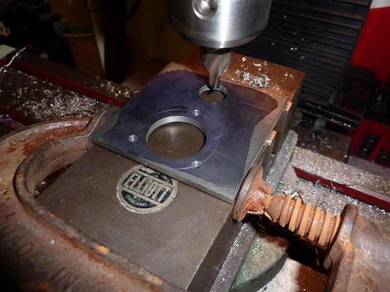

I then started on the motor hangers, I thought I needed more flat steel for this but I decided to measure the bit I'd bought and there was just enough as luck would have it!  :D
This was really a marking out and drilling exercise, I was holding the pieces by hand to drill them and being careful managed to get up to about 1/2" diameter - then when I was drilling one of the smallest holes I was too slap dash and didn't have a tight hold which sent the thing spinning and dug into my hand - hence the g clamp set up a bit further down. So there's a bit of a safety lesson to learn there, I thought I had some common sense but obviously not, I kept thinking I shouldn't be holding onto this really but I thought I'd cracked it then then it came back to bite me drilling the small hole  :hammer:  :wack:
The setup to bore the big holes was quite interesting. At first I thought I couldn't do it it my massive 4 jaw. It's really too big for the lathe in my opinion - so if I had all the jaws reversed, there was no hole in the middle to bore through, if I had them in the normal way, the jaws were extended out too far and caught the bed. Then I thought why not put 1 jaw in the normal way and use some packing pieces - to my astonishment it worked!
This is the setup I used for drilling the holes out bigger for the bearings - I didn't have a drill big enough but found a centre drill that did the job:
Here are the finished hangers minus the bushes which will need making and loctiting in.

It got lost in the wash :( ISTR you turned some hex stock into bushes...
Offline NickG
  • Posts: 1890
Re: 7 1/4" Gauge Electric 0-4-0 Loco
« Reply #26 on: November 03, 2010, 10:54:09 AM »
Basically yeah! I just wrote a load of waffle with it but here are the pics anyway:
