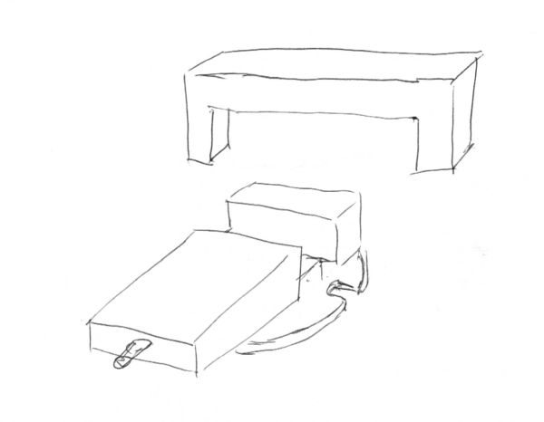

For anyone who has one of the hardened vises you can make one of these.
Simple horse shoe shape that clamps in the vise and the two ears drop into the tee slots.
they don't even have to be a good fit as long as you keep the vise pushed or pulled so the jig registers.
If when fitted to the jaws they don't line up with a slot , then just use packing to get it in line.
Before you make one check your other vises and make it so the same jig can be used on all sizes [ up to a limit ]
John S.

Very good idea there John.
That would be perfect for those toolmakers vices that don't have holdown slots, but a sort of clampy bit on the side.
