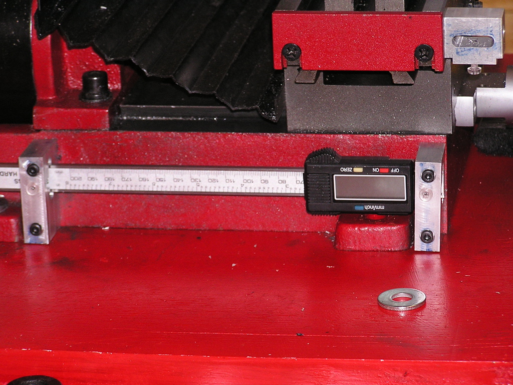

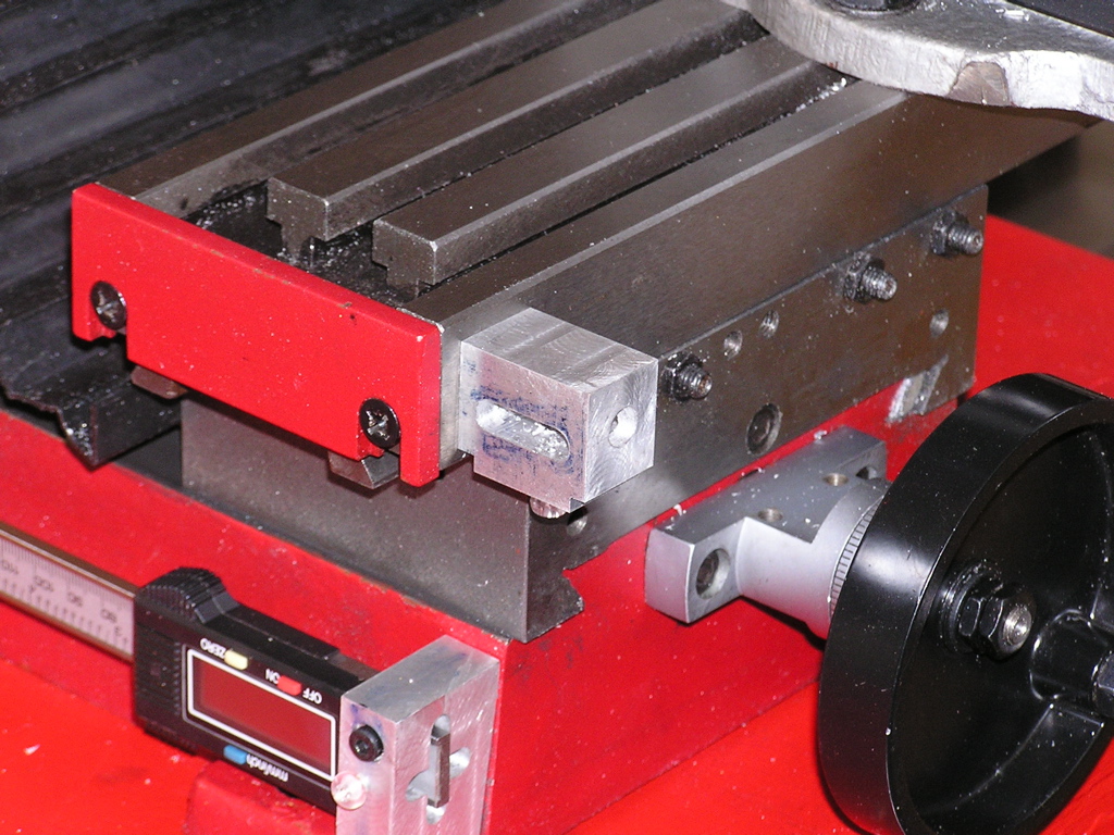

After seeing John Rudd's thread on mini-mill DROs, I thought I'd post the the progress so far on the DRO addition to my Sieg X2 mini-mill.
Brackets for X and Y scales are finished and mounted, I still haven't worked out the best way to mount the Z axis scale.
I was undecided as to the whether to mount the Y scale vertical or horizontal hence the two slots in the mount.
 Horizontal would make for easy reading of the display but then I remembered that once I connect the Shumatech DRO, seeing the displays on the scales wont be necessary.
I'll remove the display and plastic housing from the scale read head  as per these photos http://cnc.turkeys.net.au/workshop/scales
The read head will be connected to the X/Y castings via a .305mm shim - once I work out the best way to mount it.

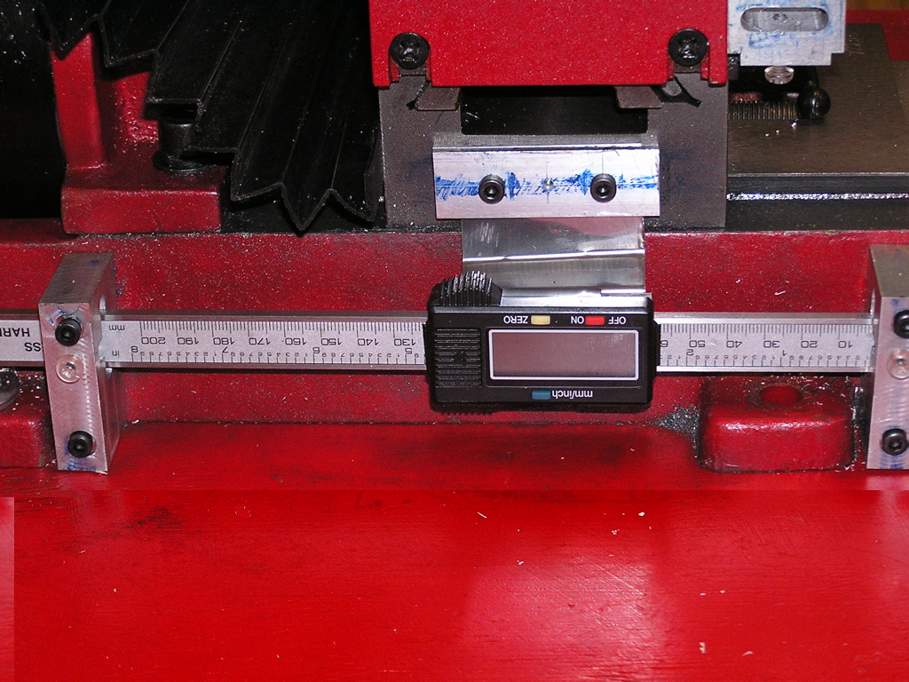

A bit of work today saw the Y scale mounted - 2 more to go.
The Y axis casting is joined to the scale read head via a piece of stainless steel shim - but it's too thick.
I'd ordered 0.254 but received 0.305mm instead, It was marked and invoiced as 0.254mm but it wasn't until I cut it that I noticed.
It's only a couple of thou (for the imperial brigade)  thicker but it makes all the difference. Probably 0.20mm would be better.
Once I get my hands on the correct size and I have the DRO mounted, I'll remake the shim piece.

Looks good - noticed you have clamped both ends, on the plans I followed the front is clamped and the obviously the display to the table but the back end just floats.
Chris
tumutbound
Re: And one more Mini mill dro upgrade
« Reply #5 on: August 26, 2010, 04:54:43 AM »
Chris
As far as I can tell, leaving one end floating is to allow for any inaccuracies in the brackets/mounts etc that would cause the scale head not to run true.
The shim connection wasn't my idea (Chris on the Yahoo 8x18lathe group has a write up on it.) but it seems like a simple way to allow for any necessary flex without causing any stress on the scale.
This is probably true with a thinner shim, the current one does put a surprising amount of pressure on the read head.

Well got the X axis scale installed and working. I was able to mount the read head using the screw hole that originally held a pointer for the ruler/scale attached to the front of the mill table. The ruler was  removed and the mount holes used to mount the body of the digital scale.

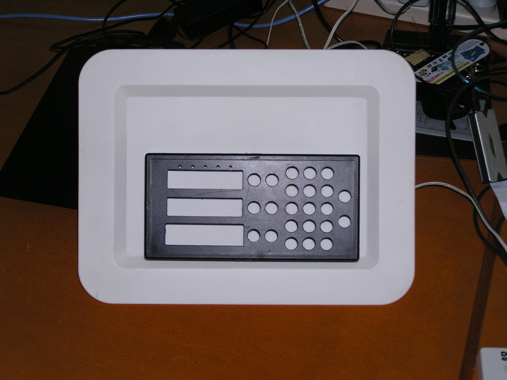

Used the scales for the first time to mill the case for the Shumatech DRO-350. If you look closely, you'll see the bottom slot is a bit bigger than the other 2. I used the measurements provided by Shumatech but forgot to compensate for the end mill diameter  :bang:
Soldering up some cables this evening to complete the assembly.
