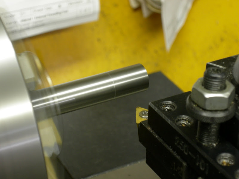

Step 1, get some drill rod that matches your boring tool holder diameter. Here I'm using 5/8". (the drawing shows 1/2", but use any size you want...) Square a T style insert to the workpiece. The edges of this tool will form the v in your threads, so take your time making sure it's good n square.
Step 2, layout the shoulder line. You don't really need to do this, make it as long as you want.
step 3, turn the OD down to whatever you want to start with. I used 1/2" because this tool will be used on large internal threads, 2 inch and over. The smaller you make the tool, the smaller the internal threads you can make.
Step 4, Turn the undercut shaft. Keep this as short as possible, just like short stout borring tools, this follows the same idea.

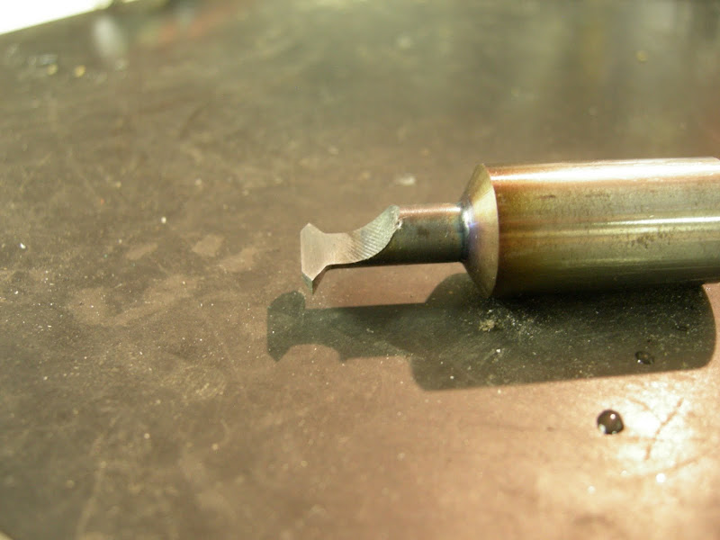

Step 5, Make the point. Use the side of the insert to make the sides nice and flat.
Step 6, Part it off.
So that's it for the turning. You should break all the sharp edges here, and face the ends of the tool flat if they arent already.

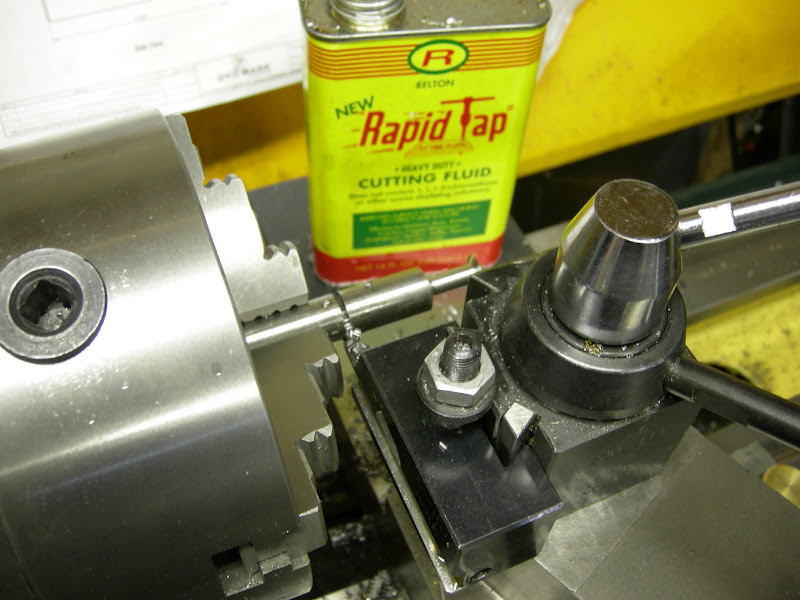

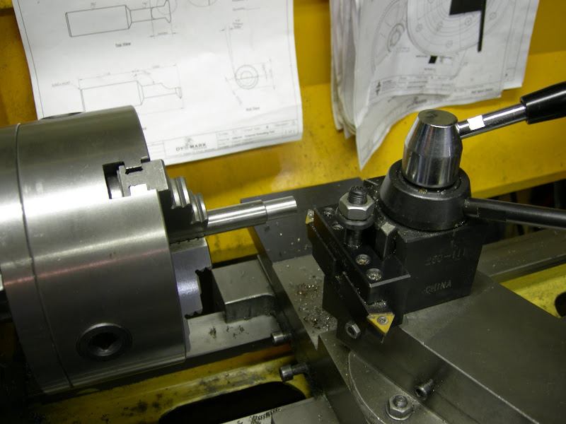

On to the milling. This is the first time that I've done the milling part in the lathe, but it worked OK so I will show you what I did here.  Normally, I would set up the mill, clamp the tool in a vise and mill away the material, but this worked OK. Make sure everything is tight, I had some vibration when I was doing this, and the toolholder actually turned, which is not cool to see when you are hogging off material.
So, put your 1/2 finished tool in your boring tool holder. Make sure it's clamped down tight.
I used a 1/2" 4FL endmill for this, but you can use whatever you have laying around.
I adjusted the height of the threading tool to be cut manually. I started high and took a few light cuts, then just kept lowering the tool by hand, making sure the QC tool post wedged in hard each time, at each height. You can work this anyway you want. It didn't take but a few minutes and I had all the material I wanted removed.
Not the nicest machining but hey, it worked ,especially if you only have a lathe.

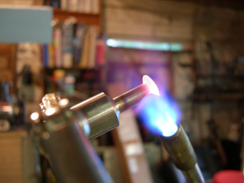

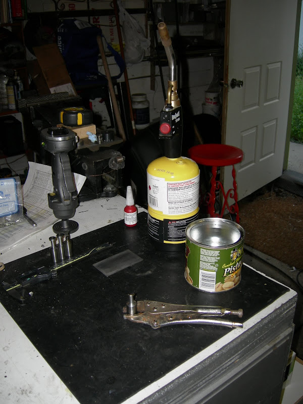

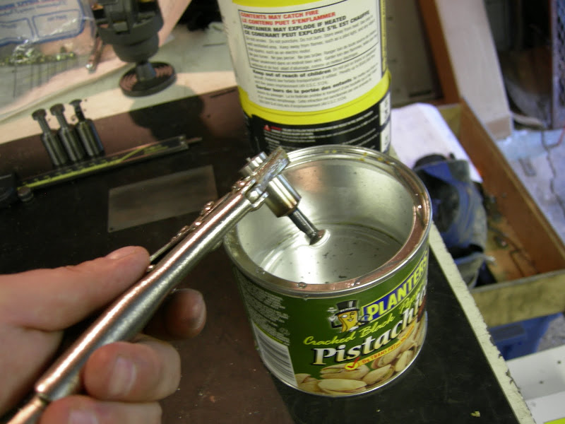

Now the hard part, or should I say the hardeneing part? Regardless, it really easy with this steel. Heat to glowing orange, quench in water. Done. Check by trying to file. If you CAN file it's not hard, do the steps again. If the file bounces off, Good job! :beer:
Step 1, get a can full of water, a propane torch, and hold your tool with some visegrips as shown here:
(Pistachio cans make the tool harder, that's why i use them)
Step 2, fire up the torch to high and get the tip of the tool bright orange.
Step 3, be quick as you quench the entire tool and the visegrips and your hand in the can of water, try to cool the piece as fast as cosmicly possible. This will give the best chance of making the tool hard.
Step 4, try to file part of your now hard tool. Do this on an edge that isn't important, because if you didn't get it hard, you don't want to screw up one of the critical edges right?
If the tool is adequately hard the file will not do anything. Stop now or risk destroying your file. (you should use an old file anyways...)
So if it's hard, all you have left to do is hone the top face of the tool. This is the only surface you sharpen, never try to hone the sides or you will change the angle.
Just setup the tool in your boring tool holder and thread away!

the tool should be let down to light blue not left fully hard as it is to brittle

Does it matter how far over-center you go when doing the milling operation?
Yes, but only really for how much clearance angle there is VS how much meat is left at the cutting edge. The drawing shows how much to mill off. (I've posted the link in the original post)
As far as tempering, yes, if you feel so inclined you can polish the top then gently heat it up till the polished area is anywhere between straw yellow and light blue. Straw yellow will yield the hardest temper with the least ductility, light blue will be the softest but the toughest. If you are going to be threading on an interrupted bar, then go for tough. Personally, I leave the tool full hard as I never take interrupted cuts while threading. Also, the hardness gradient is very short, going from glass hard at the cutting edge to full soft somewhere along the shoulder. Keeping it full hard keeps a keen edge for a long time.
Thanks for the comments.

For brass and aluminum, leaving this dead hard is probably just fine.  I think for threading steel, folks
would be happier if they temper it, as it will be less prone to cracking in the harder metals.

Oh, by the way, old dog food tins make better quench cans than the ever popular pistachio can.  The tools
come out better, and you don't get the munchies while toolmaking.  This comes from many years of experience
and testing quench cans while making my own tools.   Wash the can first, or you'll have dogs sniffing around the
shop from the smell of  'boiling dog food soup'  ; )
