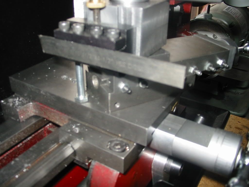

 Well, I might get labelled a redneck here, but here is a mod that helped me immensley with parting off on my mini-lathe...
I had always had trouble with parting off.  Going to a steel QCTP helped a bit, as did locking the carriage and the cross-slide.  But it still wasnt good.
One day I came across a picture on the nudie-net (sorry, dont remember where) of a bolt, threaded into the bottom of the parting tool holder to give it some support.  I needed a quick-fix right now, so I tried this little bit of "bush engineering", and it worked wonders!  So well in fact that 3 or 4 years later I still havent prettied it up!
The pictures arent great, but you will get the idea.  Here is the tool holder:
and here it is on the lathe:
The head of the bolt was faced off to give it a smooth sliding surface, and a jamb nut locks it rigidly into the toolholder.  The bolt can be lengthened or shortened to allow for tool height adjustment.  The bolt head slides smoothly across the cross-slide as you feed the tool in, and so far does not appear to have worn, marked or "hammered" the cross slide.
Sorry for posting such an ugly mod, I wouldnt have done so if it hadnt worked so well!

Re: Q. about mini lathes & 'cutting off'
« Reply #8 on: May 27, 2010, 02:08:11 AM »
There`s nowt ugly about that mod, mate...... It works..... VERY well!  :thumbup:
I couldn`t get support under mine, as it was too far over, out in space......  ::)
So, I got rid of the topslide......
Then made a slimline holder for the carbide tool......
I could now fit one of your screwjacks, if necessary!  :D
Great idea! Thanks......  :clap:
