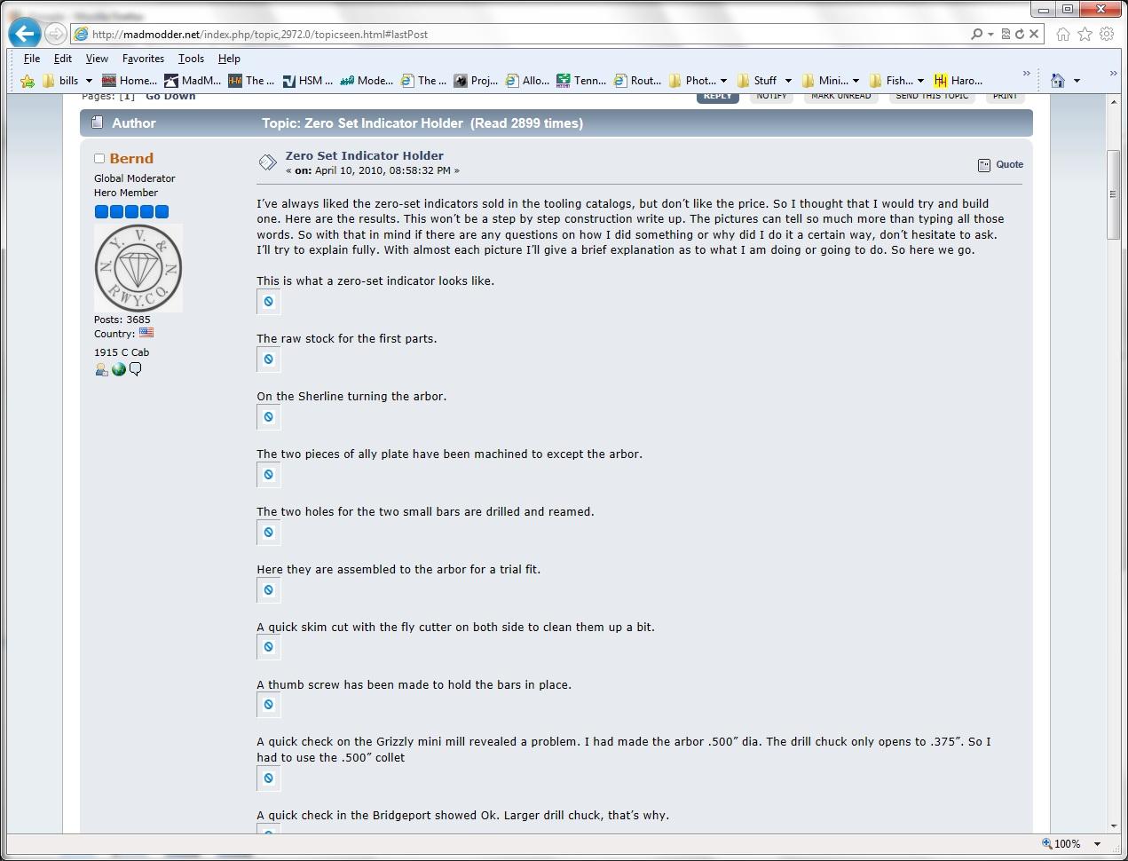

Re: Zero Set Indicator Holder
« Reply #11 on: January 10, 2013, 07:46:10 AM »
This is what I see in Bernd's origional post:
Chuck
Chuck in E. TN
« Reply #12 on: January 10, 2013, 08:34:33 AM »
I can't see 'em in the original post, either. Right clicking and then
- clicking on "Show Picture" has no effect
- clicking on "Properties", copying the URL and pasting it into my address bar gets me to a "Page not found" notice, with a banner saying "Kingstonemodeleng.com" and a set of links to different sorts of flooring below. Weird.
I can see Rob's version, though.

I only get the lines of text. No 'boxes'  under each one as shown in your screen shot..
Offline Chuck in E. TN
  • Posts: 572
  • USAF Retired
« Reply #14 on: January 10, 2013, 09:27:32 AM »
The boxes representing missing pics appear in IE, they do not appear in Firefox.
