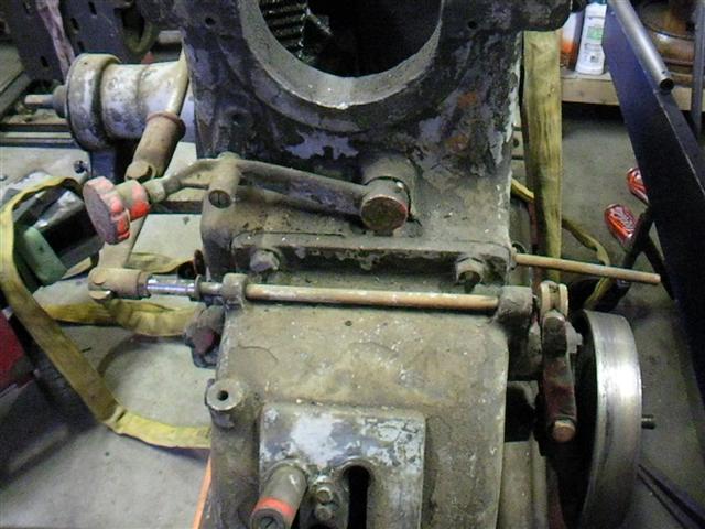

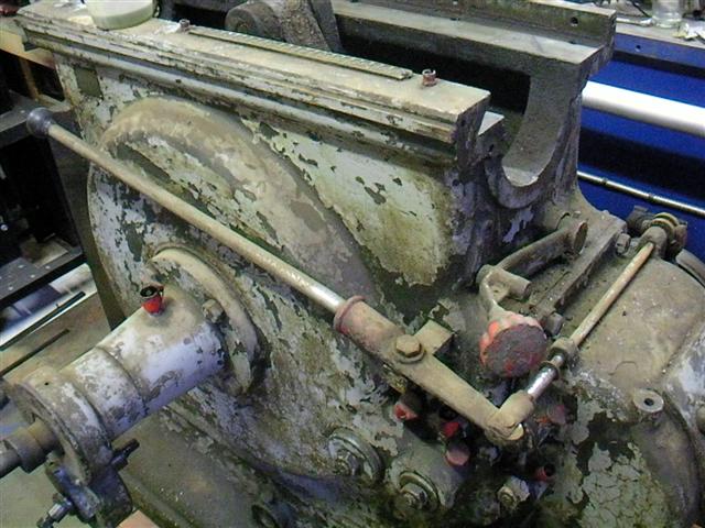

I don't have any pictures of loading it because we forgot to take the camera up their, but here are a few while unloading it.
I will update this tread as I progress with the shaper, and will do a separate thread on the mill in a few days.
Davo

A couple more
Davo

I had another quick look over it last night and found Alba 6s on the door, a small brass plat showing lubrication sand a round spot at the bottom right hand side of the column where a another plat used to be.
The gearbox looks to be 3 speed and another lever for high an low so that makes 6 speeds. I remember the old busses had gear sticks like that.
It has some sort of serial number on the top of the ram on the graduation collar, at the end it has a / 23. I am wondering if it is a 1923 model? I found another bloke who has one and it's a 1947 model.

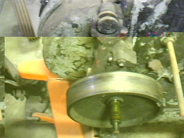

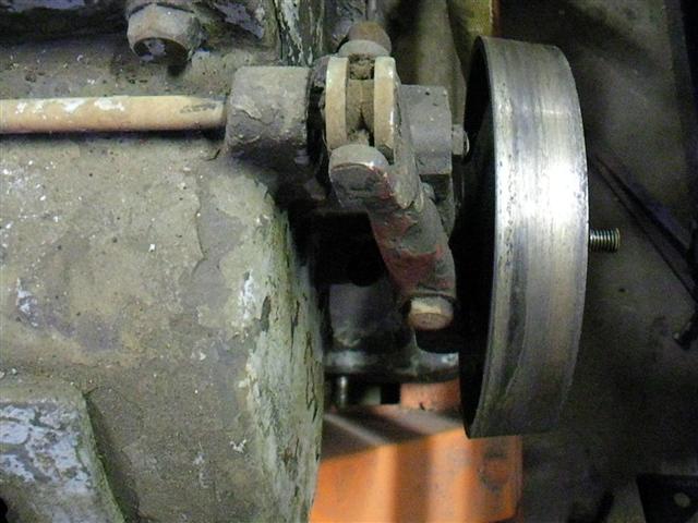

Here are the photo's of the clutch set up.
It works off a sliding tapered male drum attached to the shaft by key way, the pulley has the female taper and runs freely on the shaft when not engaged. Pulling on the lever pushes the male taper into the pulley and a small spring loaded detent pushes into the the side of the rocker arm next to the pulley to hold it there. Pretty simple really.
Davo

« Reply #7 on: March 31, 2010, 04:07:23 AM »
And a few more

Thanks Dave,
My pulley wheel is keyed to the shaft so doesn't look possible to convert. Those parts are too big to make on my machines leaving the only option to find one being scrapped. Not very likely these days I wouldn't think.

Hi Darren,
If you really want a clutch I can see a way around it.
You could get 2 different size brake drums (of a size that you are able to turn) off some cars, then turn a male taper on one and a female taper into the other. Make a hub for the male one with a key way to suit the shaft and attach the other female brake drum to the pulley. Then you could then make a shaft extension for your original pulley and bush it to cover up the key way. The rocker arm would be easy enough to make and use a car clutch throw out bearing on the male to engage it.
From what I have seen you do, I know you are capable of doing this, it's just weather you want to go to the trouble. If I can help in any way let me know.
