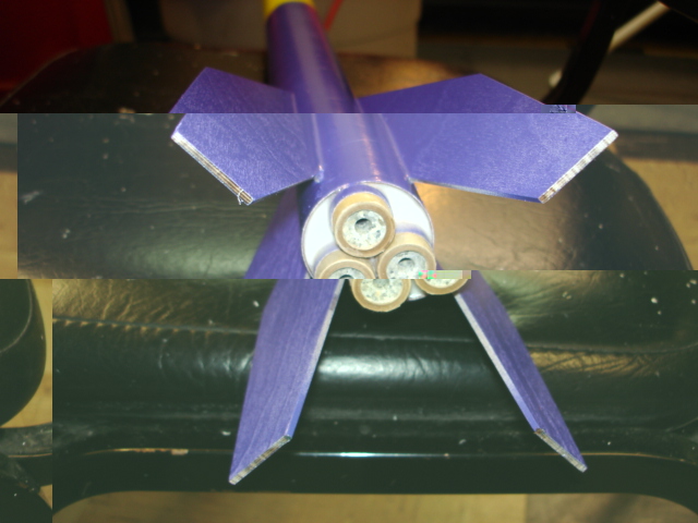

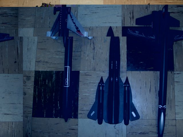

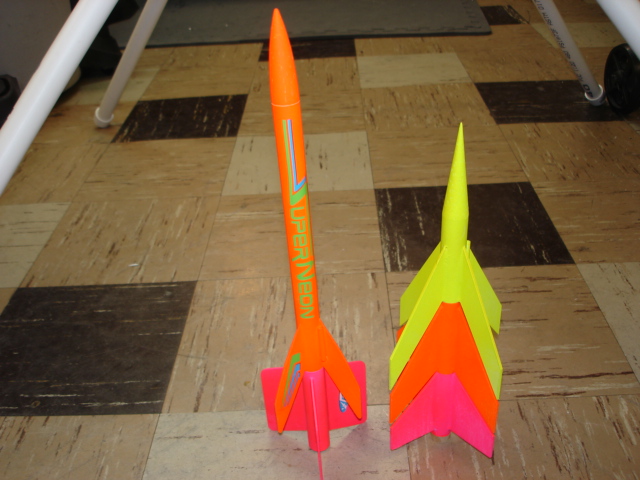

As promised a few pictures of the rockets.  We built 10 in all, but are waiting for some tubing to complete the three stage Comanche 3 rockets.  Some of them are our own design and some are kits.  We built them to fly so they aren't as pretty as some peoples rockets.  I don't waist time filling in the spirals on the tubes or use sanding sealer on the fins.  There is a good chance they will be junk by the end of the summer so there is no need to go crazy on the details as long as we are having fun.  There are lots of two and three stage ones as well as a three stage cluster rocket so it should be pretty exciting to fly them.  I have a total of 65 engines so we are good to go as soon as the weather gets nicer.
