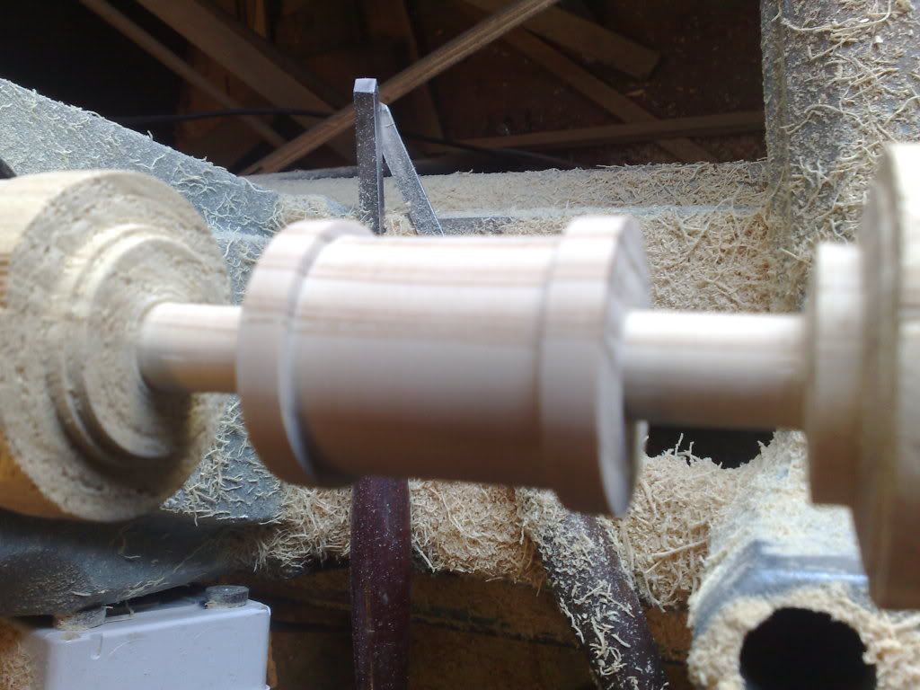

The cylinders, for a simple item it ended up being quite a complex (and touchy!) cast. The plugs in manufacture....
I hate the wood lathe...scares the hell outta me! A mate, John is doing the dangerous stuff, Ive got the camera..
This was made up of 2 pieces which were screwed together outside the machining area, so when it was parted off it fell apart...
