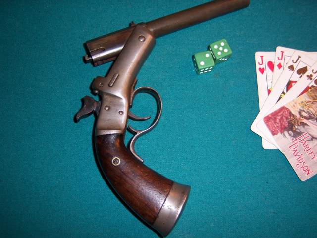

   I am building copy of a Stevens Tip-up .22 pistol ..This all for learning lost wax investment casting..First I build this gun in steel. Then will use the parts as patterns to make rubber molds.The molds to output wax patterns that will be invested and cast in bronze....

Thankyou for showing the interest...Stevens was a company later bought out by Savage...Stevens very first model was the Tip-Up..Apparently that refers to the breech opening by tipping up to present the spent cartridge to the shooter..See the attached picture, a typical tip-up....There were a go-zillion slightly different Tip-up models..Some were small pistols, others were long pistols like I am building and then some were made as rifles....Stevens primarily made low cost guns for boys..Like the famous Stevens Favorite and Stevens Marksman...Possibly I like the Stevens guns because my name is Steven..I dunno but I have built several of Stevens designs....and they are not hard to build...I find gun picture I like and drag it into Autocad where I trace it and scale it and soon after that I am cutting metal

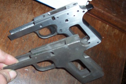

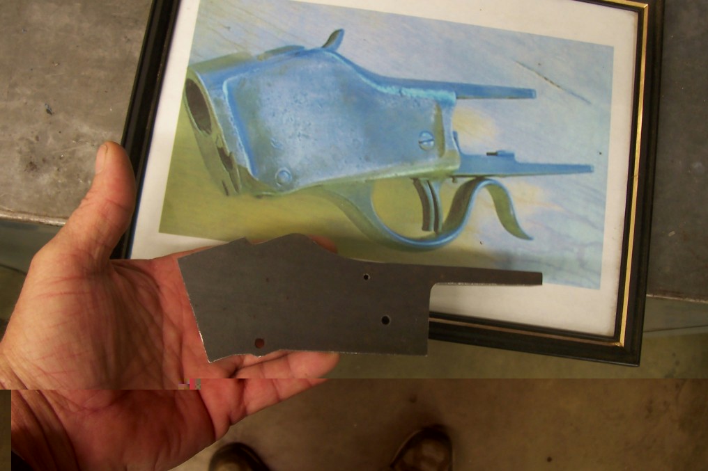

« Reply #9 on: October 03, 2008, 07:27:39 AM »
 I finished the build of the pair of 1911s..This is week old picture dont show the sights I installed on the top 1911 but otherwise the guns today look no different than in this picture...
 I starting drawing the parts and generating code to scratchbuild a Winchester Highwall falling block rifle in .45-70 caliber...............For those who might not know , these Colt clone 1911 handguns and the Winchester mod 1885 Highwall were both invented by John Moses Browning...Genious prolific American arms designer.
....Anyway ,anyway.... Several years ago I built the lowwall which is practically the same gun and it took so long to build it that I swore I would never build another...But friend has asked me to help him .He wants to build one so I will make him and I each a set of parts using my cnc mill...To be perfectly legal I will handover parts to him that are very far from usable, nothing remotely resembling a reciever by legal definition.....He'll have a monumental amount of work to do to finish his Highwall, especially considering the few machines that he has to work with...I on the other hand will run through and finish mine in matter of a few weeks..........I love metalsworking!!....

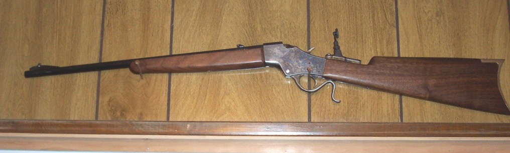

 The top rifle is a .38-55 caliber homebuilt version of a Stevens model 44 and 1/2 that I finished a year ago.The lower rifle is another same model -- a .17HM2 caliber that I finished building from barstock last week....Presently I building one in .22LR and another as .32-20 ..This falling block Stevens is very desireable action in some groups of shooters, I like'em for my personal collection.Lot of fun to shoot, accurate , feel right and look proper for 100 year old manufacture...

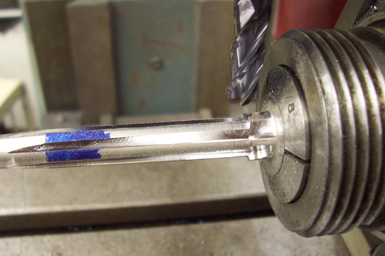

« Reply #21 on: January 24, 2009, 03:25:53 PM »
 Bernd. I tried recently I made a chambering reamer for .17 HM2 caliber but the pictures come out blurry....But I can tell you what I do and it liable to blow your mind..
.I dont do like everybody else- use oil hardening drill rod and brittle quench and temper after making the reamer..No I make my reamers from good hard  (HSS) high speed steel tool blanks and then dont have to mess with heat treating....( ohh let me add that I have heat treat furnace and a Rockwell Hardness temper and use them all the time but not making chambering reamers).. I turn the HSS (usually starts .500 round and 6 inch long)to size with lathe using carbide lathe tools...and/or spin it under surface grinder wheel using either a spin fixture or punch former to bring it to final size...........AND then I cut the 4 flutes into the HSS reamer on the mill using carbide endmill..Then I coat whole tool with dykem blue and grind relief by hand using a dremel with a cutoff wheel..It ends up looking amateurish but it defintely works well to make them this way and its fast..
 Serious..I use surface grinder almost daily..You get a surface grinder and its like pouring gas on a fire your projects will go that much faster.If mine took a dump on me today and I couldnt fix it ,I'd have another one drug in here before 2 weeks has passed.....I make special tools all the time..Like need a short .2085 reamer? Just turn down a 1/4 endmill to that diam ..under the surface grinder..Then it will plunge cut to open an existing hole to that dia...That make sense?  ..I prolly preaching to the band , you may already have a surface grinder but I mention this for benefit of the few others who will be reading this post...
Ohh and here is a picture where I cut the flutes on some reamer, dont remember what it was.

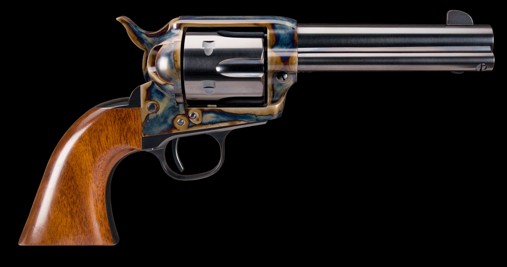

 I am going to switch over to building copies of old west 6 shooters..Colt Single action revolvers...No time to waste, while it is still legal I want to build a couple or three more handguns.....Handguns will be first to go when this new administration starts re-writing the Constitution of the United States....I attach picture shows example of what I want to try to build.....Well , what I build wont be anything as nice as that but I will try.. :D

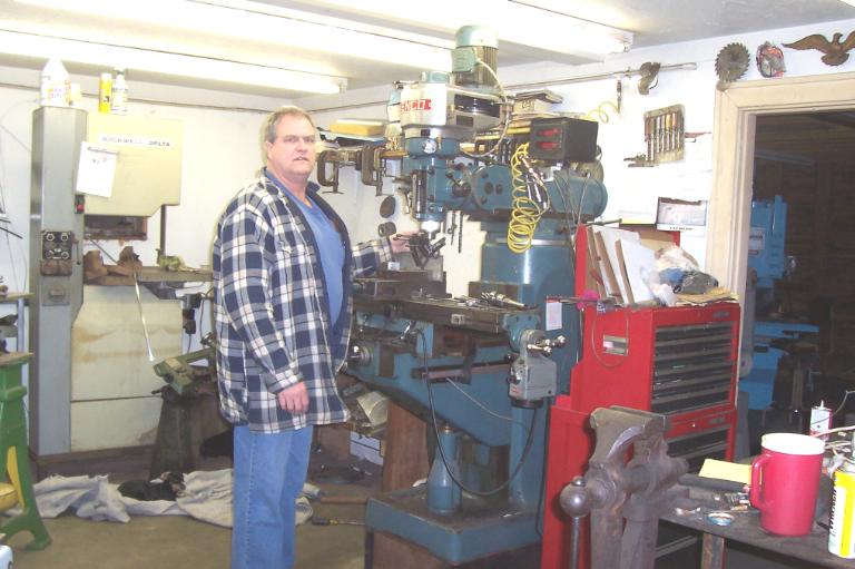

 I have a couple cnc mills, a pair of manual mills, 3 lathes , surface grinder etc. etc.all rather serious stuff..I got my share of expeditiously helpful motorized machinery but will swear that I believe that the measure of a mans completed work is predicated upon the quality of his abrasives and his file work.... I regret that my eyesight is going bad , I have to get my nose right down nearly touching the workpiece to use a file with some degree of precision. I marvel at pictures showing persons using a file as you describe..Also I got a picture of a lady checkering a gunstock at comfortable arms length,she not hunkered down over it. I wish I could operate that way. I pull a stool up to the vice , sit down to use a file........I set one my manual kneemills up onto a 10 inch high block so I wouldnt have to bend over so far to see the work..see the picture.

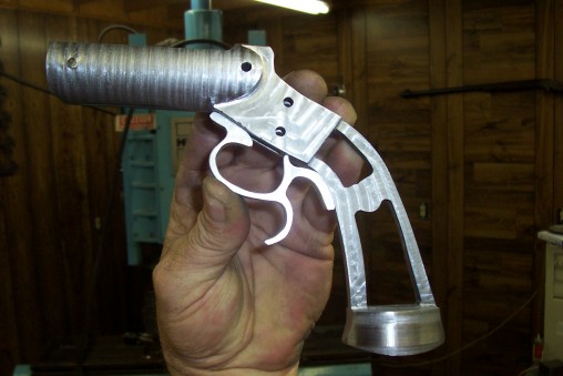

« Reply #32 on: January 31, 2009, 06:58:15 PM »
Heres the revolver project I started last week..It will be .38 special ..I like these early pictures that look rough and ugly and probably has the average viewer thinking it cant possibly turn out to look good and function correctly..So far she is going good and nothing done so poorly to give me reason to think it wont please me when I am all finished...Note the barrel is just laying there in the picture..Also note I sandcast the brass grip frame...Give me a couple more weeks and I may be looking for a holster :clap:
 I dont have a real Colt single action army to copy and dont have schematics to work from..What I have is pictures off the internet of some real purty guns..and I have a percussion cap revolver that is lending some dimensions..From there I am winging it.......Really I am having way too much fun..Hehhehhheh

 Yes plenty of hand work but also lot of use of manual lathes , mills , grinders ,and  heat treating furnace...Maybe I will set it back on the cnc mill for finish contouring the recoil shield...But.........explaining why this is a good project is because I get to play with most all my toys , even the Rockwell Hardness tester and my metalscasting setup got some use......and I seeing I could really be using a sinker EDM about now so this gives me excuse to hunt ebay for another machine... :clap:.
 What you may not realize casually looking at that picture that I put up.. I am machining the reciever in block form leaving final contours till last for very practical reasons..This way I keep my square reference surfaces and flat sides to make precision setups easier..Getting things lined up properly is higher priority than purty contours at this stage.

Now by single action you mean that you will need to pull the hammer back with thumb to be able to fire it, versus pulling the trigger that would then pull back the hammer and fire it?
Also will this have a barrel to hold 6 bullets?. I've alway been interested in how they make all those parts and how they function.
Perhaps one of these days when I don't have so many projects to do I may start on building one of the gatlin guns I have plans for.
Thanks for the pics and keep us in the loop as you make this fine firearm.
Offline Alphawolf45
  • Posts: 97
Re: Current gun build
« Reply #37 on: February 01, 2009, 10:37:15 AM »
 Yes single action means hammer must be pulled back to cock the gun.This is near miss copy of the 1853 Colt single action army design..Later  revolvers developed that could be fired either single action or double action -simply pull the trigger through a long stroke will cock and fire the gun..........Also this gun can be called a 6 shooter..It will have a rotating cylinder having 6 chambers where 6 cartridges can be loaded....But it was only safe in everyday carry to load 5 rounds with hammer down on the empty 6th chamber.......
I can tell you that a double action revolver is an order of difficulty well above this single action revolver..I have had monumental trouble repairing double action revolvers , to say nothing of building one..
 Gatlin guns are very challenging builds from what I have read..I would like to read the full account of some fellow build his first one...
