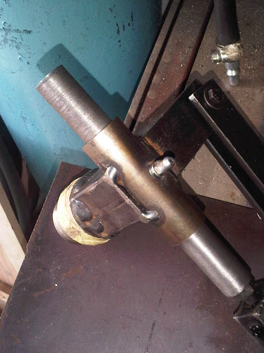

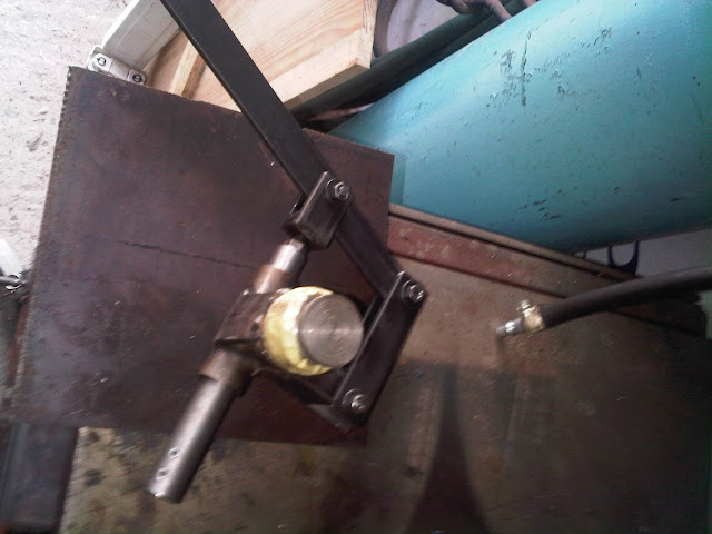

Hi All,
I need to cut some change gears in the near future and am investigating ways of cutting the slots. I've found Stew's excellent write up http://madmodder.net/index.php?topic=1859.0 on how to quickly make a keyway slotter which is more than adequate for my purposes.
However it got me thinking, and I want to throw the idea out there. How about using an old drill press as a quick and easy slotter? I've got a bench top drill press that's just sitting idle. I'm busy making pigtails for mops I bought the other day to turn it into a buffing station and on my project list is an adaptor to turn wooden handles on it also. It'll be great if it also can function as a simple slotter even if only to time me over until I have some quiet time to build a dedicated hand operated slotter.
Oh and I plan to make the gears out of either aluminum, brass or bronze. Soft material so that if I get the gears wrong, it does'nt damage the existing gear train of the lathe.

You can just use a boringh bar holder in the lathe with a square tool that has a vertical cutting edge and plane the slot in with teh carrage a few thou at a time.
The materials you are looking at will be easy, I've done quite a few in steel upto 3/16" wide keys and 1" long like the four in this gear centre

« Reply #4 on: February 08, 2010, 08:21:22 AM »
Its more the strian it puts on the user than the machine!! I wouldn't want to use it much over the 3/16 keyway width as it does take quite a bit of effort.
One way to lessen the effort and also help guide the tool is to make a plug for your gear out of a scrap bit of similar material and the drill down the joint between the two. This removes a lot of the metal and also gives helps keep the cutter in line.

Here is a few shots of my lathe slotter ,
This tool has come in very handly of late  :D
Cheers Rob

Well, here's some pics of my version. It's taken from my cell coz I broke the previous camera and my wife do'nt let me touch the new one.
Constructive criticism is more than welcome - I am struggling a bit.
I could have done better finishing the ram - I believe going over it with emery cloth would have improved the surface finish somewhat.
My welding is'nt up to scratch anymore. My eyesight is'nt what it used to be and I'm having trouble maintaining a steady hand.
In my defense the other beads do look better after I dialled in the welder a bit.
I also just tacked the ram guide because I was afraid that it would warp if I fully weld it.
Showing the spigot - hope I'm using the correct term - giving an idea of how it'll be fitted to the cross slide. Underside is also very rough.
I actually turned the spigot last year already for some other project which I can't remember. Was one of my first attempts at turning.
Also visible is the 2 grub screws in the ram for bolting down the tool holders. I had to cut and file the screws down considerably.
Oh and the tape is there to protect the spigot when I clamped it in the vice to file some of the welding spatter off.
I've gained confidence boring and making my own boring tools and learned a lot through the mistakes that I made. I'm not very happy with my measuring skills and plan to invest in a digital caliper as soon as funds will allow. But I'm getting there slowly but surely.
Have'nt tried it yet. Will in the next week or two cut a keyway in a pulley - hope it works!!!
The slotter is sitting on the 20mm plate that I plan to use as a milling plate - it looks larger then it really is. I'll take some better pics of that to include in my other post. The edge towards the ArCO2 bottle is the one that I filed and sanded by hand - I hope to do better using an end mill cutter as suggested by some of the board members.

Looks OK to me but I'm a function over form guy. Make it work 1st, make it pretty 2nd.
What are you measuring with now? A vernier or dial caliper are just fine--a digital is easier to use. But if you want accuracy--especially for close fits--get a micrometer.
Mike
Re: Poor Man's Keyway Slotter
« Reply #33 on: August 24, 2010, 09:27:40 AM »
Looks good to me. Should work just fine.  :dremel:
Waiting for more pics.  :thumbup:
