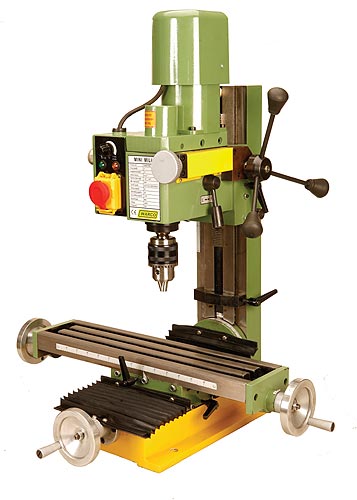

Re: coupling Nema 23 stepper to X mill X axis spindle
« Reply #6 on: January 21, 2010, 07:30:31 AM »
Chris,
I've almost built the stepper controller, just need to install the fets(after adding a heatsink)
Here's a picture of my mill( albeit mine is a white/cream colour) showing both hand wheels..
Offline HS93
  • Posts: 788
« Reply #7 on: January 21, 2010, 08:53:12 AM »
that mill is realy easy to go to belt drive, just remove one of the plates replace with a ally mount with bearing and thrust washers and make up the difference with a toothed gear, slip belt of when not in use if you want, I also use Arc euro handels that fold for saftey when milling.
