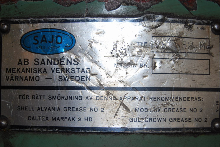

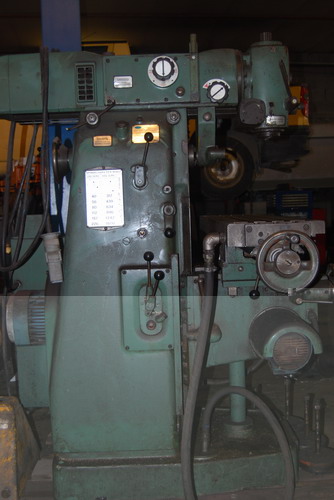

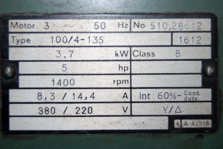

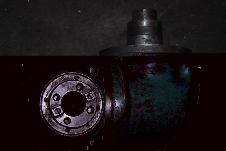

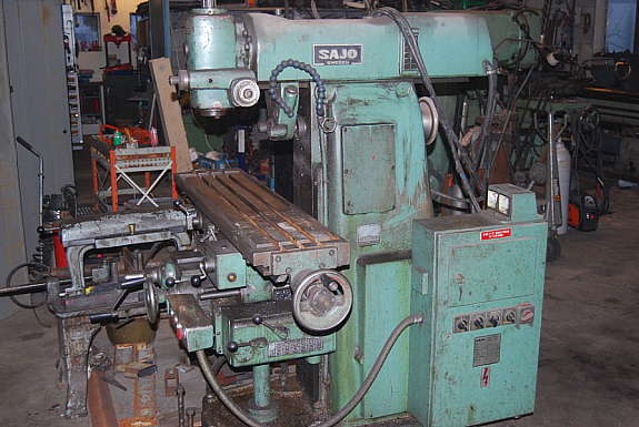

Having seen  :worthless:  in almost every post, i thought I'd please you with some pictures :)

As it has feeds on all axis then it should be fine for boring  :thumbup:
Looks like a nice solid machine in the pic's

Since no one has brought this up, have you checked the electrics on this machine?  Most households operate on single phase power, whereas many large machines require 3 phase electrical supply. You can get a converter to change over from 3 phase to single phase but they cost about U/K £ 600.00.   :zap:      Ouch.
Harry
Offline Trion
  • Posts: 239
Re: Newb mill questions
« Reply #19 on: January 25, 2010, 10:16:45 AM »
The machine is 230V 3-phase, the same as my other equipment. I have that available in my workshop, but 230v 3-phase is outdated. Some day I will have to convert to 400V. I have checked, all the motors can be converted to 400V, but I'm not sure about the contactors and fuses. The machine has good electrical documentation, so the convertion should be straight forward. :dremel:
I know little of household/workshop electrics, but as far as I have understood, most new norwegian houses have 400V in the fuse box, but one only use one phase and therefore get 230V for the household stuff.
