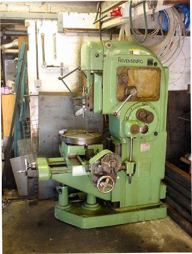

Also a good tool for the shaper . as John (i hate shapers) has just said  :thumbup: :lol: :lol:
I don't hate all shapers, only the ones made the wrong way.
This is the way they should be made  :poke:
John S.
Re: Lathe Indexing Attachment
« Reply #47 on: January 24, 2011, 05:38:43 PM »
 :lol: :lol: :lol: :lol: :lol: I ,, John ,,,,,,,,,, i was impressed with that bit of kit when i called into yours  :clap: :clap:
